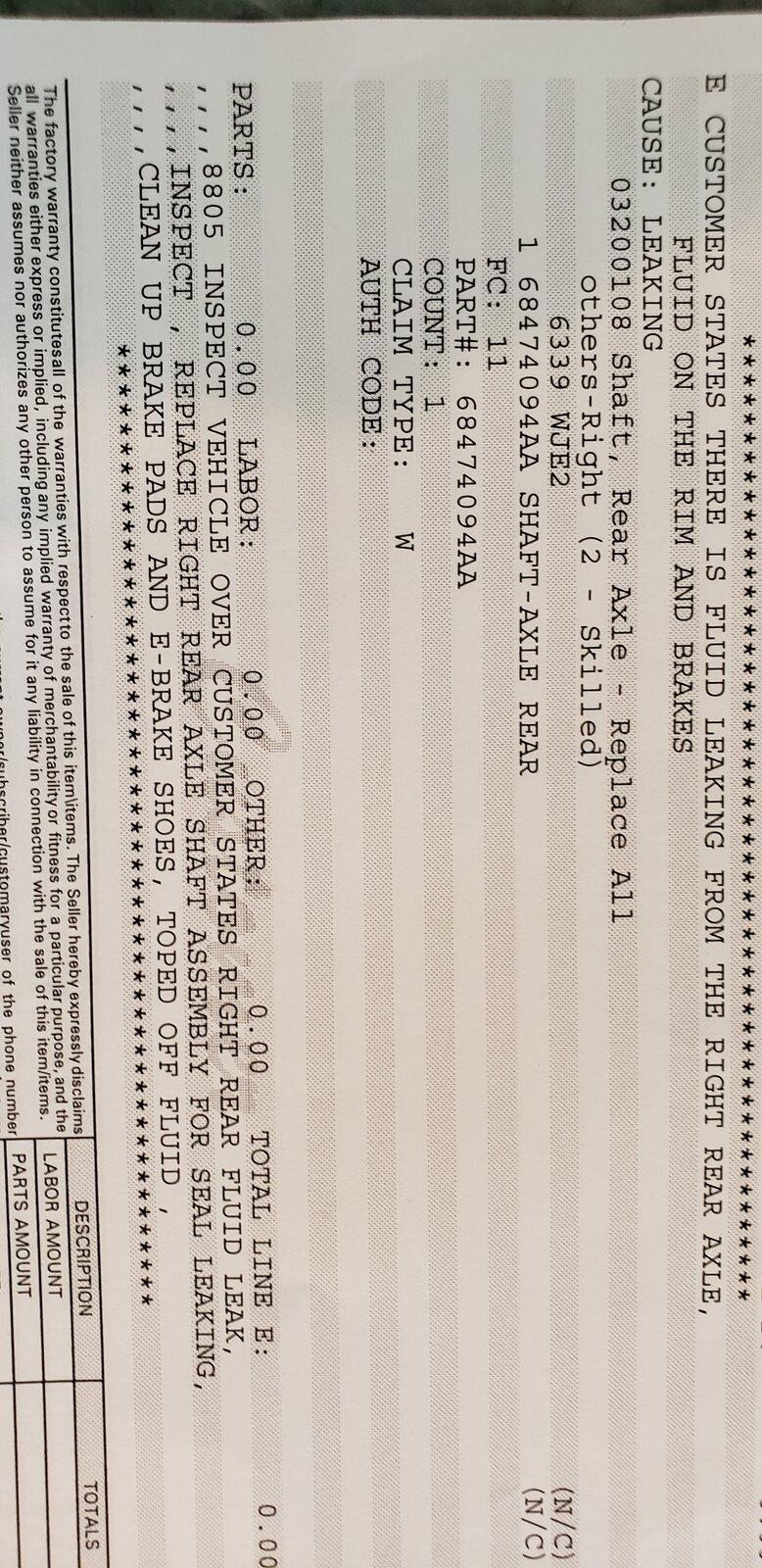

Well I got my truck back today.
"Shaft, Rear Axle - Replace All"
Jeep Gladiator Poll: All 2021 Owners Please Vote Here: Has Your RR Axle Seal Leaked? 16337122551638356692734387479769

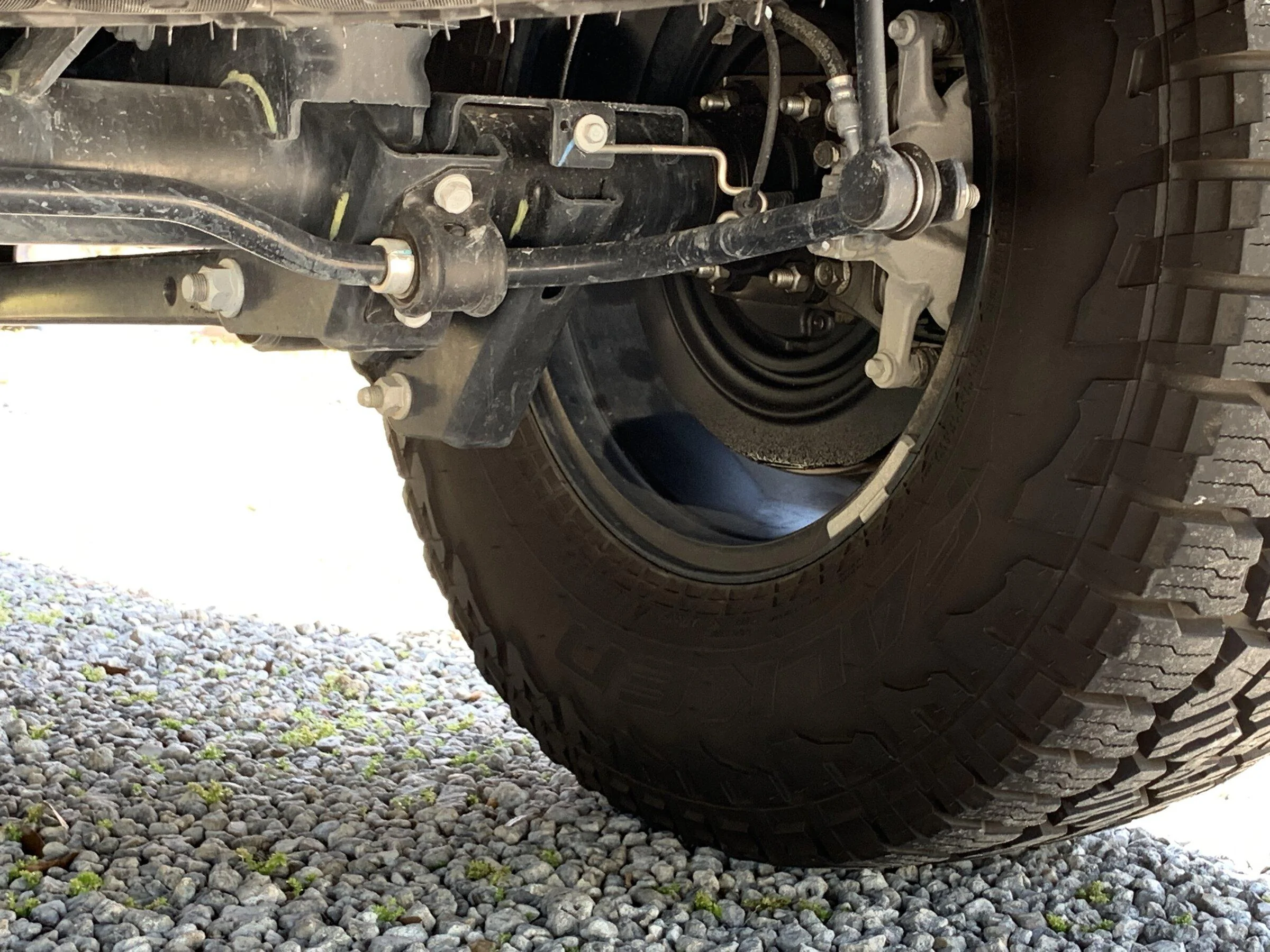

I got my 21 Mojave with 6747 miles serviced last week and noticed a weird sound like a bad belt in a tire and pulling to the right afterwards. I got underneath it today and found the RR axle seal leaking. I don’t think the pulling to the right is related to the leaking axle seal, but I’m wondering if the noise is related.
Jeep Gladiator Poll: All 2021 Owners Please Vote Here: Has Your RR Axle Seal Leaked? E3A39690-028F-4B55-9D47-5FF902221B1F
My MDH is 121307.
I spoke to the service manager because I was not happy that the tech just rotated the greasy wheel from the back and never said anything about the leak. He had me bring it right over and they immediately ordered a new RR axle shaft. It’s supposed to be here tomorrow and install on Wednesday.

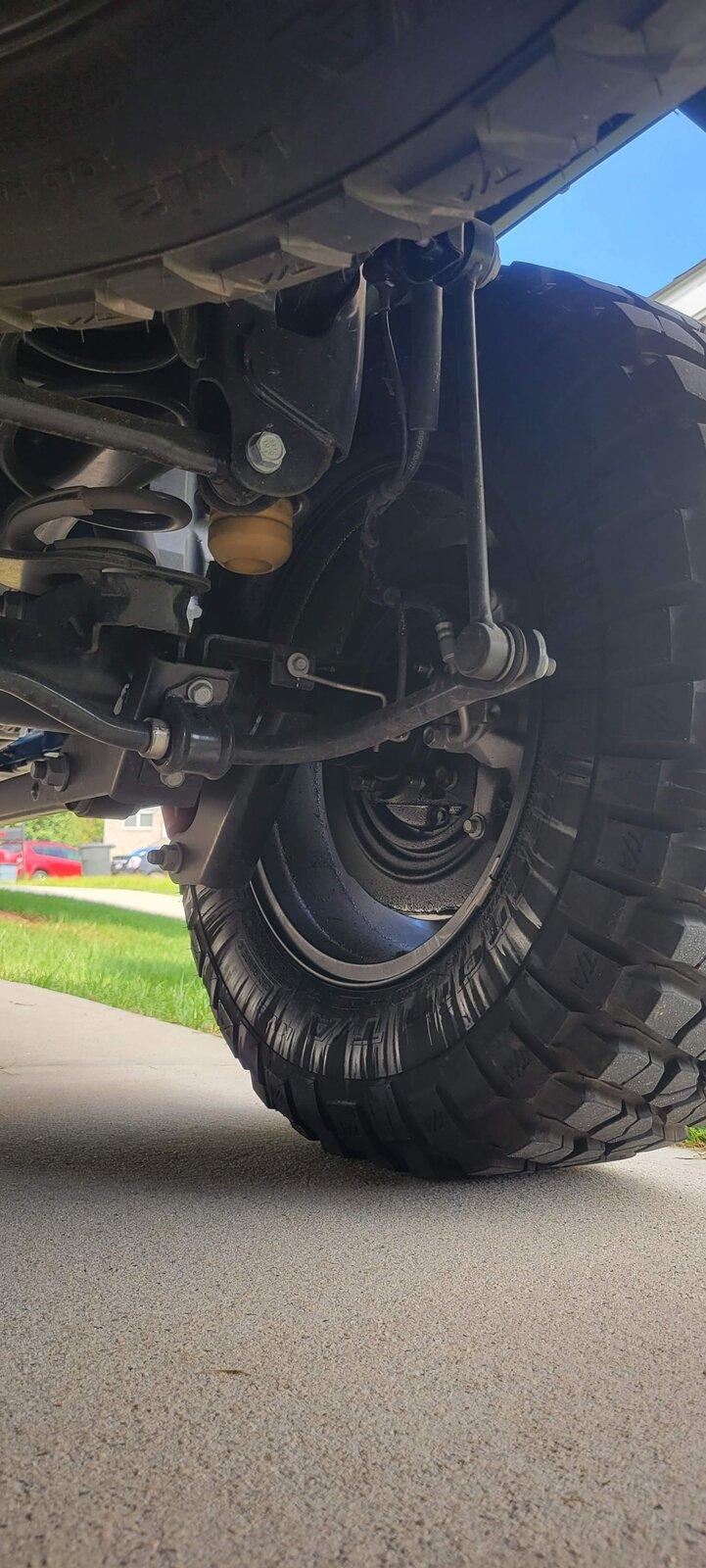

I have a 2021 Sport with 14000 miles, now leaking. Trak-loc
I'm worried about being given a difficult time because I've installed a Clayton 2 1/2" lift and 35s?
