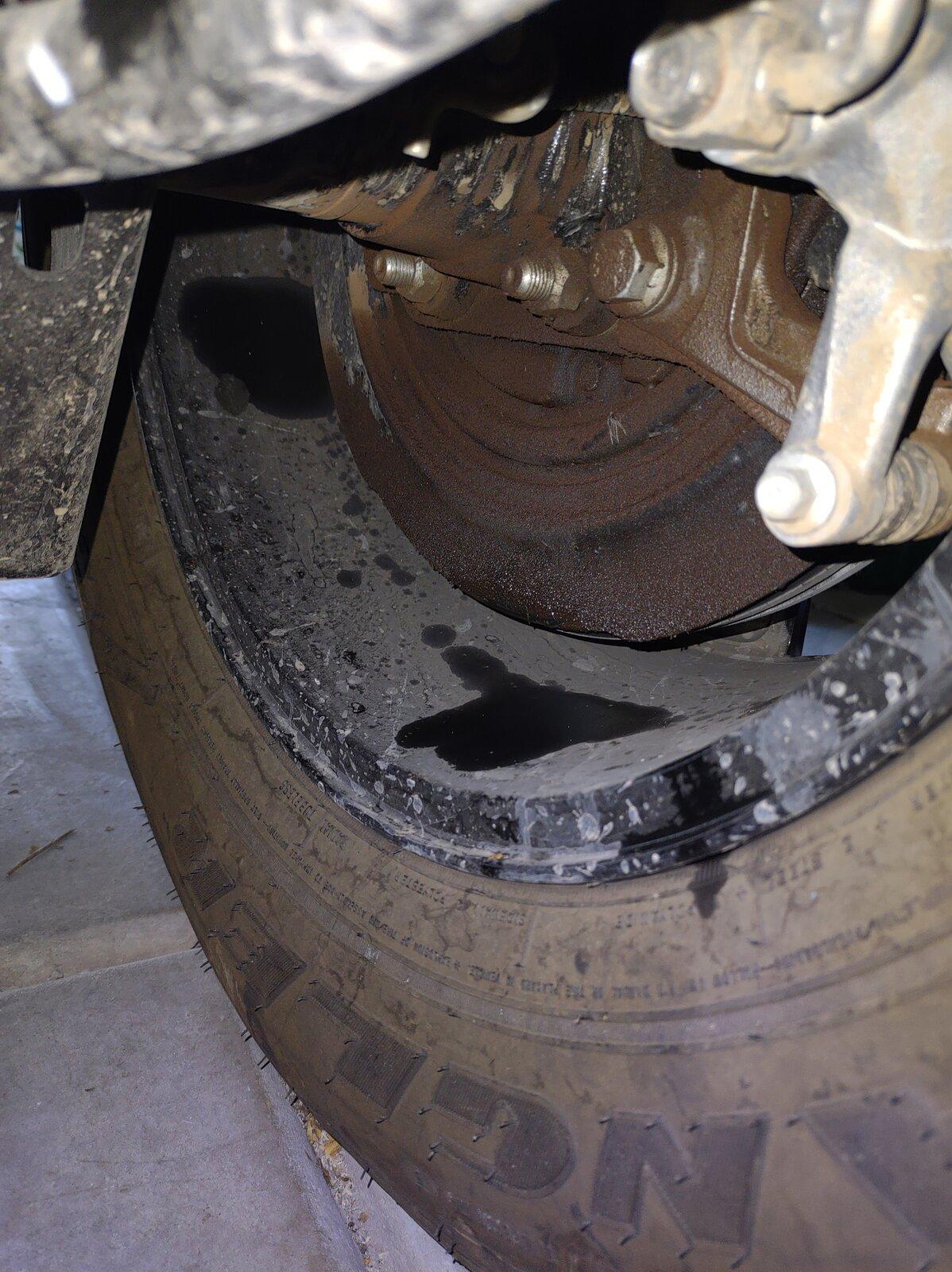

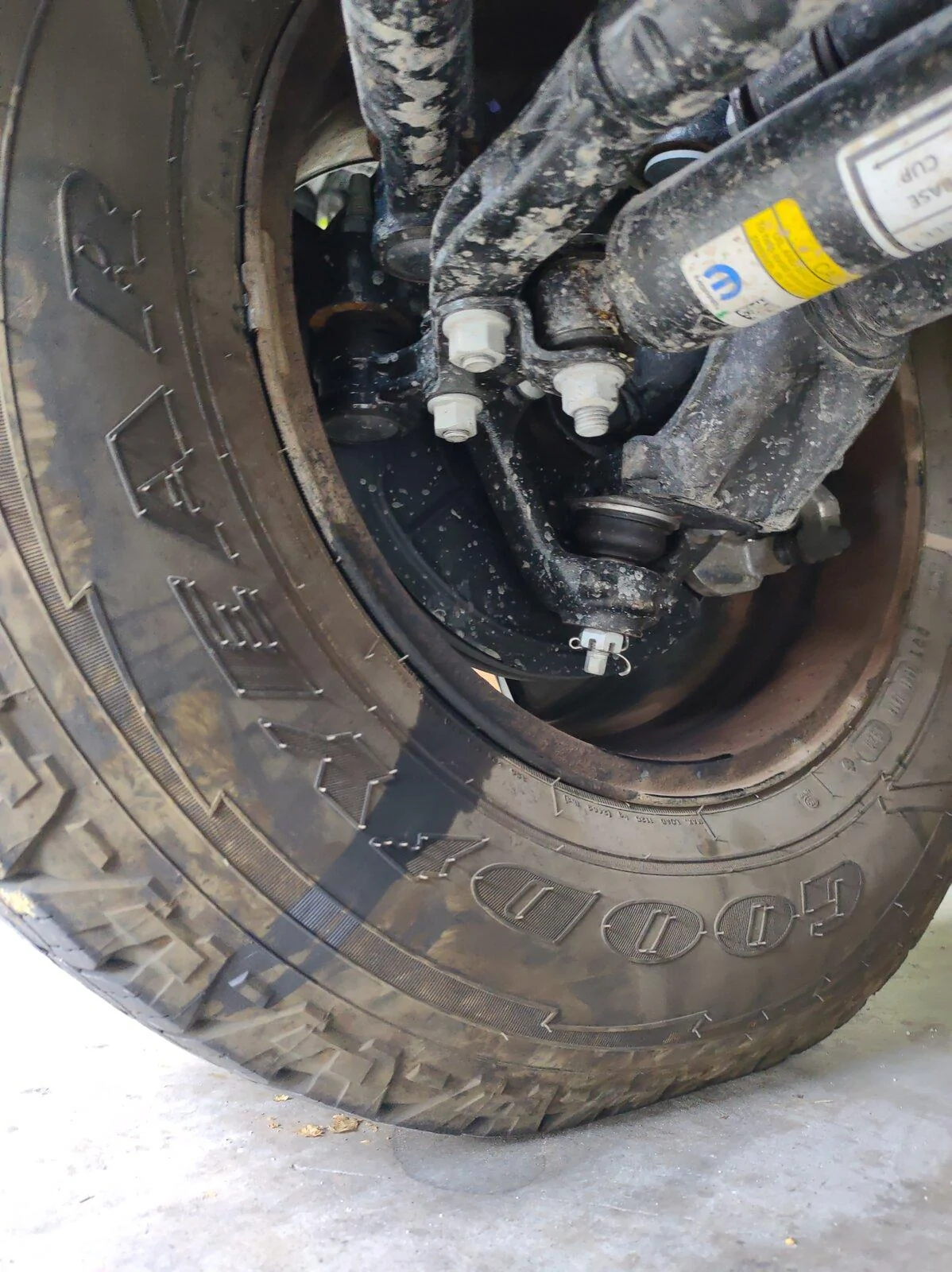

Mines leaking. Noticed after the first oil change at dealership that front right had a spot of oil. Looked at RR nothing.... waited a day...BAM oil drips
Ordered on 3/24 picked up on 4/30

Sounds like most of you guys are getting new axlss. I just took mine in and they are swapping the seal and an axle bearing.
If they don't have the parts in stock it will be a 3-4 week wait! And they do not recommend driving it as-is. They did offer to give me a loaner if they have to order parts.

I was told on yesterday that they are replacing the axle on mine. They couldnt give me a ETA what so ever, I was told there are 259 on order and that there is only 6 in the USA. I got a long term loaner until it gets fixed
Wow! I wonder why they can fix mine but everyone else in this thread has required a new axle?
Anyway good luck to all in this supply chain squeeze!
