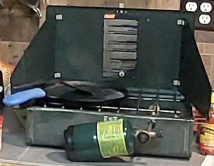

One area to possibly use less propane is to use old white gas Coleman 2 burner stove but with a propane conversion BTW: this stove can work with filtered gasoline. With mine I finally used up a 1 lb bottle, I had used it for many days doing all my pan cooking. A Jet-Boil flash or other butane stove for coffee.

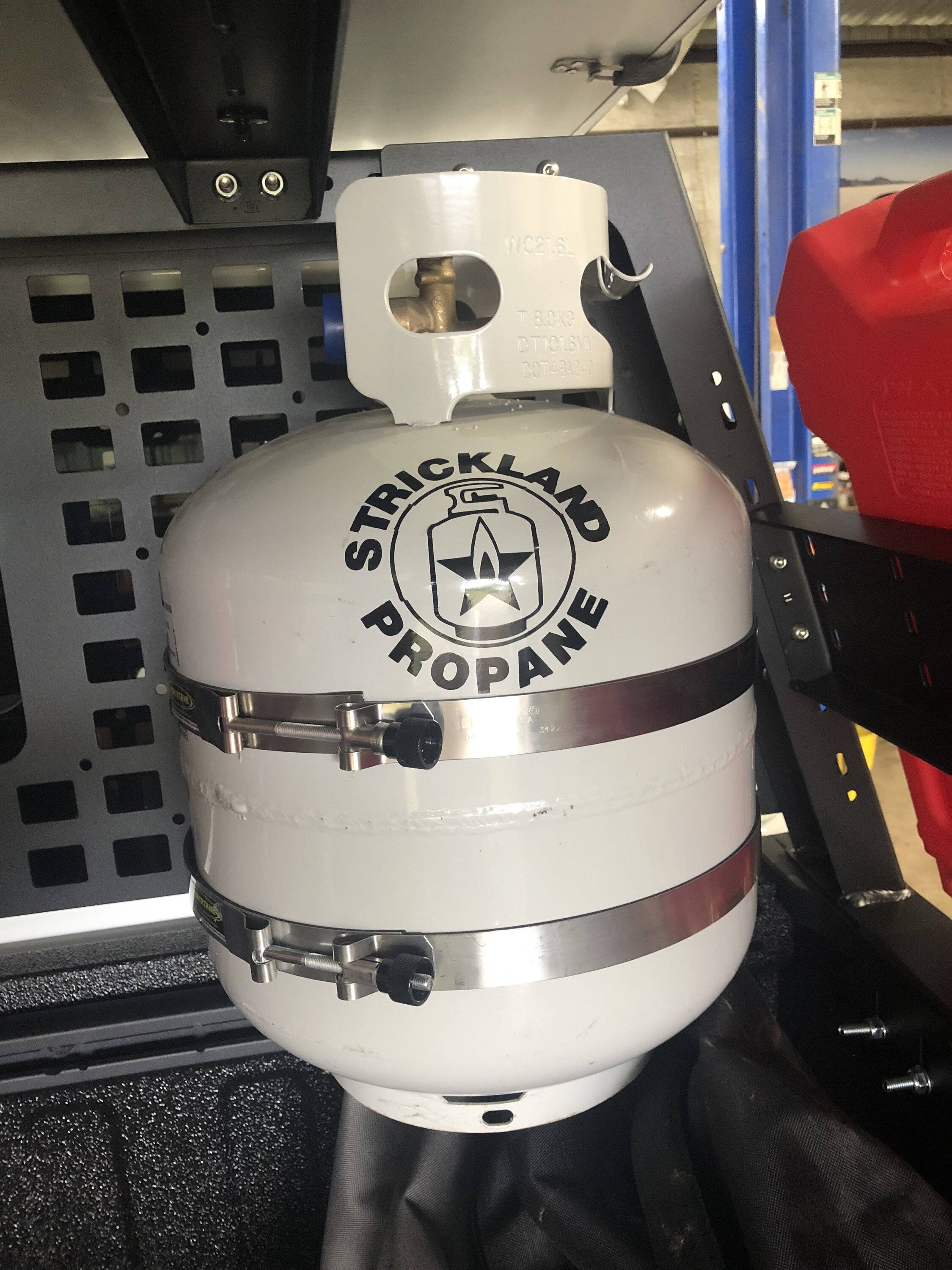

Jeep Gladiator Propane usage - expectations vs realities 20230726_032040
FYI I did have windows and doors open when I was using it.
Yeah I had a larger stove, but the jetfoil folds up and fits perfectly in the spot I have available for it. thats cool they have conversion kits for those older stoves though
