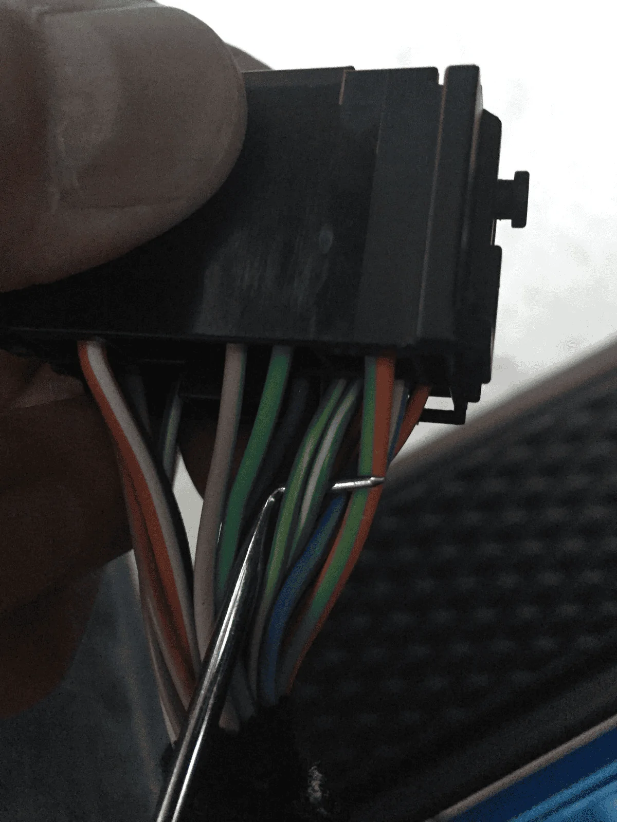

So now figuring out how to take the connection from the passenger side to the tailgate Handel...
Passenger side wire colors are green/orange and green/violet in the same location in the connector. Interesting project, keep us posted!
Jeep Gladiator Proximity door locks retrofit on Wrangler/Gladiator, someone figured it out (DIY writeup) 1603465850465
And you will trigger it, how? No magnet or sensor or switch back there.
