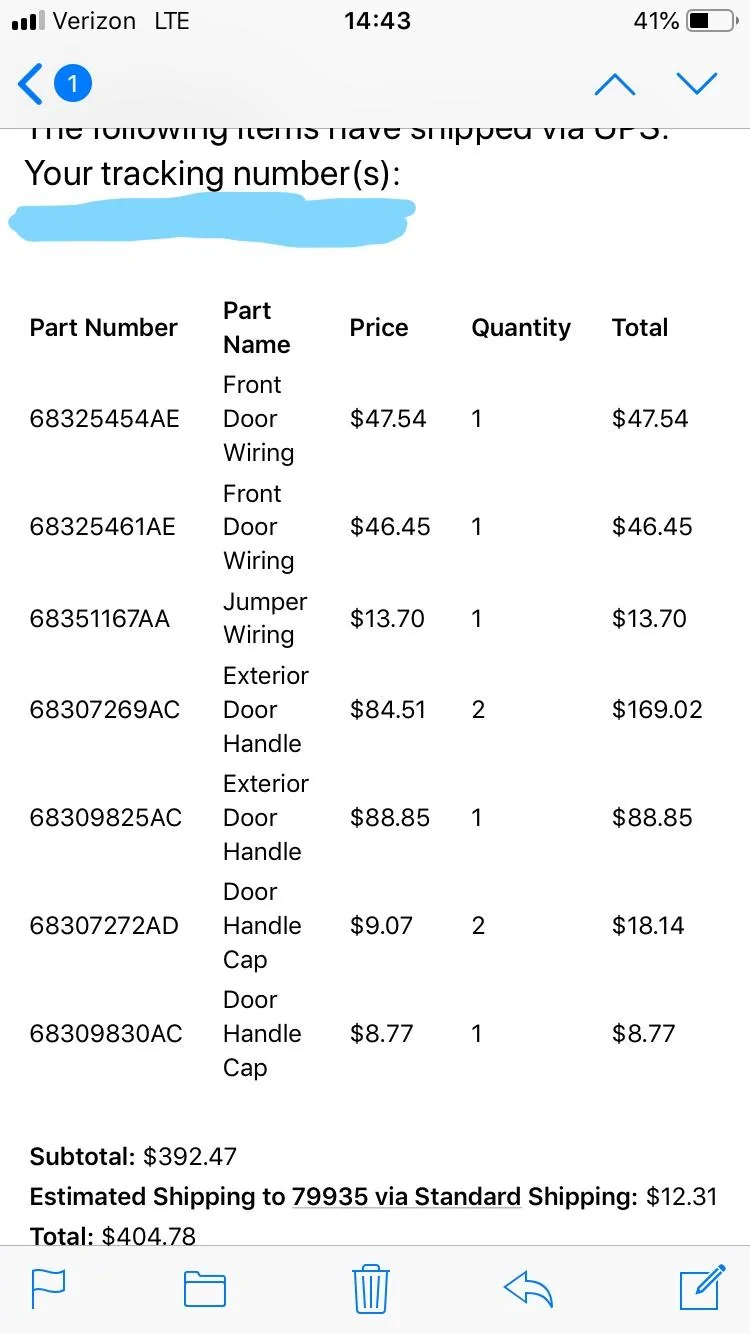

See the link in first post for part #s and prices. Going to cost +/- $500, I was assuming earlier around $1000.00 or more.

Mine was around $350. Well worth it.

So I swear I've read everything, but I might me missing something. If I've determined that I do have all the wiring locations populated, I only need the exterior handle and the VIN add/reflashing?

I did this to my wife's JL a couple days ago. It is well worth the work and parts are about $400 and a couple min. with JSCAN and it works!

Where did you purchase your parts. I assume this list is for both doors. I think I will go cheep and just do the drivers door( she never lets me drive it anyways)
