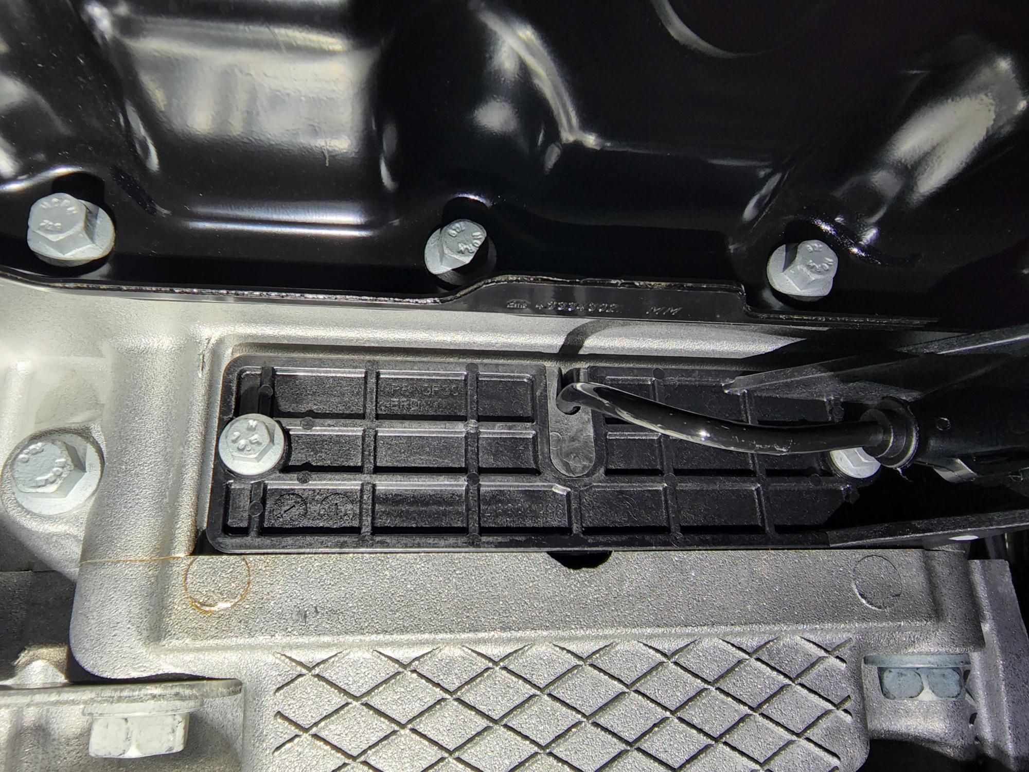

Here is my leak. It's very slow... that's how much oil is showing on the left after three days of driving after I wiped it down. It's never gotten to the point it has "dripped" yet. But I don't think these things ever get better on their own! My diesel only has 700 miles on it.

Take the black plate off and have a good look. Then spray some cleaner up there and wipe down. Then keep an eye on it.

So just to update after I wiped off the oil a few thousand miles ago from the pic two posts above. ZERO oil! So looks like it may have just been some assembly oil/lube. I was kinda leaning that way as when I felt it, it didn't feel or smell like engine oil.

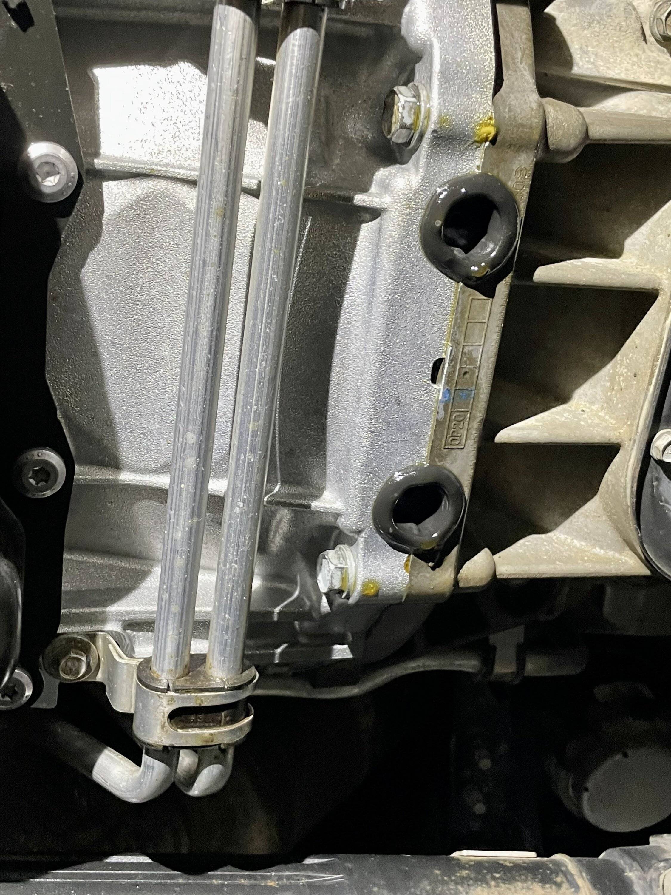

I just bought a 2020 Launch Edition with 44K miles on it in April 2023 and it's been a nightmare so far.
After months of back-and-forth with my local service shop, I just had the transmission completely replaced (under warranty) and noticed a fluid leak after I got my Gladiator back. I took it back to the shop and they said it was coming from the upper oil pan, so they kept it over the weekend while they dropped the pan and replaced the gasket. The leak continued after I got it back, so I took it in again and they said there was a crack in the dipstick tube, so they replaced that. I got it back again and found the leak persisting, so I took it in a 3rd time for the same issue. This time, they claim the rear main seal needs to be replaced, so they either need to pull the engine or the transmission to replace it.

While I LOVE my Gladiator, I hate that my first experiences have been nothing but problems. I contacted @JeepCares for the transmission issues, but it feels like they're just an outsourced call center in India, and not an actual FCA entity.
