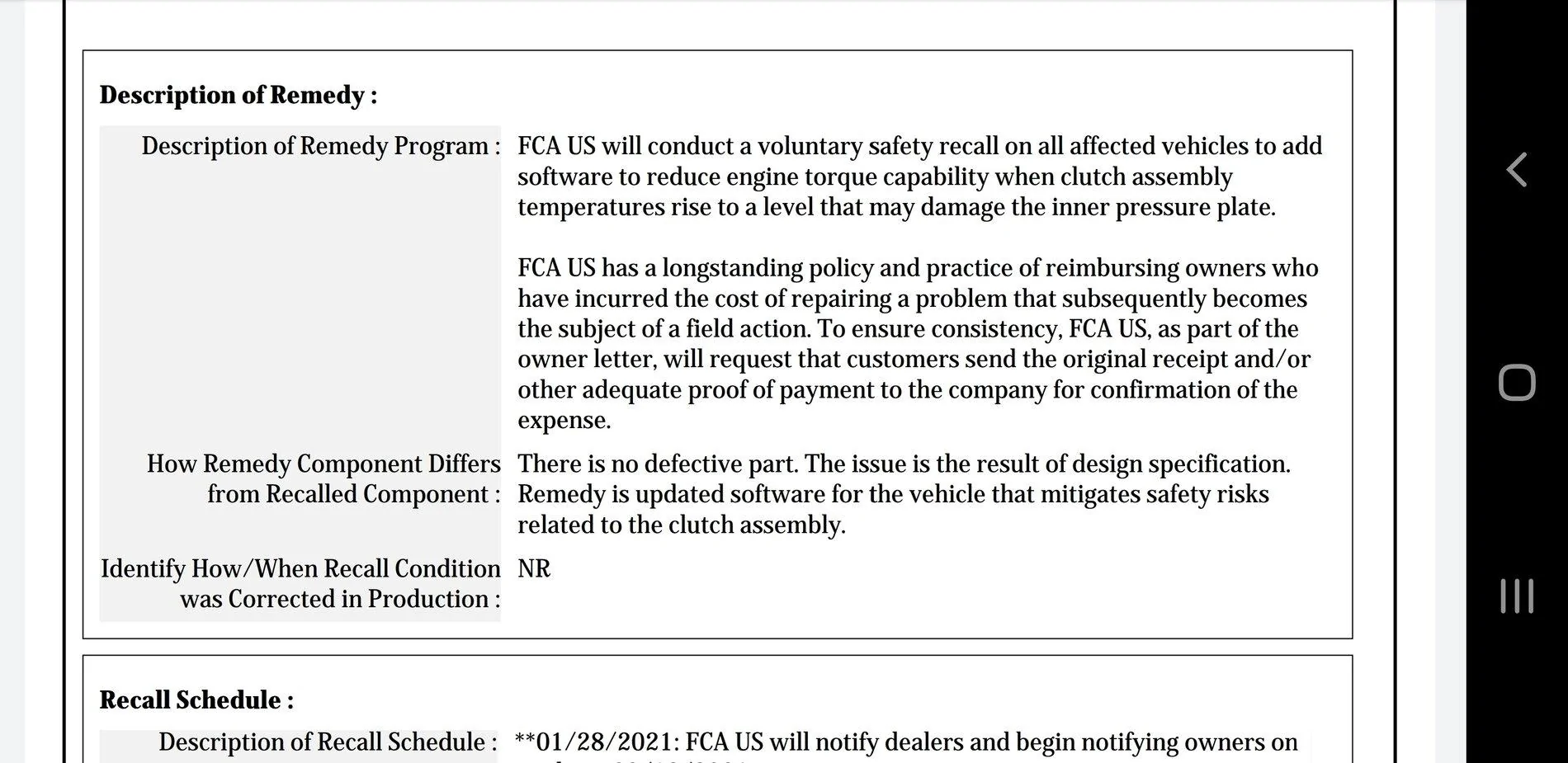

I've seen nothing from any source to indicate that a reprogram was a part of the solution. I think that's just rumor.
From page 4 of link
Part 573 Safety Recall Report 21V-028 Page 4
The information contained in this report was submitted pursuant to 49 CFR §573
Description of Remedy :
Description of Remedy Program : FCA US will conduct a voluntary safety recall on all affected vehicles to add software to reduce engine torque capability when clutch assembly temperatures rise to a level that may damage the inner pressure plate.
https://static.nhtsa.gov/odi/rcl/2021/RCLRPT-21V028-2204.PDF
If the solution was bleeding the slave cylinder then why not just state it?

Why would the legal Document from FCA say something totally different? Can you source your claims or is this purely hear say? No disrespect, but I just ordered a manual JT and am genuinely curious what reality is.
I found a totally DIFFERENT clutch bulletin that talks about bleeding - that's not related to this one mentioned in the first post at all.
What DanW typed is almost word-for-word from the OTHER clutch bulletin - he typed FCA info.
So we're talking two different things here. Both are clutch heating issues, but the test he indicated and the bubbles are from a different bulletin. It's from April 2020 and covers only 2020 Gladiator and 18-20 Wrangler.
So the info DanW posted DOES come from FCA - but it's not the same bulletin we were talking about originally.
DanW quoting from an older bulletin (recall 20V-124) not the one red/green is quoting.

Sorry, you are quoting a much older bulletin. It's not the same one.
The OP posted a NEWER one from this year,
you posted quotes from an April 2020 recall paper, 9 months old. I found the paper you quoted from you posted info from FCA almost word for word from April.
So apples and oranges.
One relates to the master cylinder, etc. - the other is indeed a programming thing.
Again - you are talking a very different bulletin than the OP of this thread is referring to.

Feel free to delete if already posted, but I just got this alert on my GasBuddy app regarding a Overheated Clutch Recall.
For those with manual transmission, BOLO!
Jeff can you edit the title to include something like "2nd All New Jan 21, 2028". The reason is I assumed it was you just now being aware of first recall.

How exactly are they gonna know the clutch temperature? I guess add a sensor? Plus if I'm heating up the clutch on purpose I'm trying to do something I need the extra torque for. Man I was so close to getting a manual but the first recall made me wary. But I think yall that have them need to start a class action now.
Edit: Link to new recall Check for Recalls: Vehicle, Car Seat, Tire, Equipment | NHTSA
Edit 2: the above screenshot is from the pdf imbedded in above link RCLRPT-21V028-2204.PDF (nhtsa.gov)
Ok, thanks for posting this.
Looks like there must be a temp sensor. Did not know that.
I don't think you can generate that kind of heat with one or two starts. You'd have to really cook that thing. One symptom is smelling a burning clutch during normal driving. Not just isolated situations.
