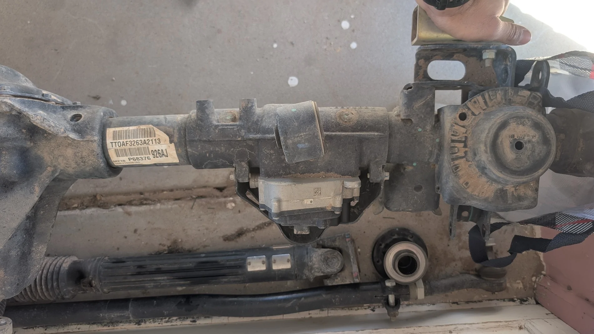

They are definitely not as strong as people believe. I would truss the front axle right away if you plan any off-road. There is a reason Jeep added that passenger crash bracket on the right side. The front axle breaks and bends at the FAD in crashes, unlike the old dana 44 on the jk's. Maybe that is what the shop is referring to?
Crate axles aren't a bad option if you are going to dump $5k+ (reid knuckles, chromoly axle shafts, regear, locker if you need it, truss, stronger ball joints, etc) into a weak axle, you might as well get the 9inch 5 lug axles from lm1 in Arizona.

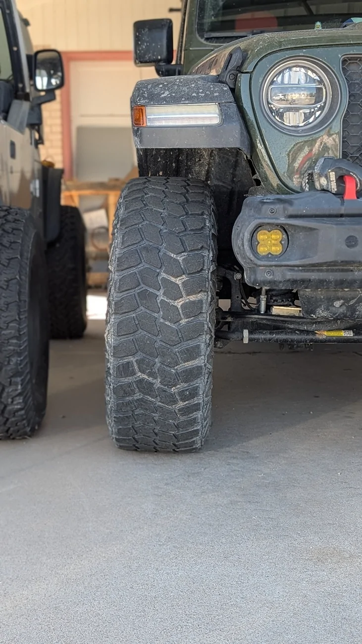

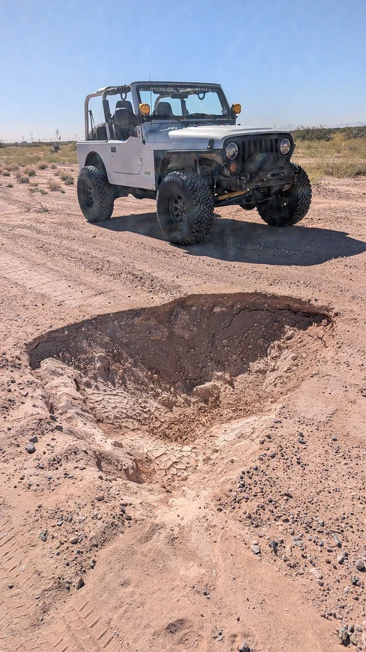

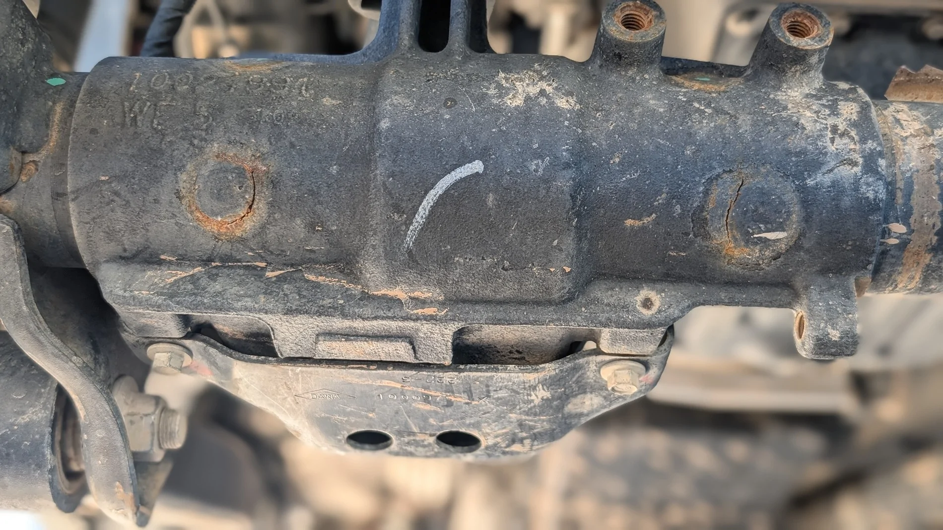

I hit a sinkhole with my front axle on 37s and it bent the front enough for me to notice when walking up to the Jeep and it also bent the axle back which I just noticed the other day.

You can see how it is bent towards the rear of the jeep in this picture.
At what speed? Hitting a hole like that is going to cause damage so it may not be the best example.

It was less than 25mph, nothing crazy. I was taking it easy because it was after dark, raining and I was just putting along after testing out some changes I made to my ar22.
I definitely was not bombing down the desert at high speed, but I still hit the bump stops hard enough to bend the axle.
This also caused the plastic in the fad to break, disabling my front axle from locking.
