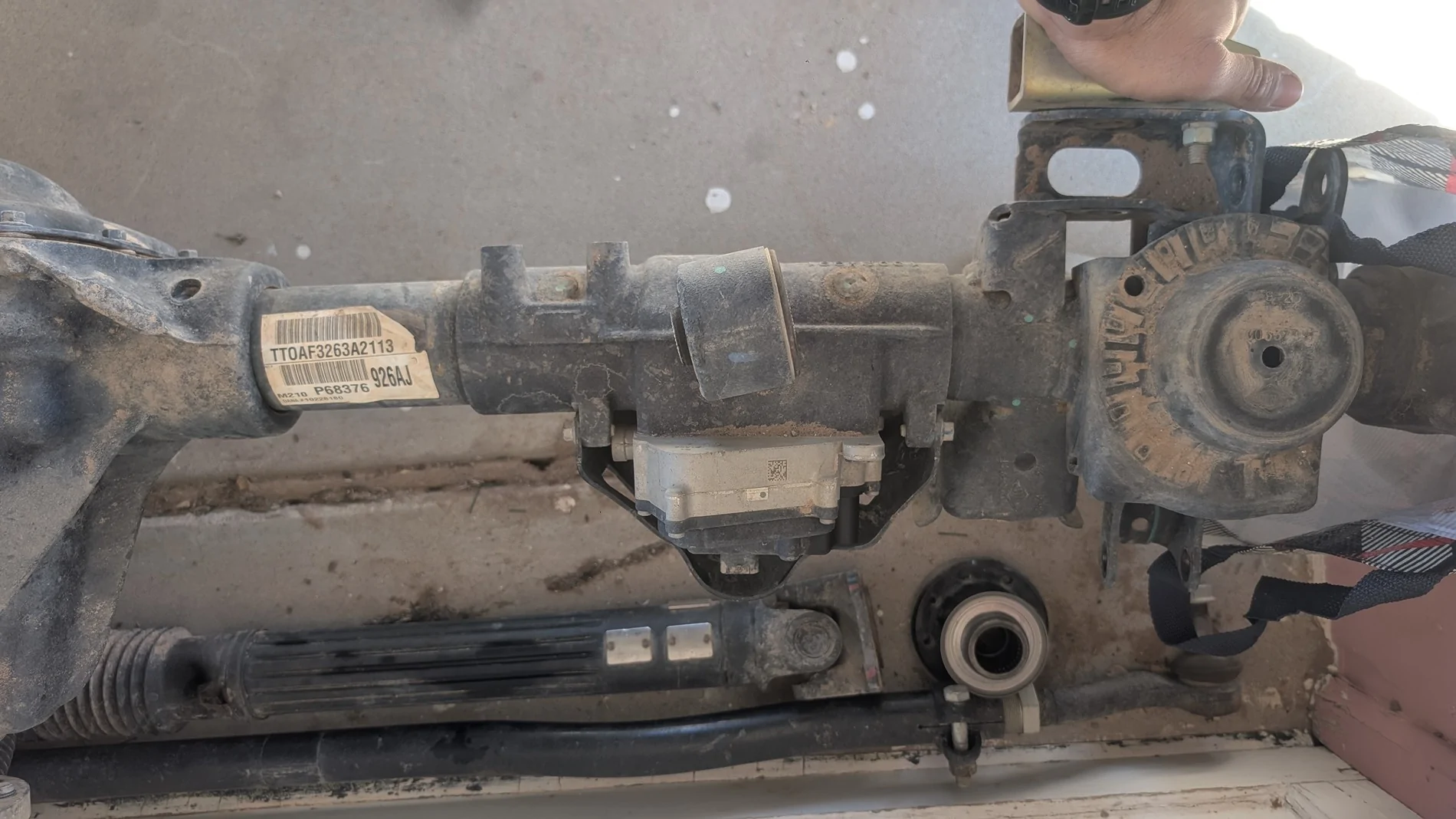

The JL axles are stronger than the JK axles for sure, but you should probably still truss them asap if you run 37s and wheel it hard (or if hit a huge sink hole like I did).
I barely noticed how far back the front axle moved when it bent at the FAD.
