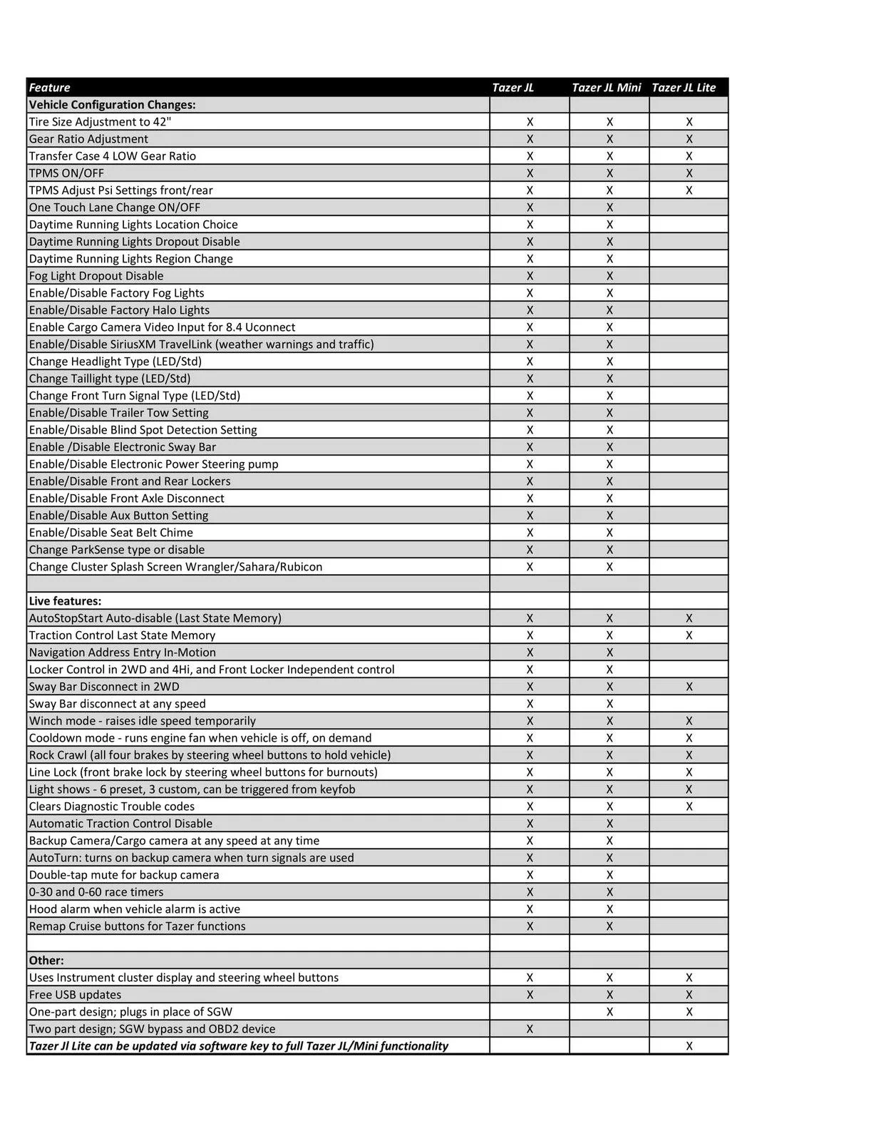

Does the tazer definitely disable it? the tazer is on my ever growing list.
I can not quote for fact though every thing iv read it does

I have the tazer and do not see where it has a setting for auto park and in all the lit I've read it is not mentioned.
Nothing on this list indicates auto park disable.

Lightly riding the brakes with your left foot will disable AutoPark. You will not need to fasten the seatbelt behind your back or use a dummy buckle. This is the best and easiest solution for me when I want to disable AutoPark. The Tazer cannot disable AutoPark.

Tazer does not have the ability at this time to correct this.
