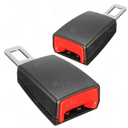

This solves the problem. I never unbuckle it from the truck. I bought these when I had my Ram because it was the same way, the wife's Durango too. I'll never get rid of them.
thanks for sharing that should work great.
Does someone have a link for these?

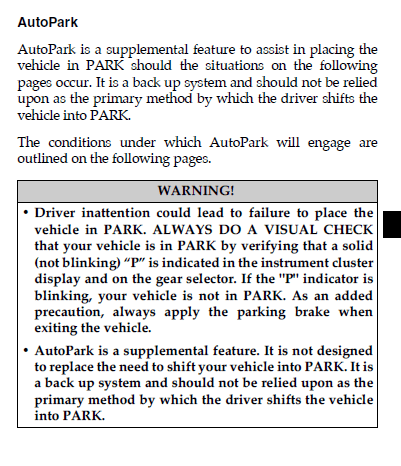

RIPLER
Jan 31, 2019
278
382
Pittsburgh
2020 JTR, 2020 JLU, 2015 Jeep Renegade
I'm pretty sure it isn't slamming into park. It felt like it applied the brakes.
I'm pretty sure it gets put in park, when mine did it the truck moved back and forth a bit after it stopping which leads me to believe the brakes weren't applied.

I'll be buying those seatbelts insert .

The AutoPark feature is the single most maddening feature FCA ever put on a vehicle. It pissed me off for two years after I got my JL and then moved into the JT. I was starting to cool off, and then you guys had to make another thread about it. Some moron didn't put their GRAND CHEROKEE in park and rolled over themselves, so that means EVERY FCA VEHICLE needs AutoPark? Excuse me, I thought this was the USA, not North Korea.
Anyhow, Tazer will only disable this feature IF you have a 2018 JL or JLU that still has the first release of the vehicle software loaded to the onboard computers. If you get your vehicle flashed with updates at the dealership, Tazer will no longer be able to disable AutoPark. To my knowledge, it also will not work on JT because JT got the updated software from the get-go.
Those seat belt plug-ins above are genius ^^^ Can you provide a link please?
