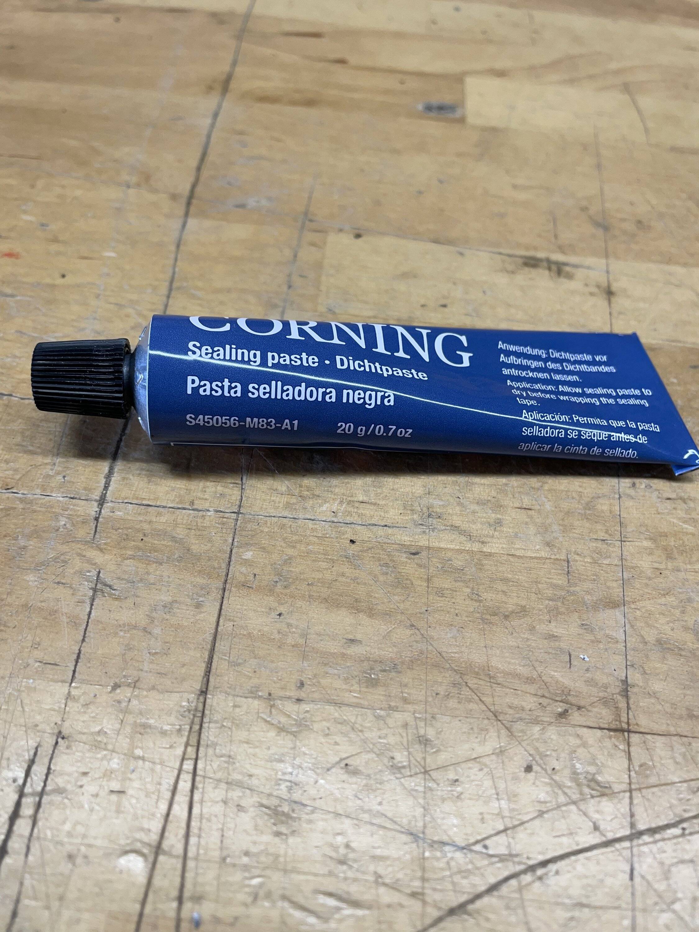

I fixed mine today using Corning liquid sealing paste. Injected into the gap with a syringe.
Do you have a part number or product number for the "Corning liquid sealing paste"?
Here's a photo of the paste.
The viscosity and dried up texture are very similar to electrical liquid tape. I used a syringe with a curve tip.
I didn't wanted to jam anything between the glass and the top.
Looks closely in the gap and you will see that, there's a factory black primer coating on the fiberglass hardtop side. That's what separated on mine, right above center of the sliding window.
