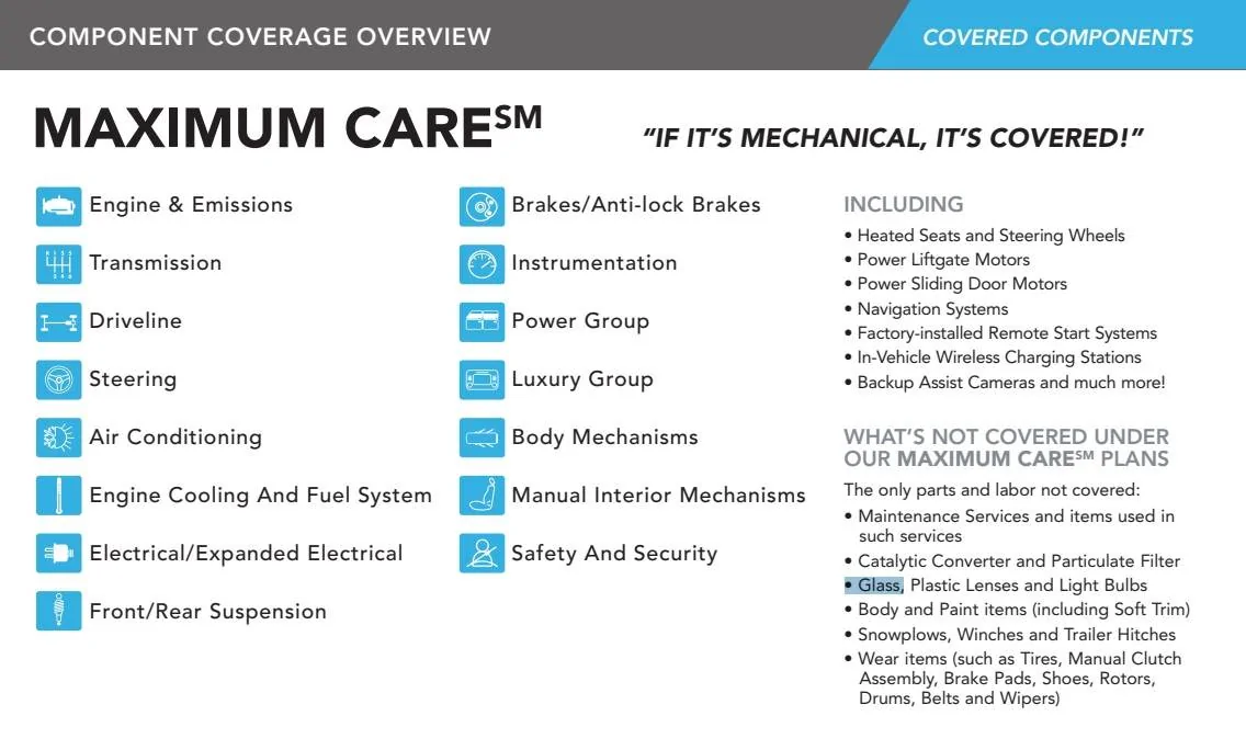

@JeepCares I noticed today that water is coming through my rear window.
As much as I am sure the preceding 50-pages of this thread may answer it—will this be covered by my Mopar Extended Warranty now that I am outside of my 3-year warranty?
I would say no it is not covered if it falls under their listed exemption "glass". I would double check that against any copy of terms and conditions that should have been given to you when you bought the plan.

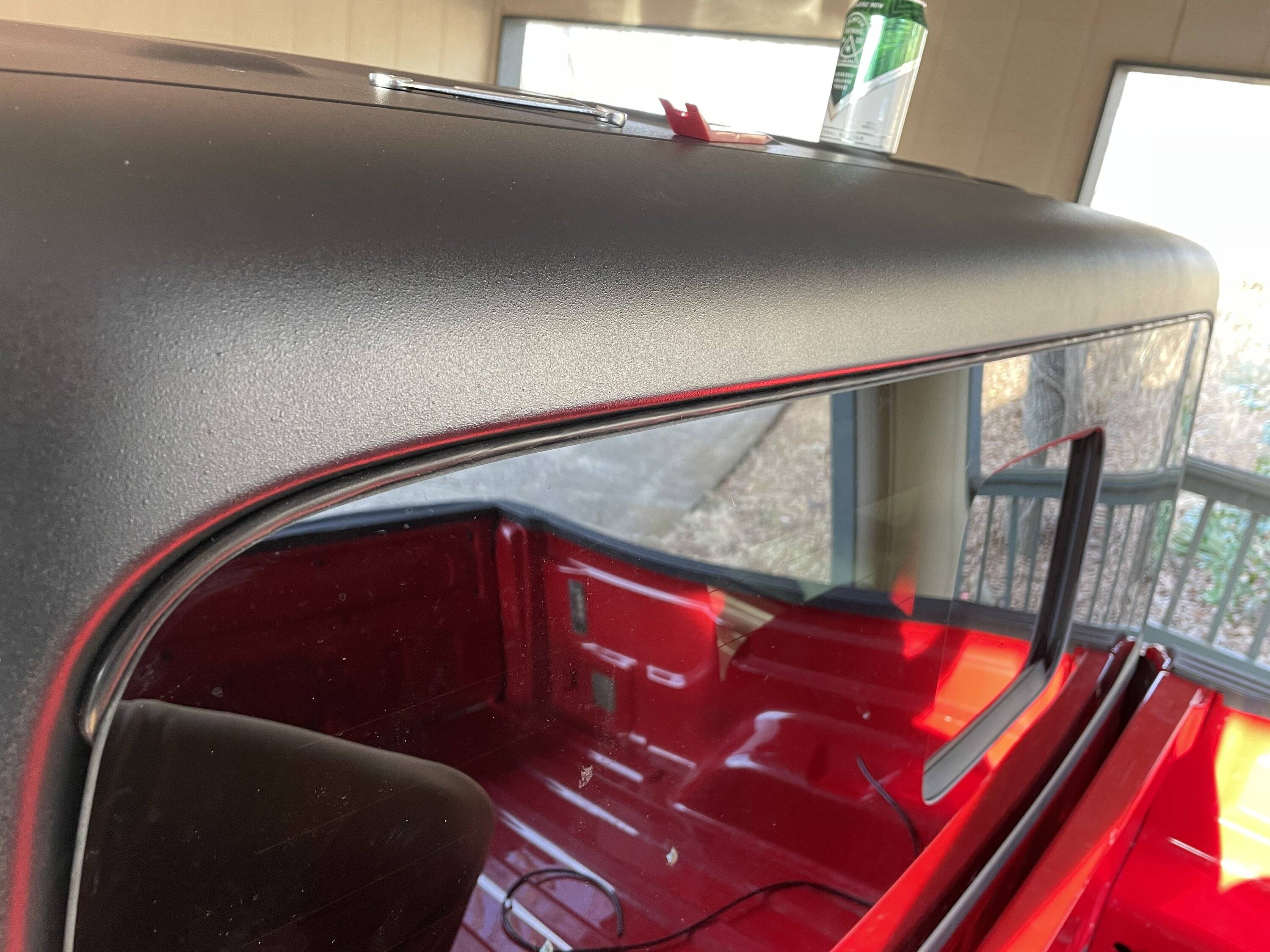

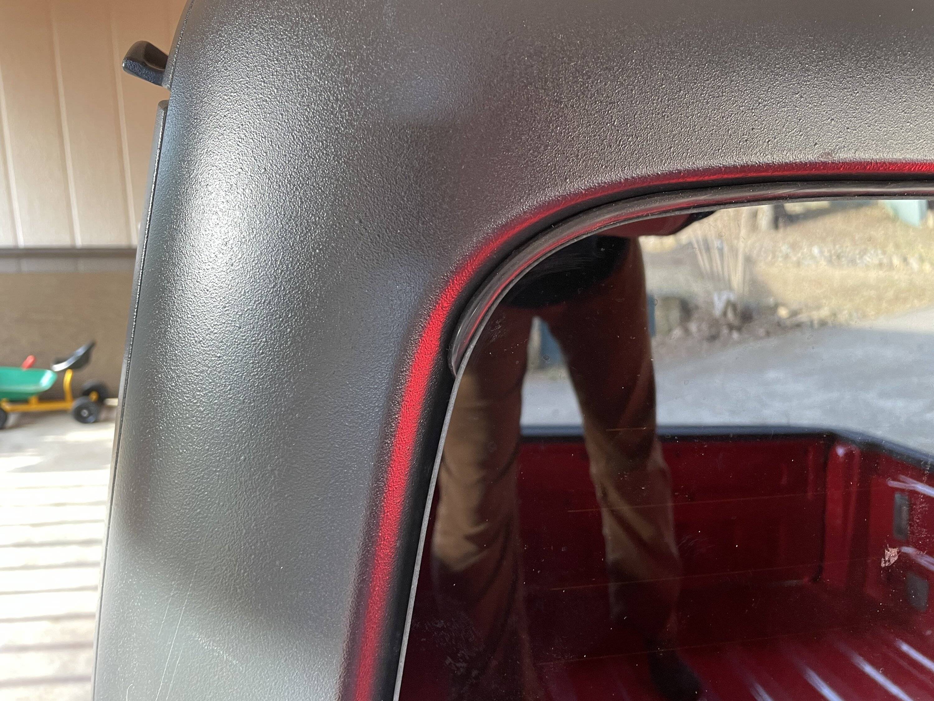

I went the vacuum hose route. Took me 30 mins. It’s supposed to rain tomorrow so I’ll report back.
