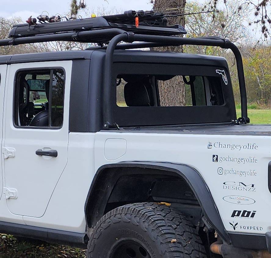

Y'all just get rid of the factory glass and install a one piece removable. Mine wasn't even leaking, I just didn't like that small a$$ window.

Neat. How does it seal? Link ?
There is a rubber boot on the inside. The window fits on the inside in a tray and clamps at the top. It seals great. The rubber boot is really thick and the glass fits tight up against it. the company sells two surrounds. The one like I have (I got it to match the top) and the transparent frame that looks similar to a full glass like factory.
Apparently the company has been around for over a decade, but they came out with a version for the Gladiator last year. I had only seed a few with it, so I decided to take a chance. Had no idea how it would turn out. Now I'm glad I did.
Here's a link to the website: https://breezerwindows.com/

Did you remove your window or pay a "pro" to do it? Thanks for the link!

Oh heck no! Hahaha! I thought about removing it myself, but I've seen too many horror stories about them broken on removable. I paid a local glass shop here. Even the tech said that most of the time they get broken. He told me beforehand that he can't guarantee that it won't get broken. But they got it out with no issues.
You're welcome! It's not for everybody and I took a chance not knowing the outcome. But taking a chance worked this time. Lol
