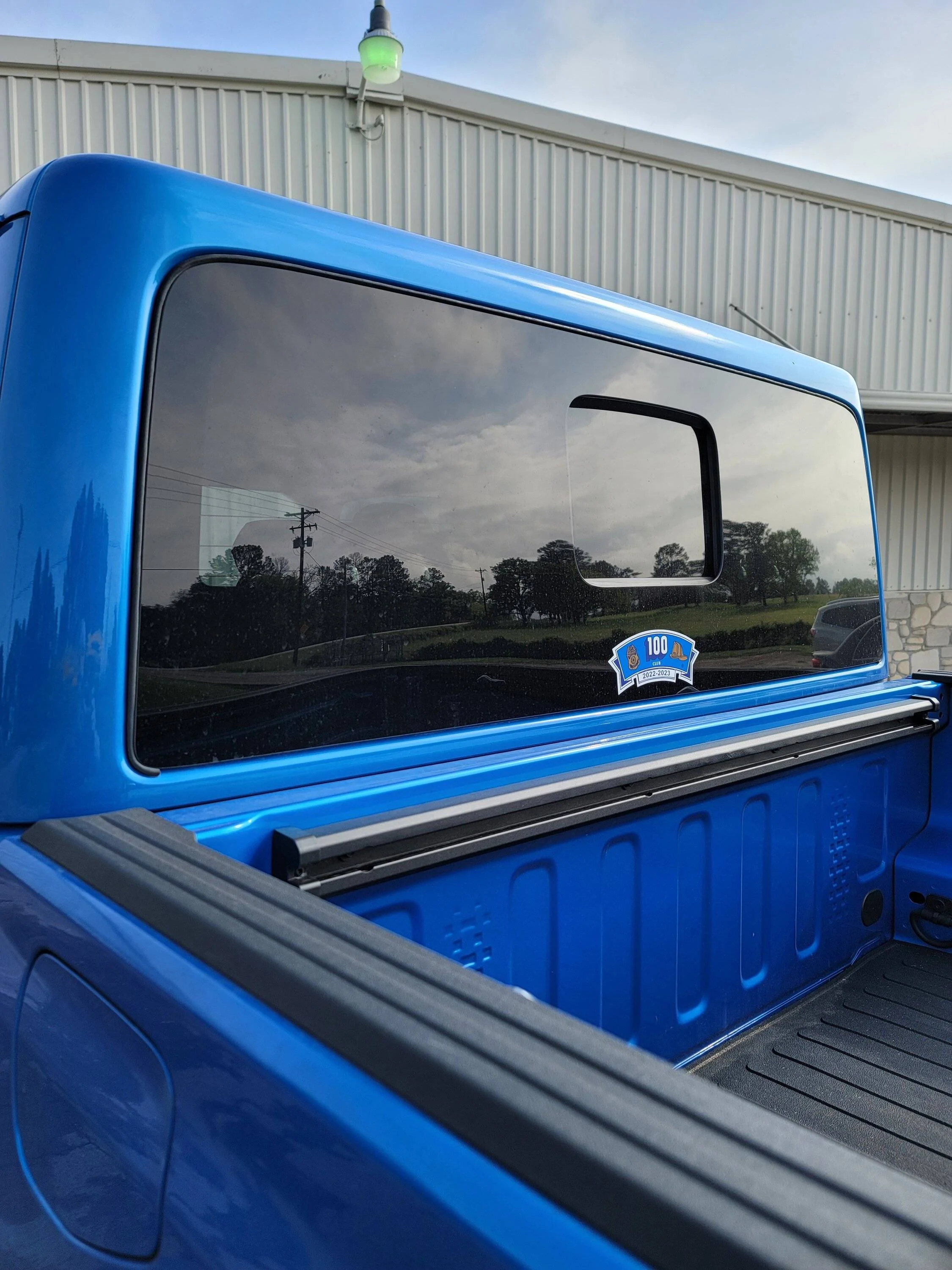

Another option for replacement if you don't want to roll the dice on a Mopar replacement just failing again...
That looks really cool, but in the North East, I really need a rear defrost.
