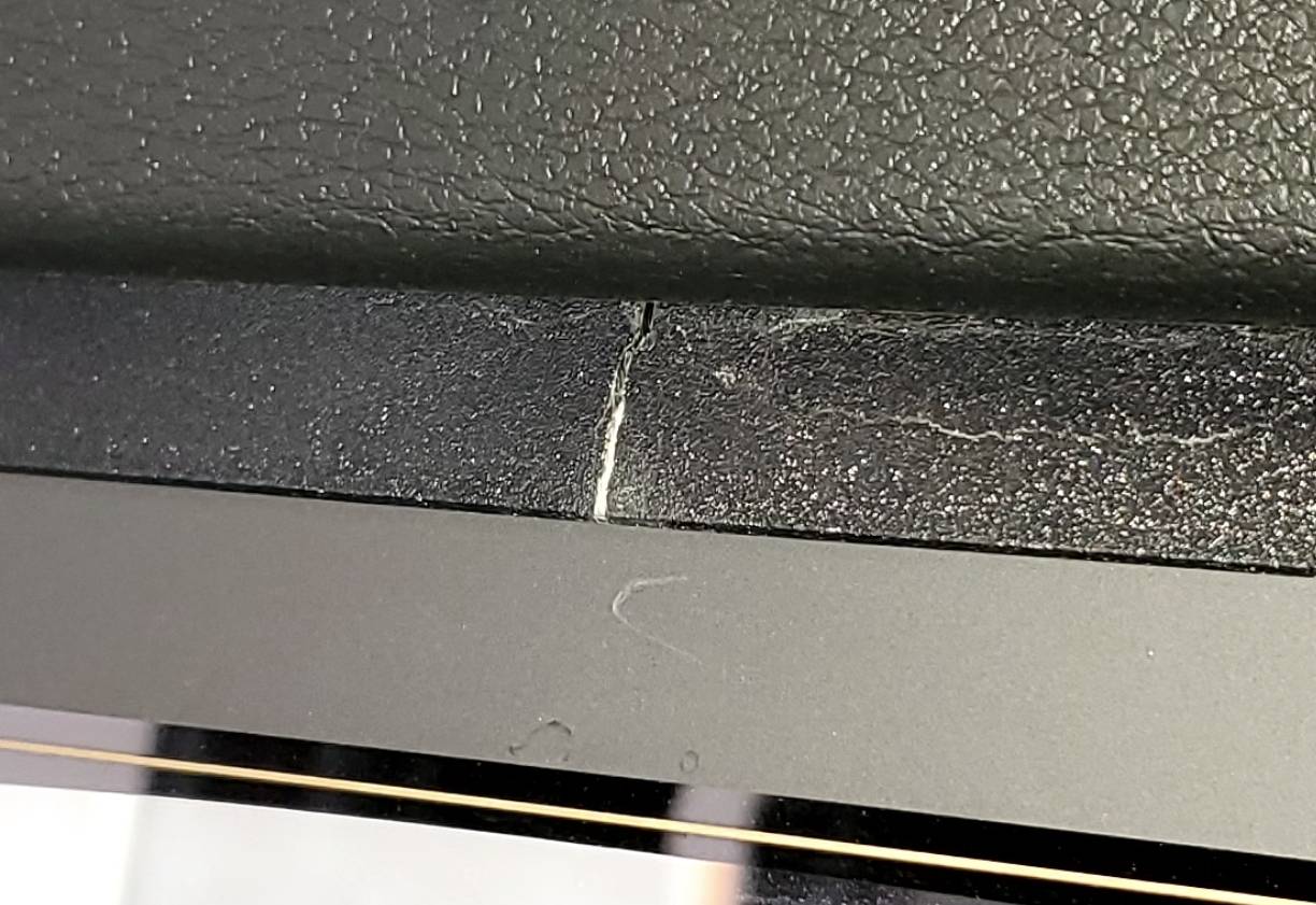

I've got beyond hairline cracks. 4 of them. Total separation. No leaks after installing the hose. It doesn't matter if there are cracks. If the hose seals against the hardtop and against the glass = it can't leak. It bridges the gap. It is physically impossible to leak if the glass is sealed against the hardtop via the hose.
If yours leaked after installing the hose, you didn't get it right and had a gap somewhere.

Pulled my upper trim off today (note, missing a few clips and one broken tab, guessing from prior repair as it was loose when I grabbed it). Pretty sure I have a crack pretty much dead center in the top of the window frame. Looks just like a molding line, but that is where the water stains are, so pretty sure that’s the problem spot. Noticed the carpet and back seat smell musty as well. Thanks Jeep for fixing this last year. F’in joke!
