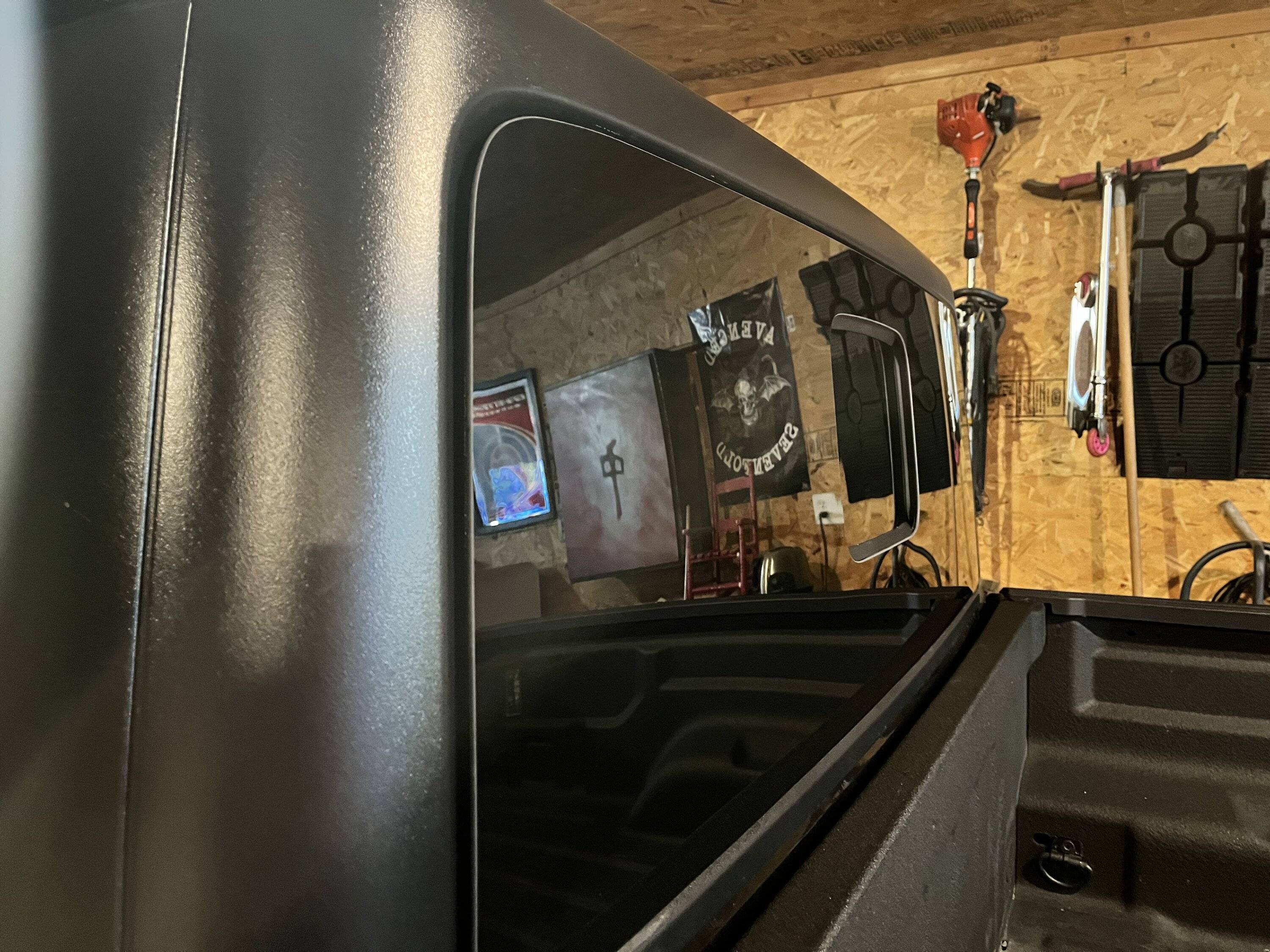

I squirted about 1/2 tube of GE RTV (black) in the gap around the top and sides of the window. So far, so good. It's been in there 2-3 months now.

my 2020 is leaking. I thought i had noticed it a long time ago and reported it to the dealership a while back who was supposed to contact me back. I didnt notice it anymore and forgot about it all. Now its been raining a couple days and ive been driving in it, and yep water dripping every few mins. I got back there with my phone light and looked. There are several small cracks in the trim around the window in the hard plastic looking stuff. Is that what is causing it??

Yes, that plastic track on the inside of the window routes the water to drain. My guess (design engineer here) is since the plastic is attached to the window and they expand at different amounts with heat cycles it cracks the plastic at various spots along its length. I don't believe it's been redesigned yet by MOPAR engineers, so replacing the window assembly is just starting a new timer til failure again.

Yep, seems to be most common in climates that freeze. My 2 frames that broke appeared to start leaking during the cold of winter.
