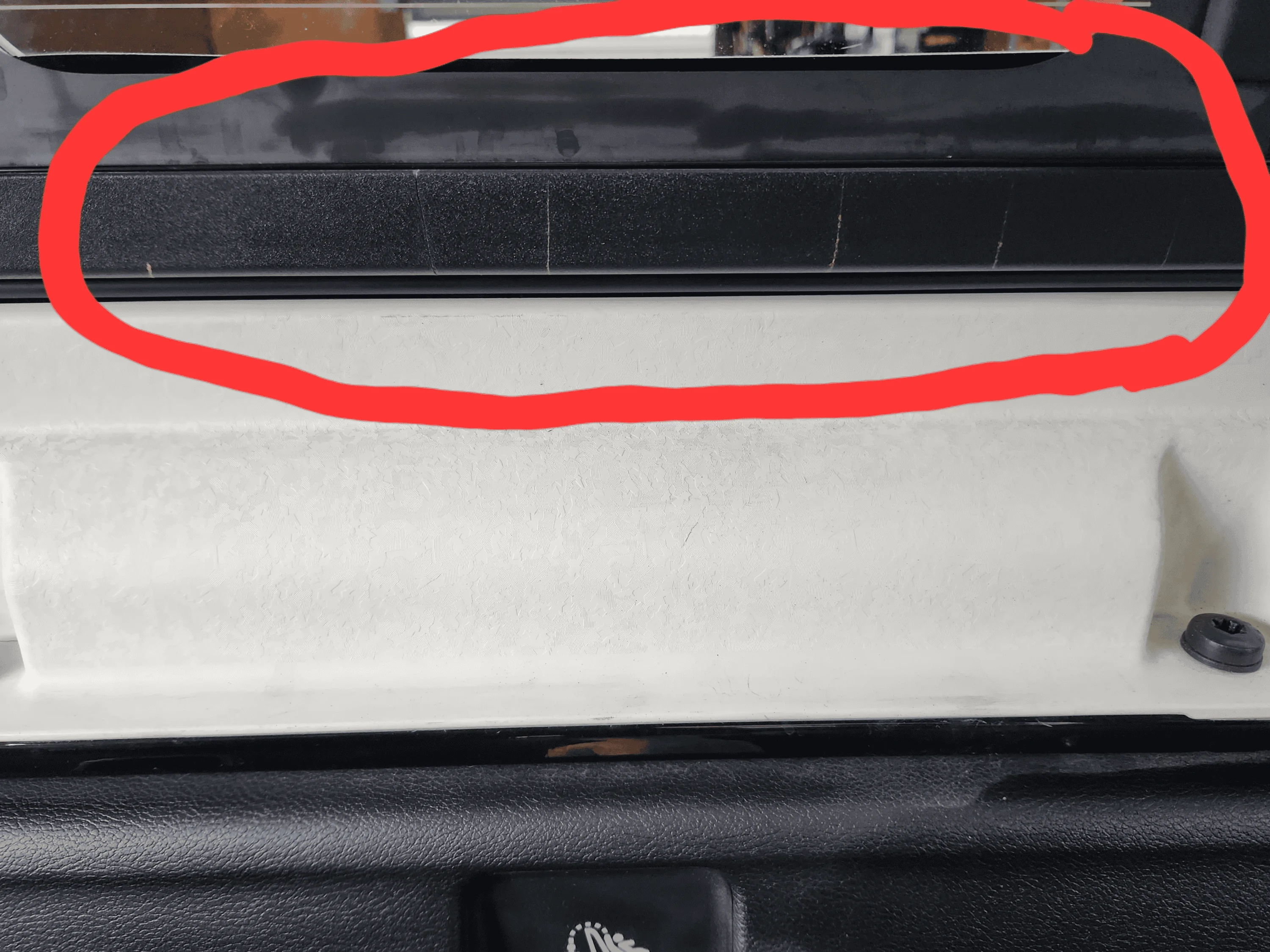

So I decided to try the permatex flowable silicone... we've had a few storms since, so far, dry as can be....
But... while cleaning my interior out, I noticed what I thought were dirt streaks below the sliding rear window! Found they were cracks!
My thoughts are that water got in there and froze over the winter (south central Pa.) Causing it to crack at some point. Related to the leak at the top, maybe, if it ran down and laid in there...
Those are the same cracks I have on mine along the interior trim/drain channel at the top of the window
