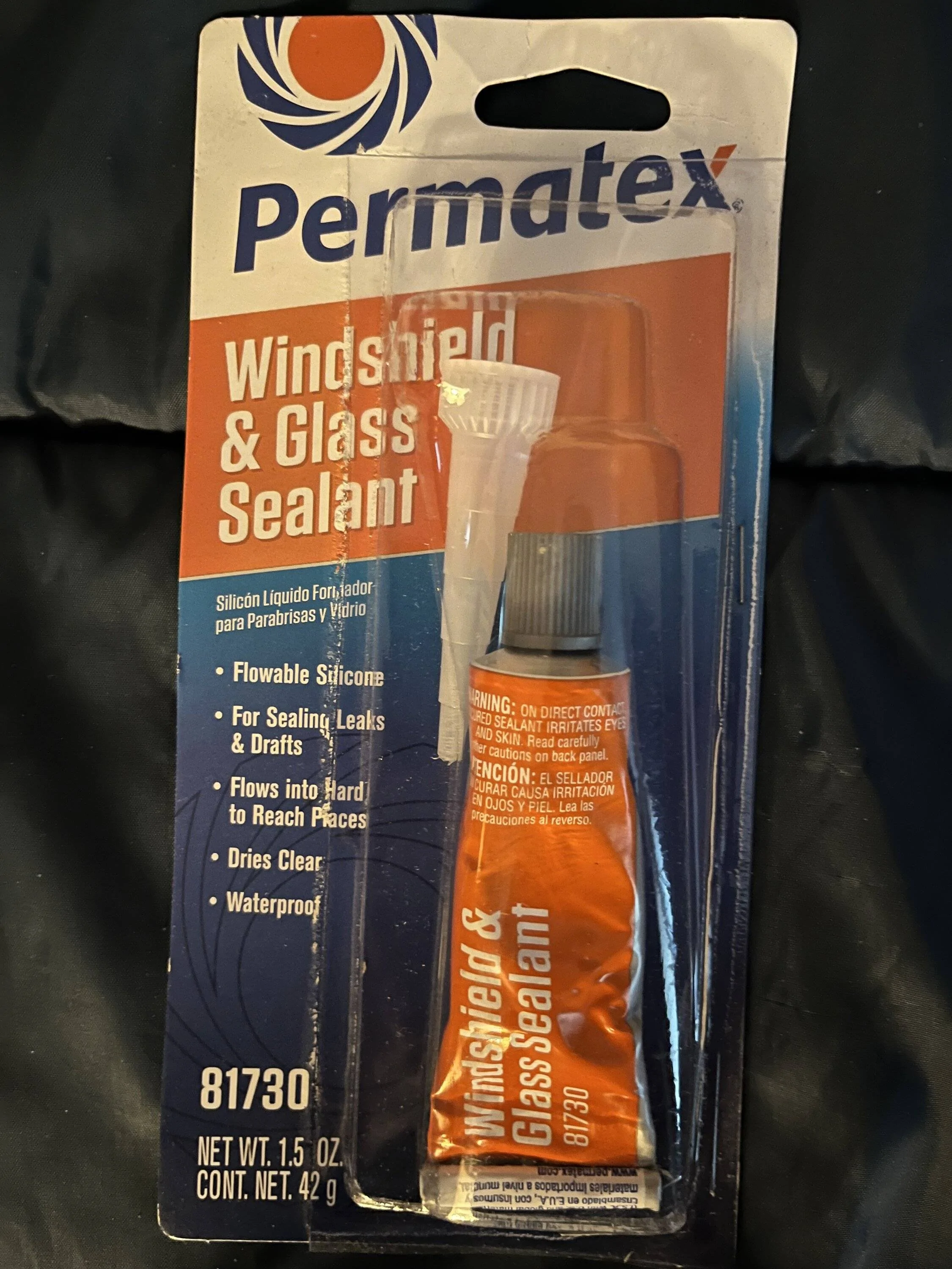

After many failed attempts to stop Leaks in the seam of the rear top and rear window leaks, I took the advice of a local glass shop and ordered seven tubes of Permatex window & glass sealant. I applied it myself, used five tubes and eliminated all leaks. Has not leaked in three years.
Jeep Gladiator Roof leak in back IMG_0122
