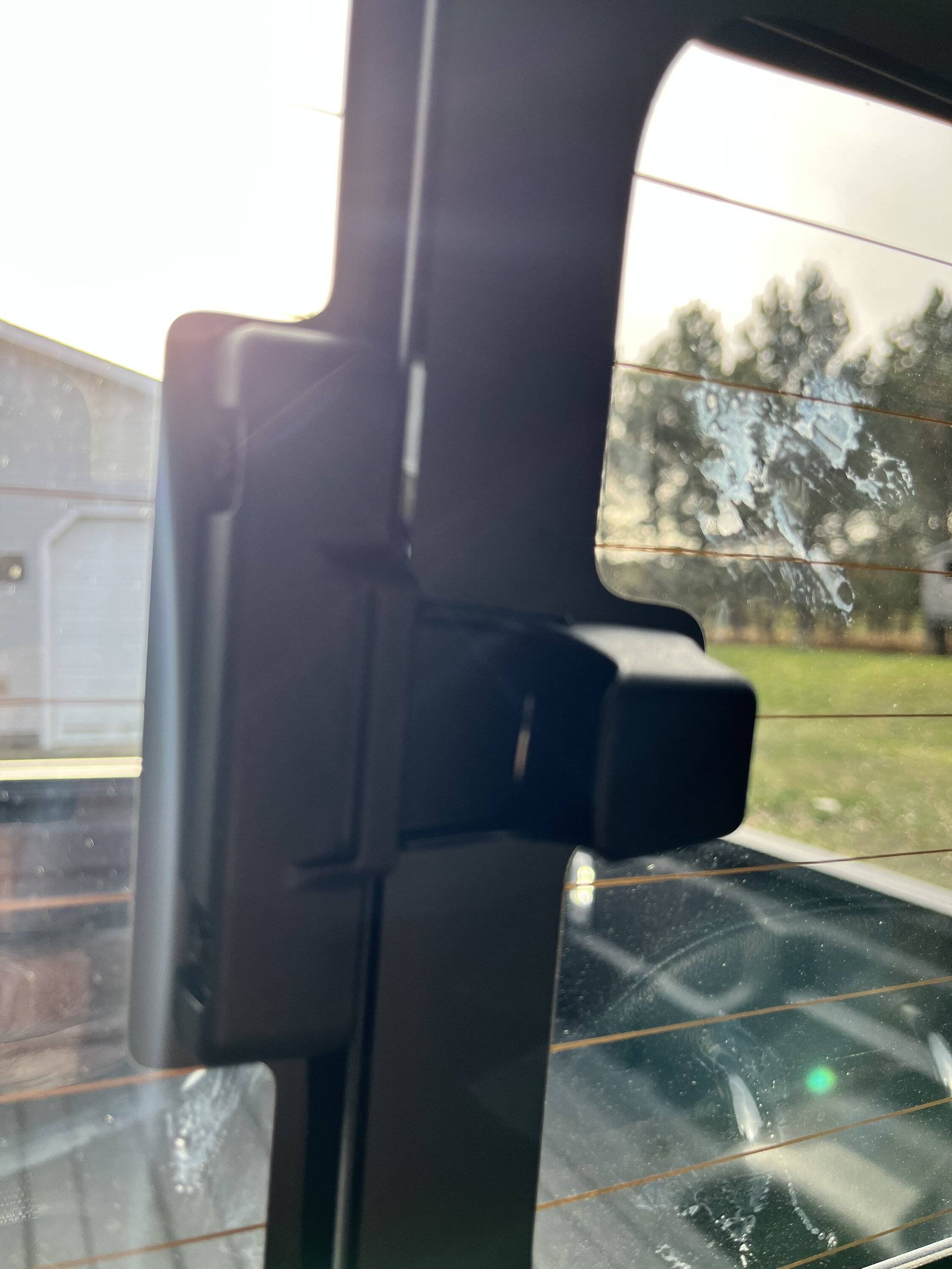

Got mine replaced a week and a half ago. Just ran it through the car wash for the first time yesterday and while checking for leaks I noticed this…
Jeep Gladiator Roof leak in back IMG_8957
The dealer is gonna check with the glass guy on Monday but if doesn’t have it they say the can’t get one without ordering the entire window.
Yeah, I would be pissed about that. These tops are not conducive to multiple window replacements before something else with the top starts to get damaged. When I had my 2020 JT rear window replaced, I found my top cracking at the rear passenger door arch radius like they used their hand as leverage there to push out the old window. I sold it before I got around to getting that issue addressed.
They are just going to chuck another window at it if they cannot get or figure how to replace the latch. If me, I would almost be considering asking for a whole new top with a window with maybe a credit cost of the window and paying out of pocket for the difference.
This happened to mine as well, but luckily I noticed it the next day and the dealership was able to remove the latch off of my old one and install it on the new one. I figured mine was just a fluke, but now that I've seen a couple of them, it seems like everyone needs to check theirs if they get a replacement.
Just talked to the glass guy and i’m gonna bring it to him tomorrow so he can do the same thing. Take the latch from my old window and install it on the new one.
