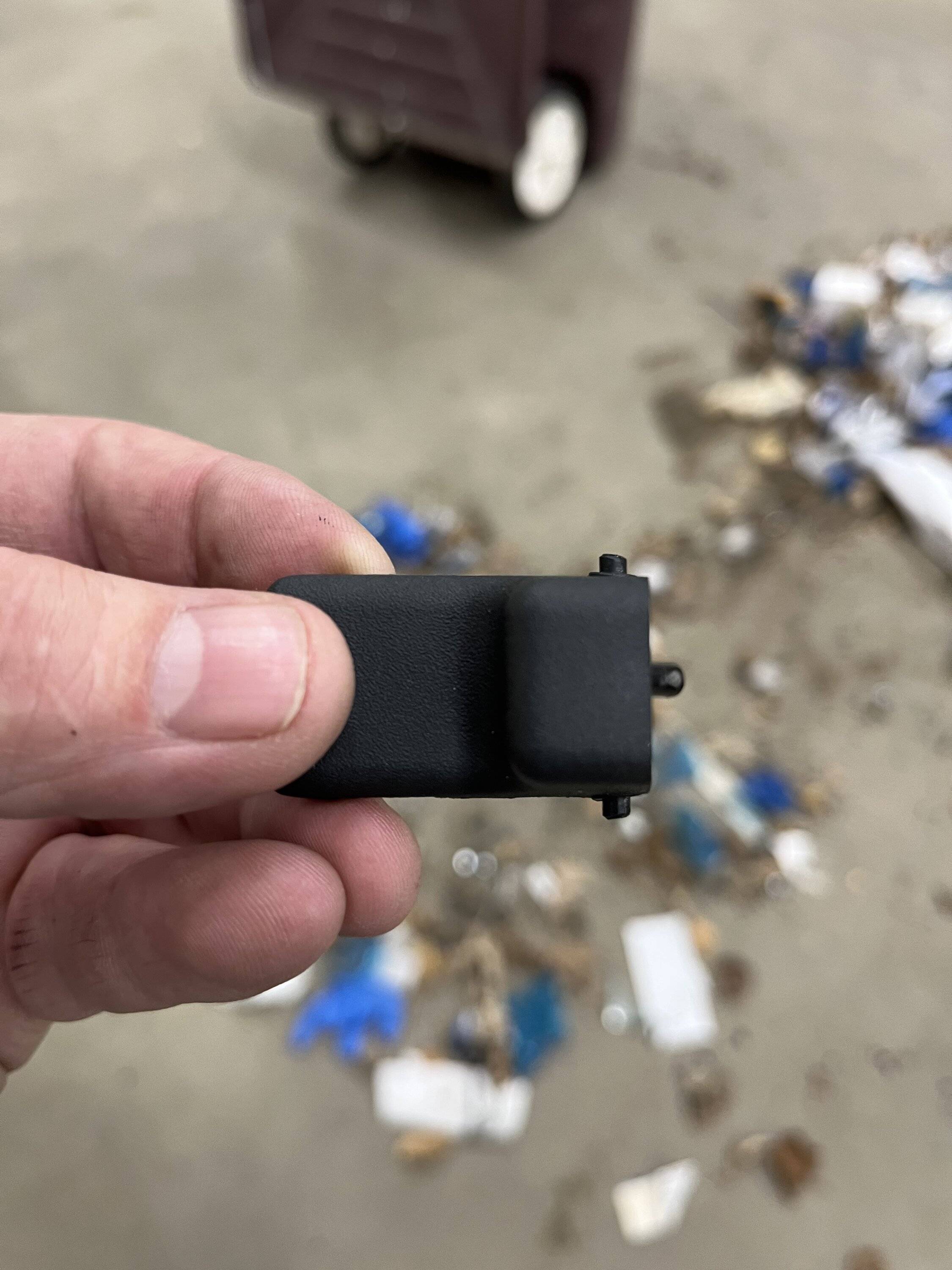

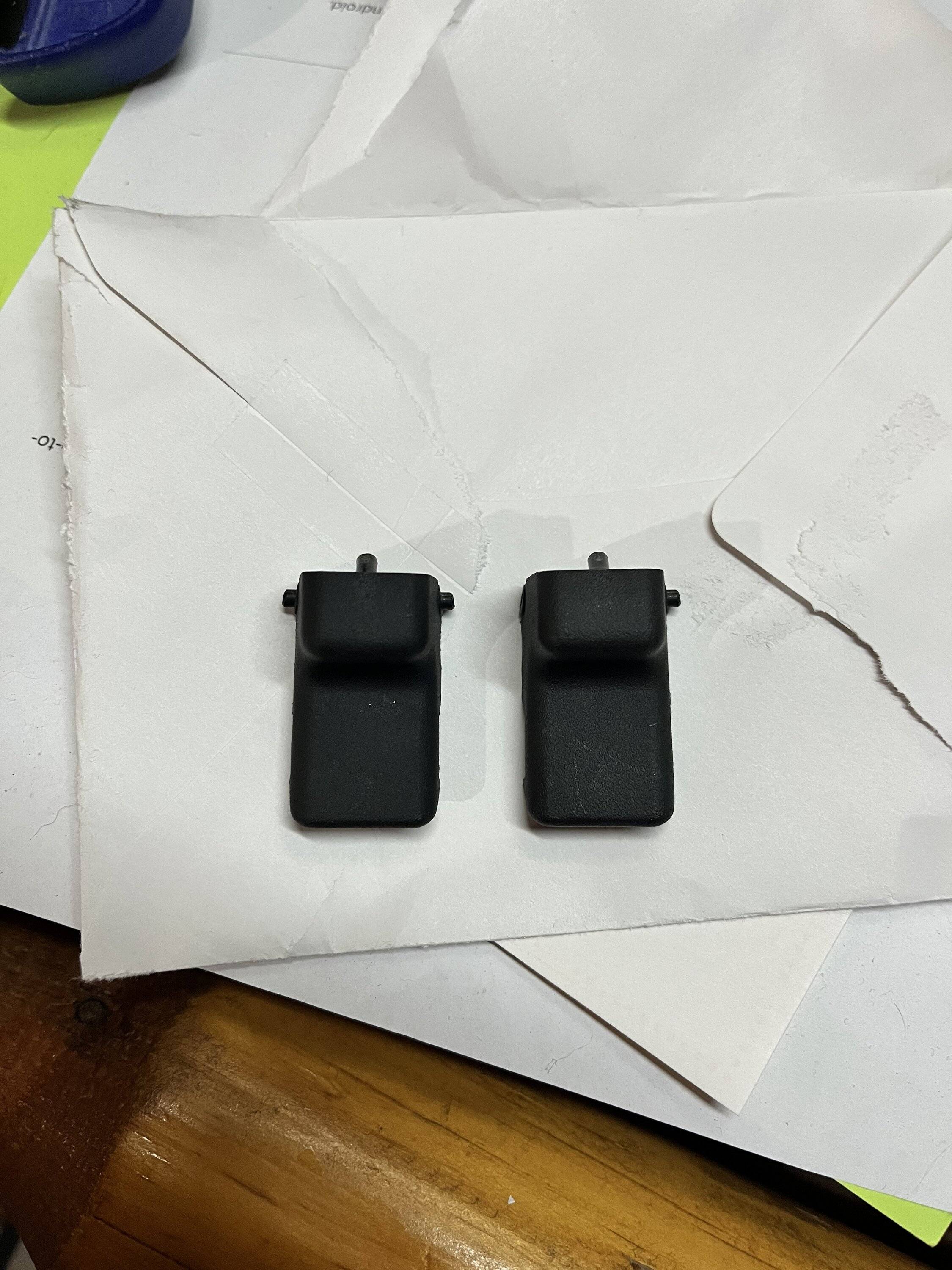

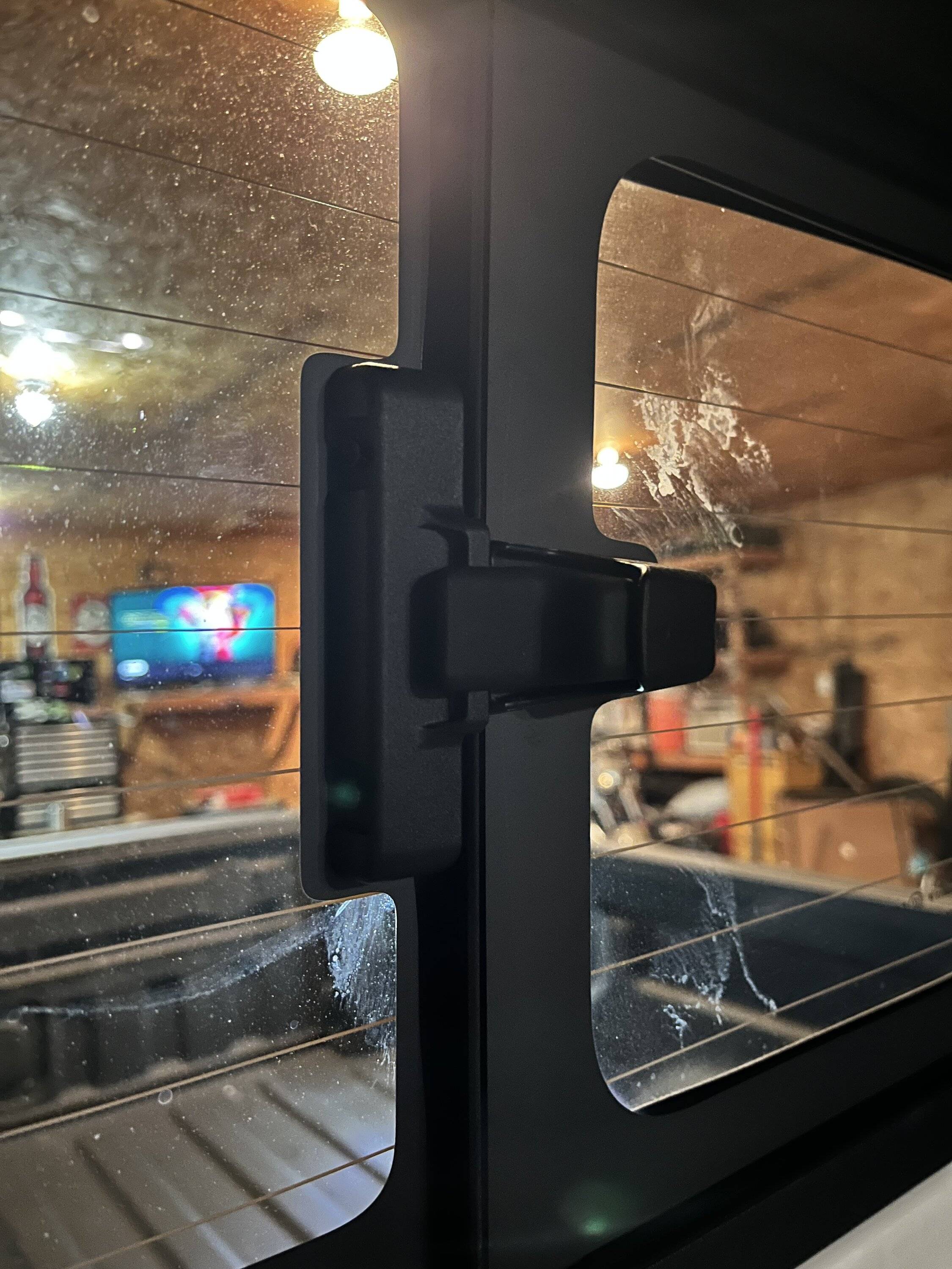

This happened to mine as well, but luckily I noticed it the next day and the dealership was able to remove the latch off of my old one and install it on the new one. I figured mine was just a fluke, but now that I've seen a couple of them, it seems like everyone needs to check theirs if they get a replacement.
So, went to my glass guy today and we found the new latch, in the Mopar window box, with a broken tab but luckily he went through his trash and found the old one in perfect condition.
That’s great they got it fixed up. Seeing that latch that was broken on the new one, I wonder if that’s what happened to mine.

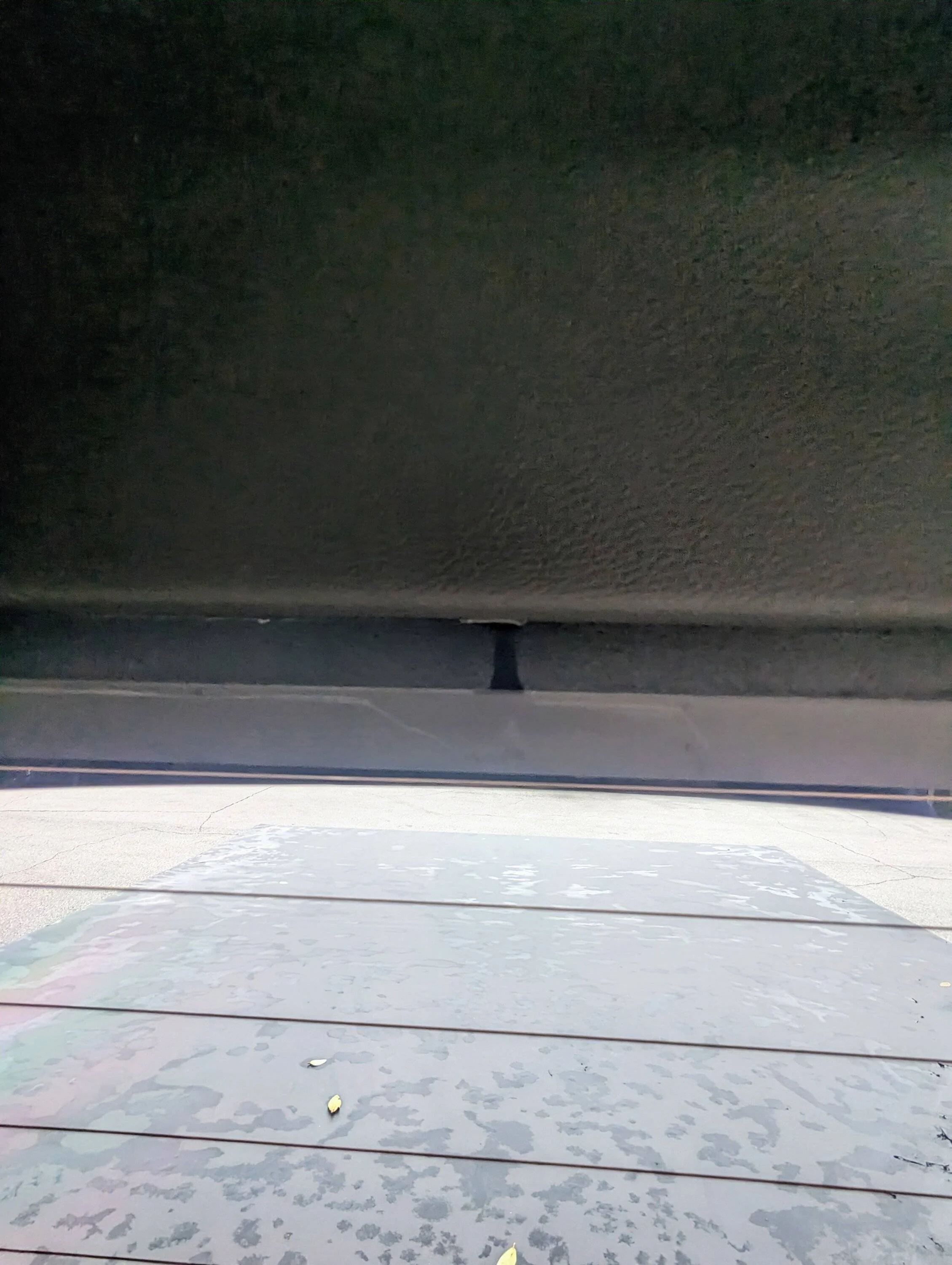

Here is from a light sprinkle this morning Not even enough to soak the ground ? . You can see how little rain fell on the tonneau cover.

Welcome to the "water wagon"!
Find the youtube video explaining the silicone tube hack. I initially installed it a bit too deep but after a little adjusting it's perfect and quite permanent.
