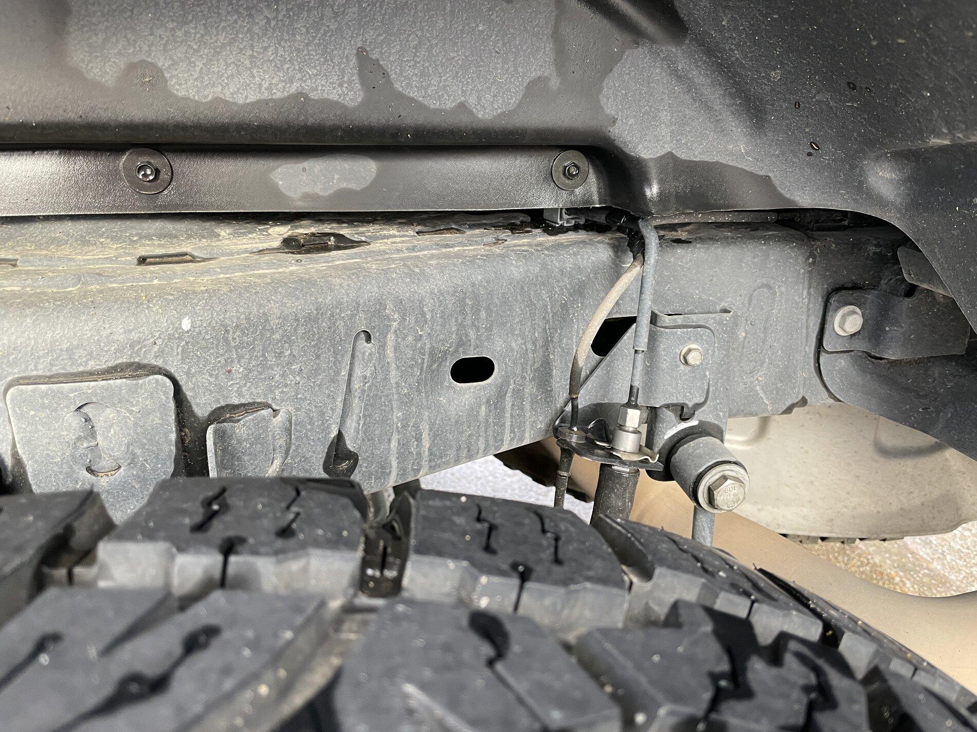

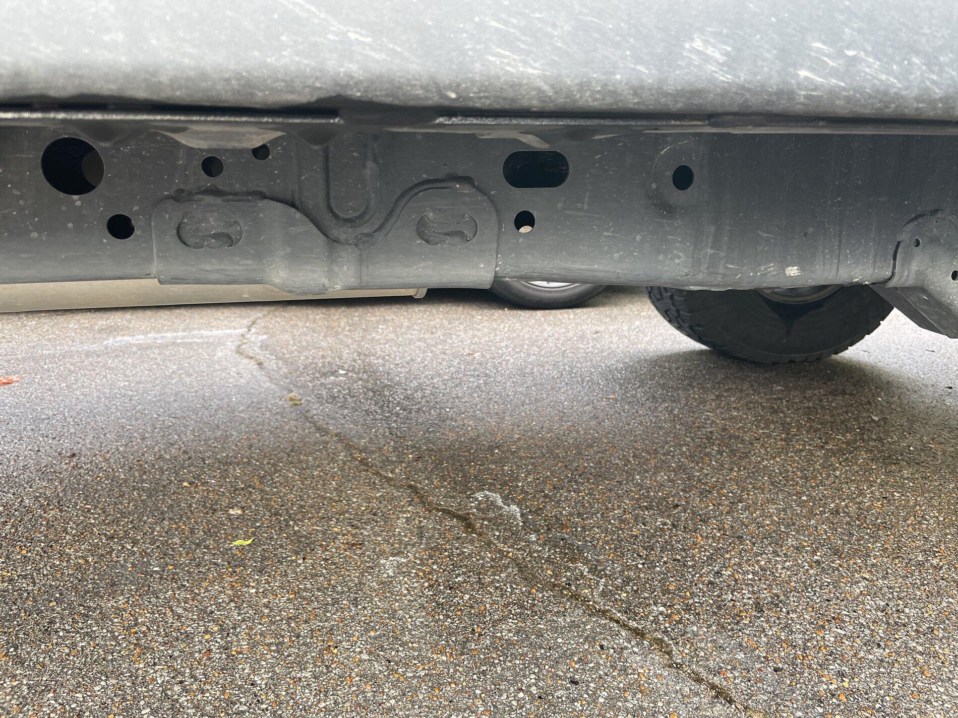

I just went out and checked my EcoDiesel. I will post two pictures and we'll need somebody here to look at their Sport Pentastar in these same areas of the frame and let us know if it looks the same or not.
The first picture is on the frame directly under the driver side rear door. Second picture is the frame driver side just behind the coil spring. You can see obvious welding in these areas, and it is between these two areas where the Mojave frame is reinforced. So, is my diesel frame reinforced too? Or do all JTs look like this?

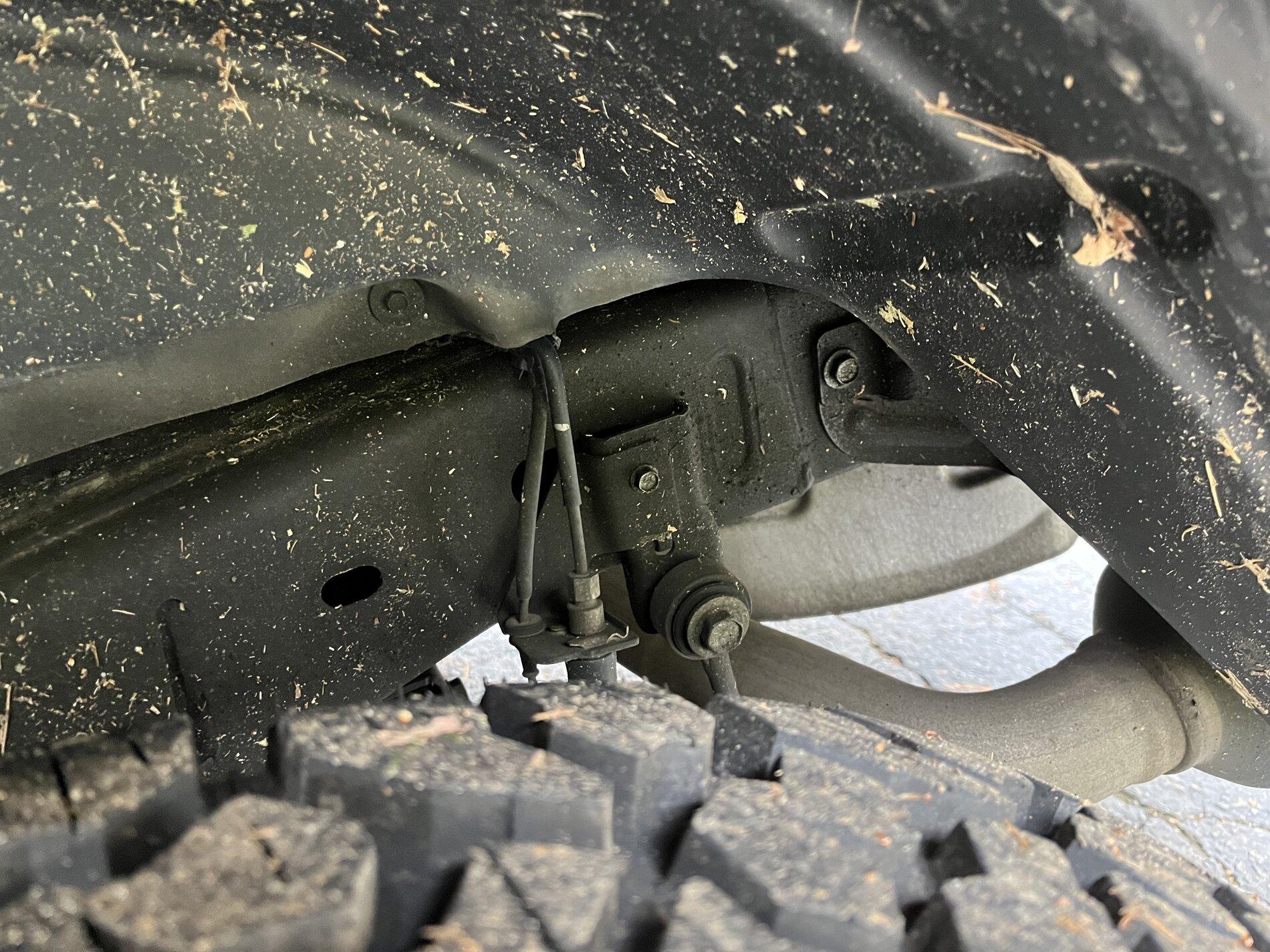

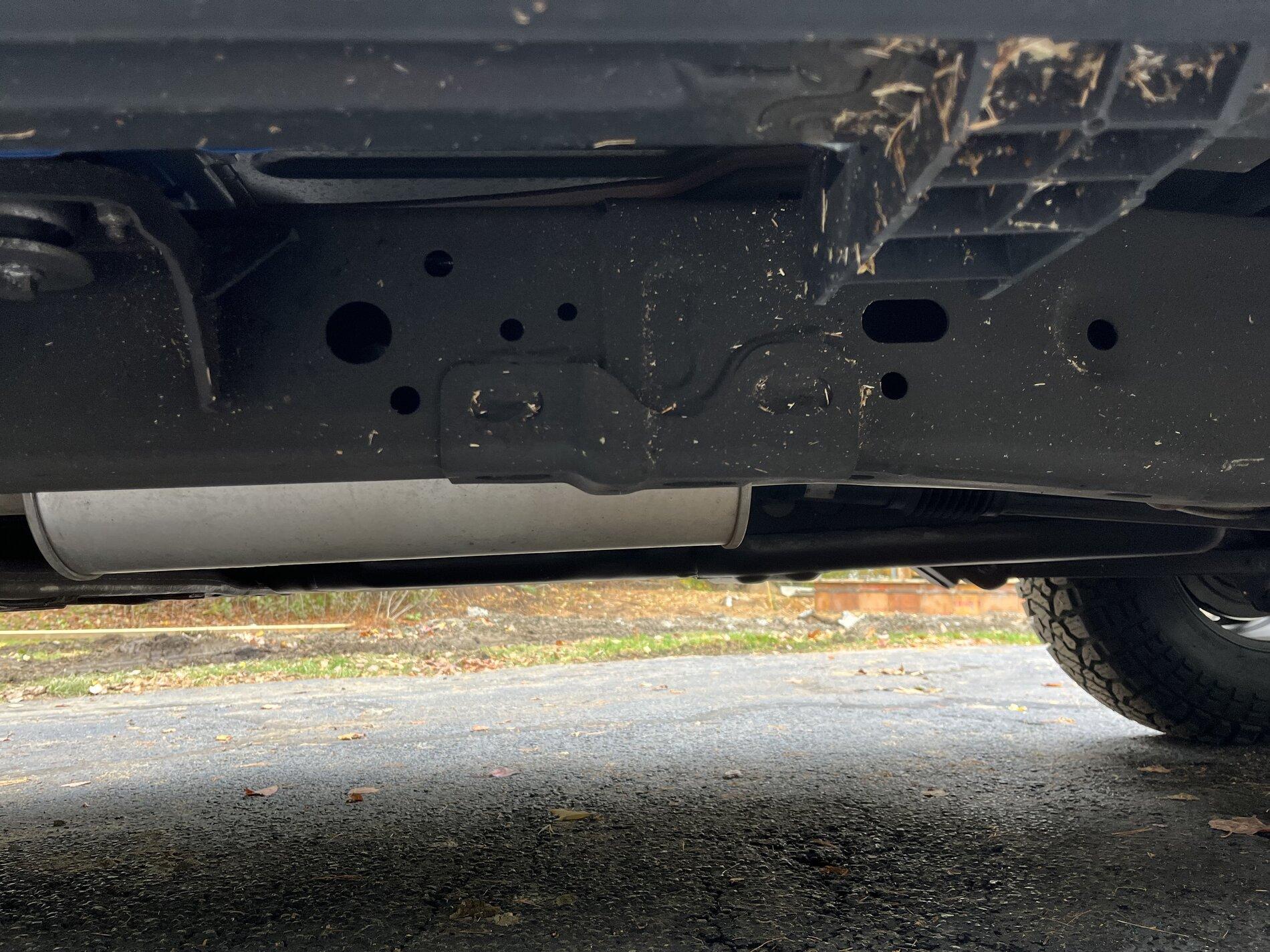

Mojave same locations. I think those areas are the same on all JTs
