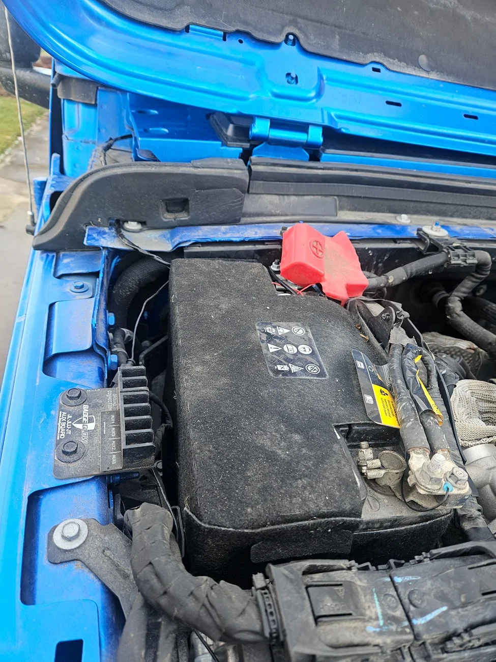

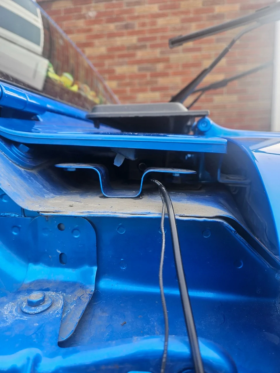

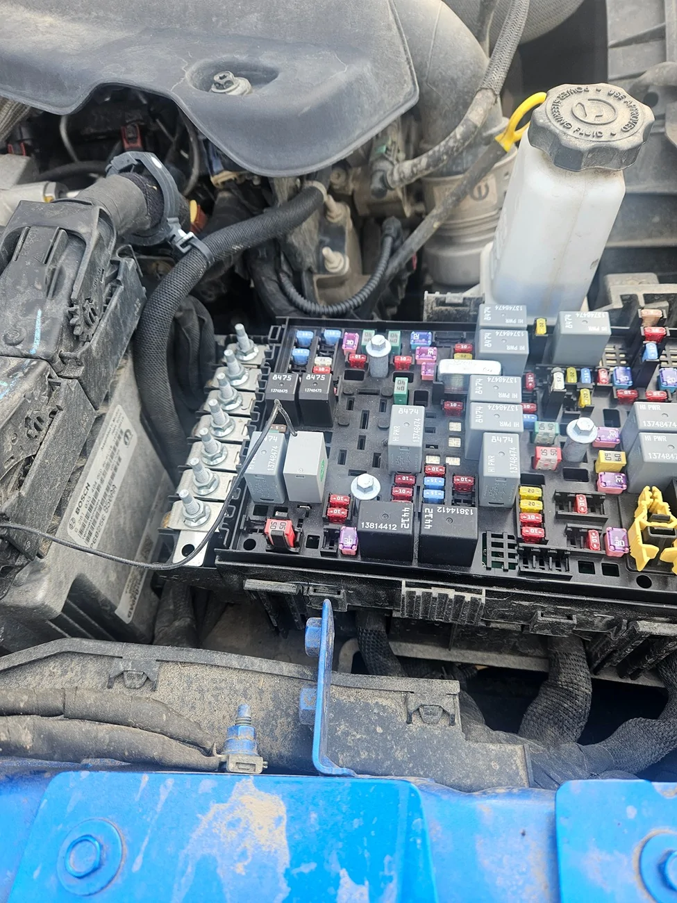

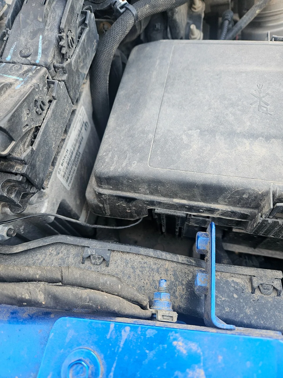

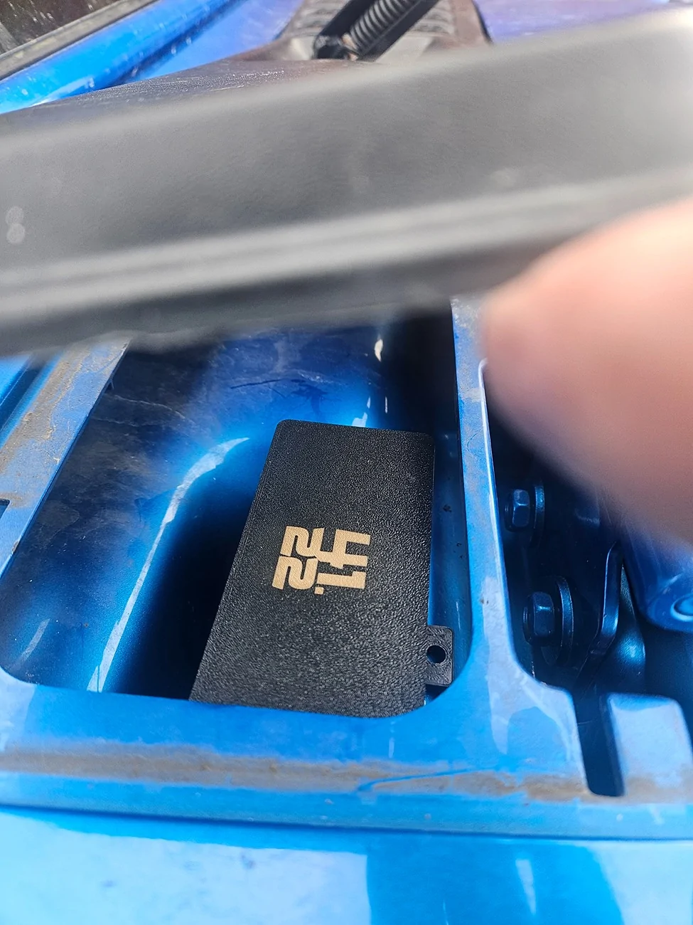

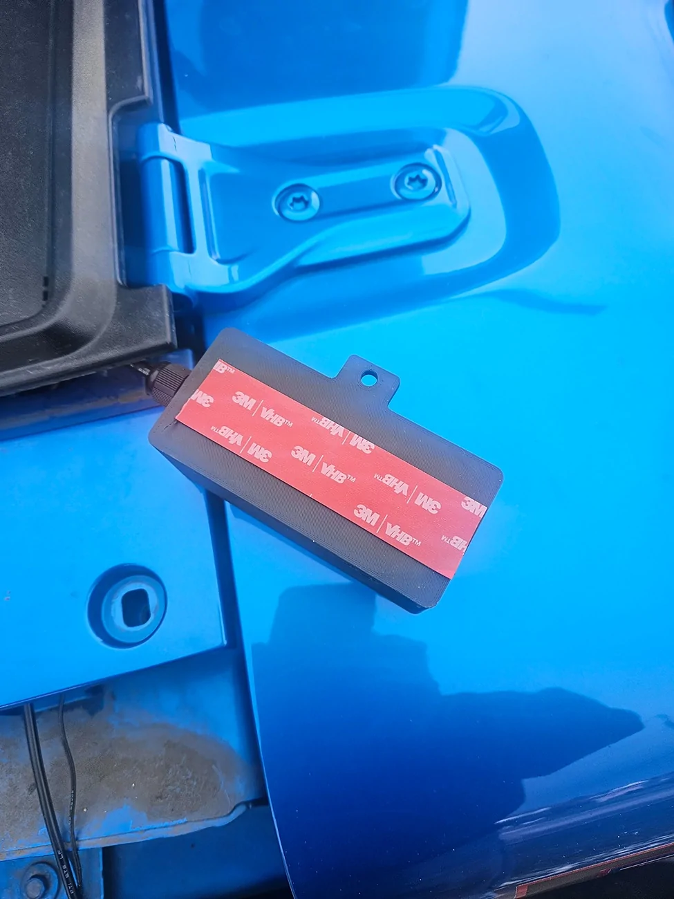

Installed the 41.22 wireless kill switch today. Took about an hour to do it. Mostly to decide where to mount the control box and route the wiring. I mounted the control box under wiper covering. I used 3M double sided body tape to hold the box in place. Replace the starter relay with the kits relay. Ran the wires so that they won't be to noticeable. I used my dremel tool to put a small notch in the fuse box edge so that the relay wire could come out without being pinched.

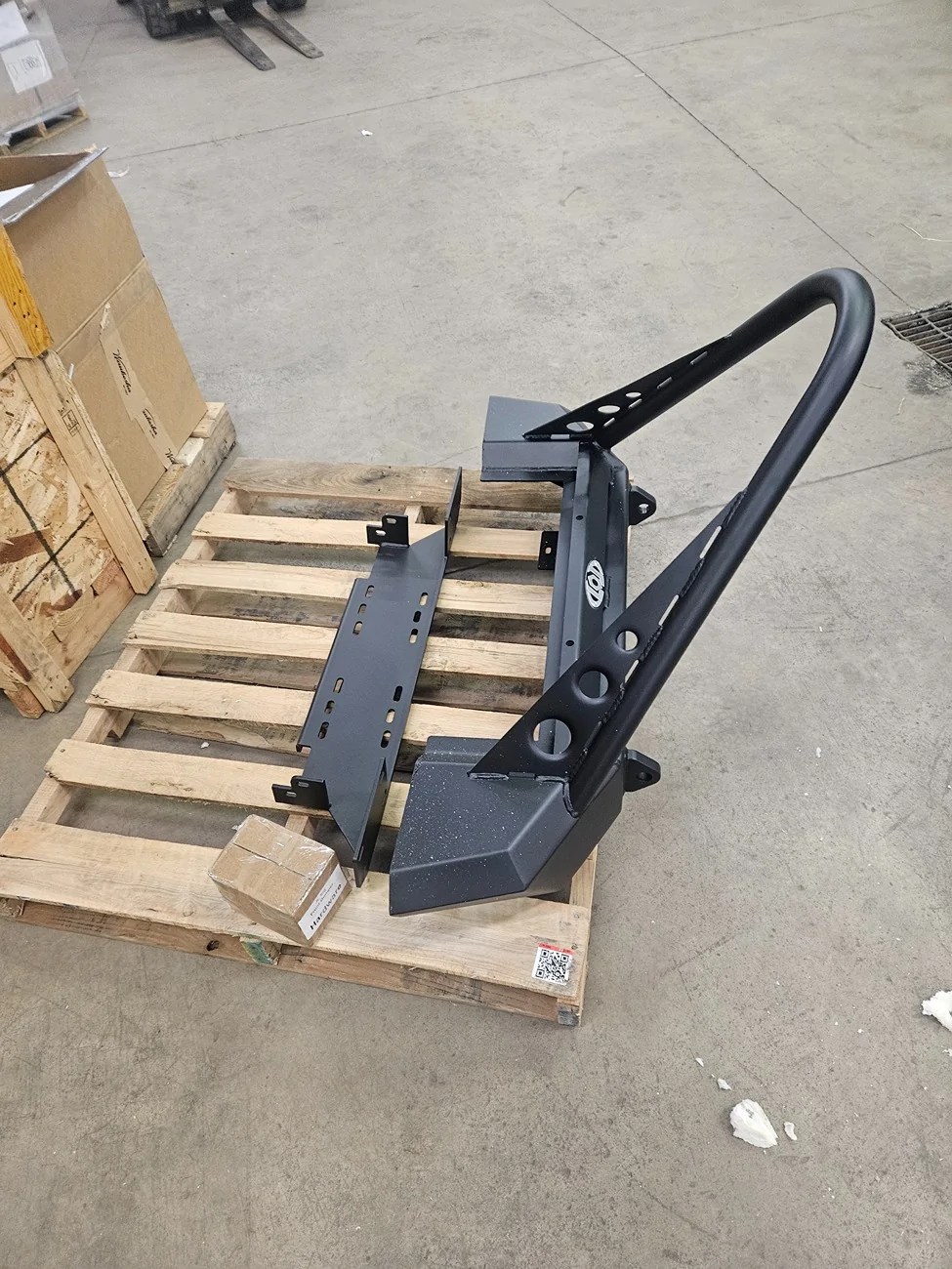

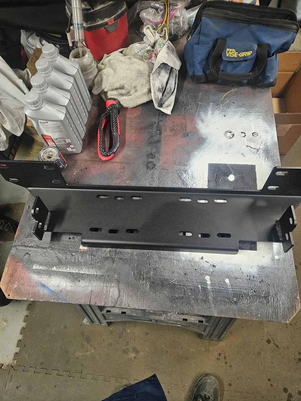

My winch bumper showed up.

The bumper and winch plate was packed really good. Had to rip the box apart to remove everything.

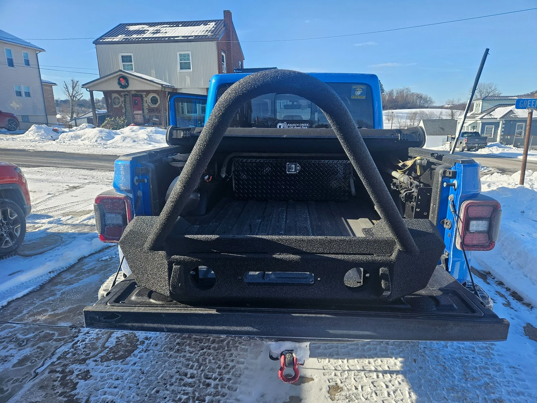

Got the front bumper back from Rhino. Had it and the skid plate coated. Don't have to worry about the powder coat getting chipped and rusting.

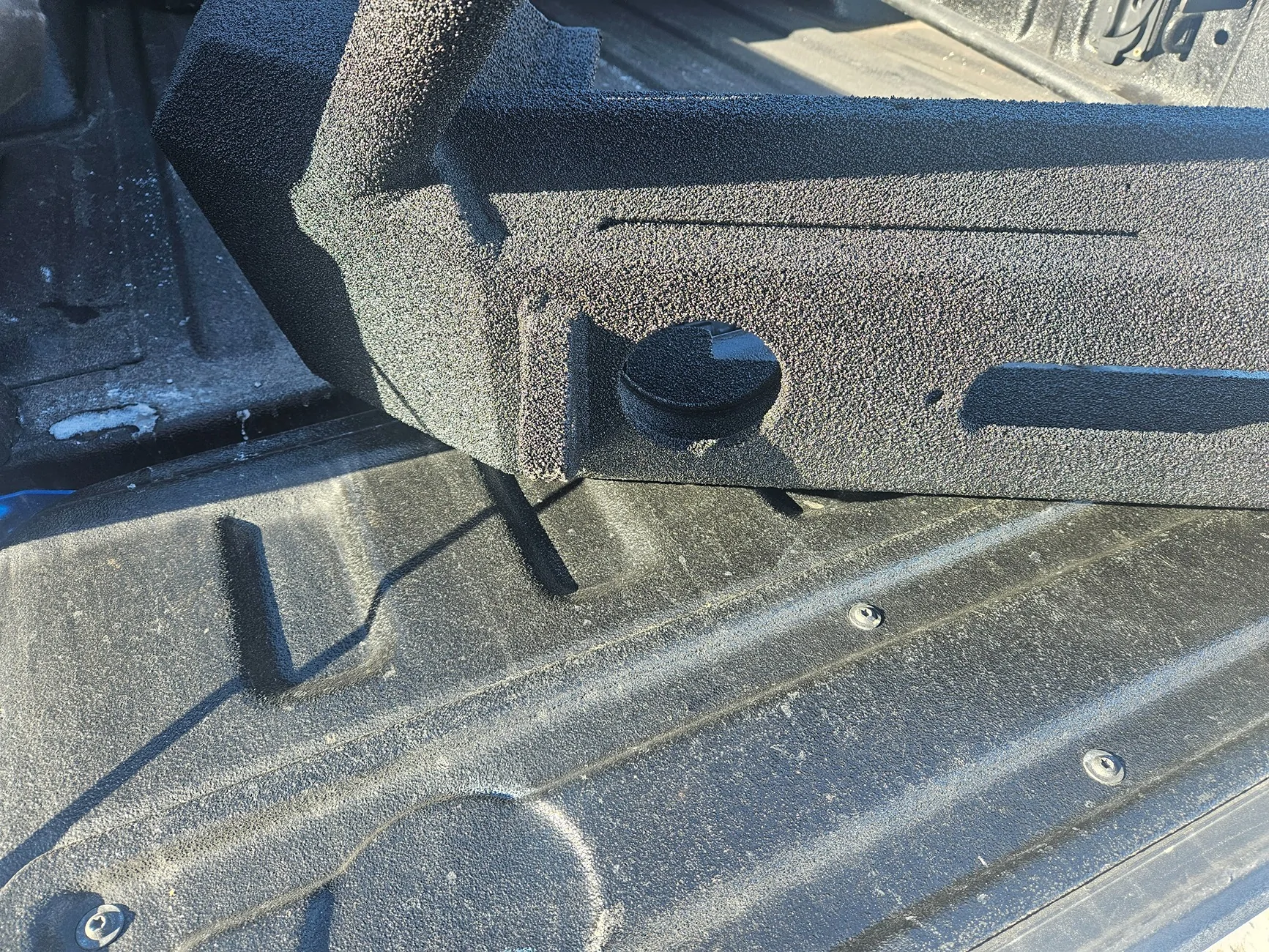

The difference between Rhino and LineX. Say Rhino is 36 grit and LineX is 600 grit. My bed lining is LineX. Wanted LineX, but the closest one was over 2.5 hrs away.
