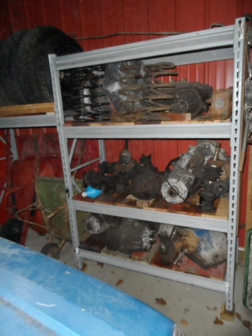

(Transfer cases, anyone?? This is part of my stash of springs and transfer cases, heads, transmissions and front and rear differentials as I know one or two people (not in this thread, however) don't believe I've touched the stuff. I gave away a transfer case and transmission last year. )

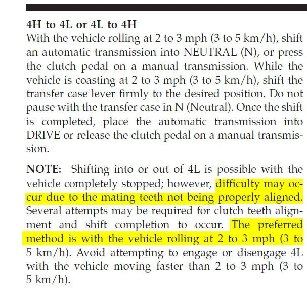

Going from 2H to 4H and vise versa is easy at any speed, as long as no tires are slipping.
To shift to 4L you need to be in neutral with the vehicle moving at 2 miles per hour. Otherwise you will stress the linkage and bind it up.
"need" is a bit of a strong word. I believe it is just hard on the system to do so standing still. But the old saying applies: you shouldn't use 4L to get unstuck. As for actually moving, actual movement does help, as the manual says not to be pressing on the accelerator while shifting into 4L
I don't think need is a strong word, because that's how the transfer case was designed to be operated. Yes, it'll go in (sometimes) if you're sitting still, but it's hard on the gear teeth. So, I think it's prudent to say that we need to do it the correct way and be moving.

As a person who has, and still, rebuilds transmissions, differentials and other boxes - the issue is that you MAY end up with tooth butting against tooth. They have angles on the teeth so if they are offset even a little bit while shifting they will angle past each other and engage. The edges or sides of the teeth aren't blunt or flat, they have angles on them.
If you are fully stopped and the teeth butt head to head so to speak, it won't be easy and you won't be helping the shift mechanisms. You'd have to bang it hard to damage a tooth, but hey, maybe some would try.
With it coasting slow, under load, the chances are the teeth will not be butting edge to edge - and it will engage as the angles on the teeth slide past each other.
If I had a box up on my bench open for repairs, I'd video how that works and why they say transmission in neutral, road speed SLOW - so they go together no load and can gently slide past each other into engagement.
There is no synchronizer between 4H and 4L, 2 to 4H yes.
