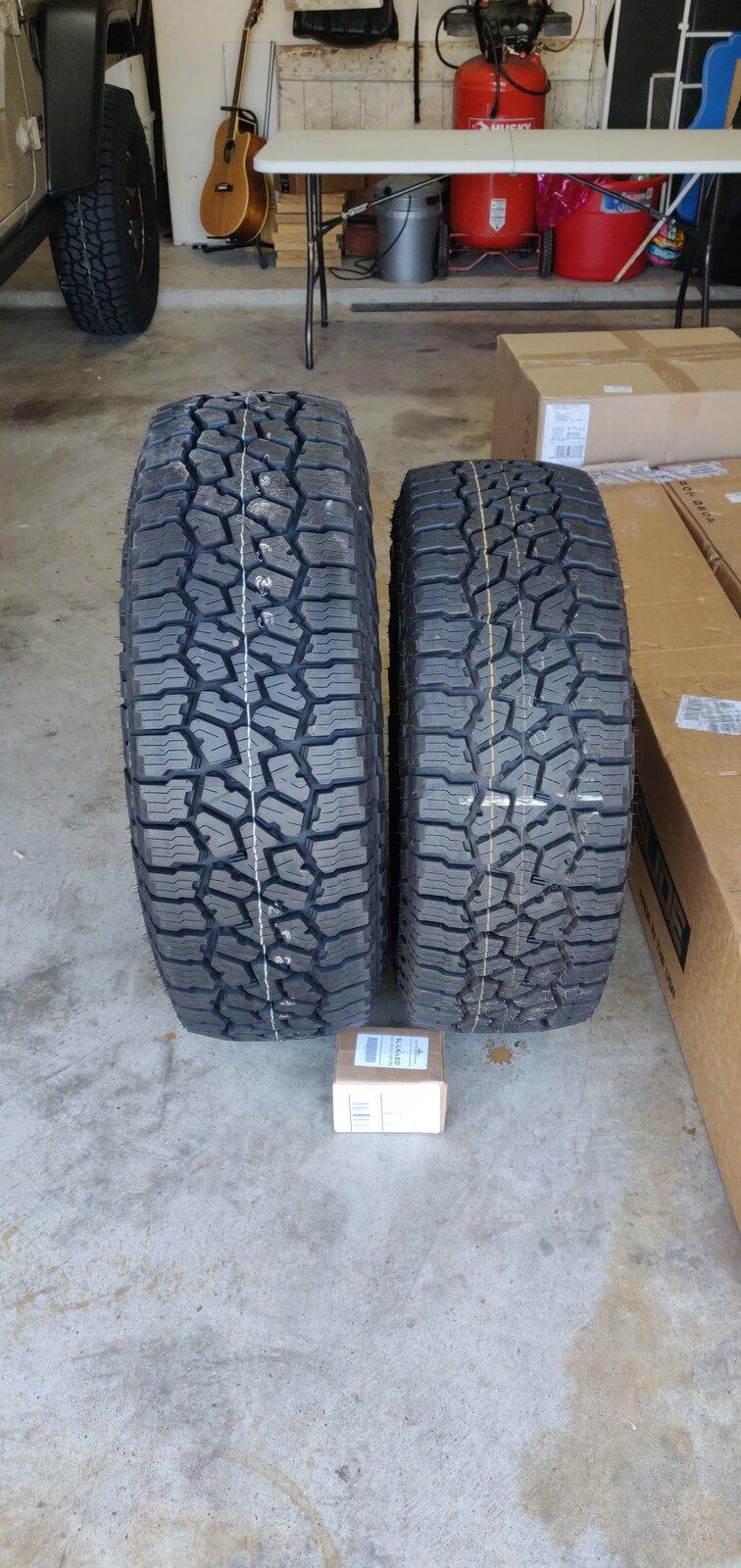

I currently have 315 70 17 Cooper SST's but I waited for Walmart to put the Kenda Klever 35x10.5 on sale for a spare. I picked it up for $174.
Thinking if the Coopers ever wear out Ill go with the Kenda's. Very nice tires and like the narrow width.

I always run a full size spare if I can. We travel across west Texas a lot. It can be a long way to travel to a tire store. I found a matching OEM wheel and bought a spare 37" tire. Fits perfectly under the bed. The size difference was too much for me to leave the factory 33" tire under the bed. I also do a 5 tire rotation now.
