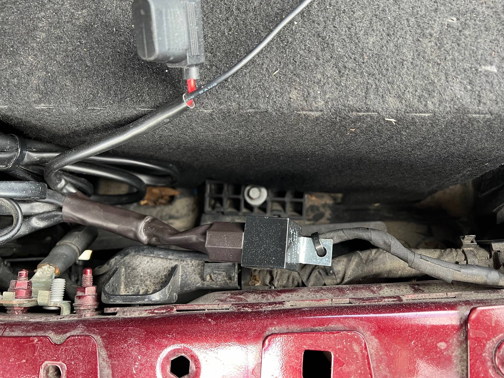

Hmm. Maybe, I honestly don’t remember. I will say that I remember fighting a bit to get the new battery in place. It’s nice and snug now. I can get a picture tomorrow for you (remind me though ha).
Here’s my battery area. Only things in there are the battery and this little bracket with the hex bolt to hold it in place (closest to passenger side). The battery is pretty much touching all edges otherwise.

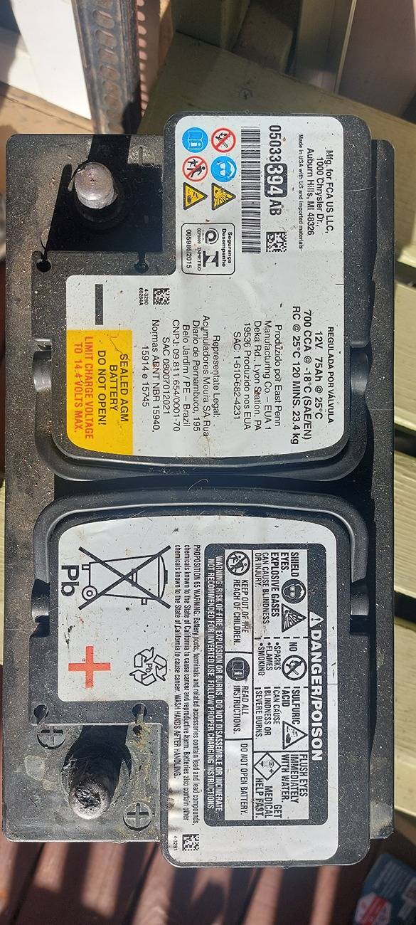

With the max tow, you get the larger alternator and was wondering if the battery is the larger group 94 or the standard group 48? Mine is 4.5 years old and its starting to fail.
I know all I have to do is pull it out to see the size (battery blanket wont let me see the sticker and group size without pulling the battery out) and I'd like to order it and get it to the house as I don't have a spare vehicle for the next 2 days as the wife has to work and I want to get it done tomorrow.
Thanks in advance
This is the OEM battery for a 2020 Sport S Max-Tow
Jeep Gladiator Sport Max tow battery size 48 or 94 17358474630292657375119669432807
The replacement one I bought was slightly smaller but works from Walmart. The reason why still have it is it's still good. The other battery failed. Something to think about.
