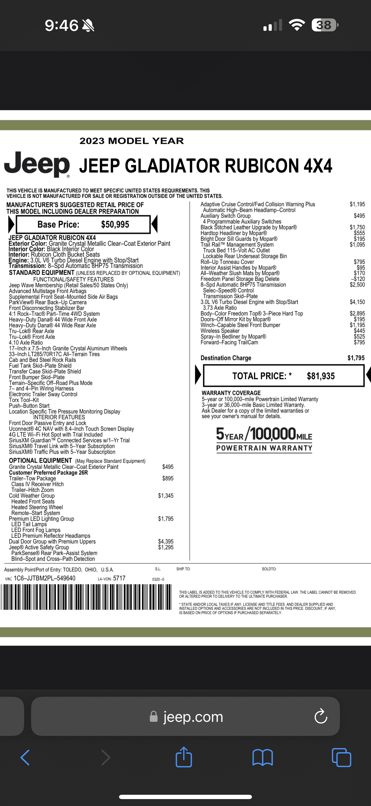

Was just looking at my dealer and saw they have one for sale now. And holy shit $81k? That’s how much a Fully loaded gladiator is now.
Dude there are a lot of bs extras on this build sheet- dual doors….. headliner, steel bumper…. Granted the dual doors are valuable to some folks- they aren’t cheap from the factory…. ??‍♂ lots could be shed to put the price into a more normal range (70-73k).

That’s insane, aside from the 4 grand for the doors and the color this is the same truck I got for 63 grand.
No one is paying that though. I was just offered, and may still consider if they can come down a little more, a fully loaded diesel Rubicon-including the cross stitched seats-for $63k. The MSRP was just shy of $75k.......
Oh I agree, just nuts. 83k you can buy a TRX.
Except this Jeep isn't for sale because it's my Jeep, that's my custom order I was just at the dealer yesterday and my parts are on order
That's my build, I wanted the half doors because I have kids in car seats and wanted to leave the rear half doors on when I take the roof off, also I liked the oem look. Also I'm not paying anywhere near that price for it.
interesting they usually dont post the custom orders, i knew it was custom, first diesel ive seen popup for a while. I do a lot of business with this dealer - good people, Enjoy it.
