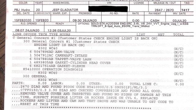

Latest update. I’ve been driving the Gladiator for just under a week now and have not had further issues. However, that week equates to about 100 miles, so there may not have been time for things to materialize quite yet. We’ll see. I’ve posted the work sheet from the service department which shows some pretty hefty part replacement.

I'm supposed to pick mine up today, they have replaced the #2/4/6 cylinder head, cam shaft, rocker arm and rockers, timing censor, intake, and coils. Ill let ya know if it's fixed when i get it back and drive it a few days...

Well here is the update on mine. I got it back Friday and the combined two trips to the dealer they had it a total of 26 days. They replaced the #2/4/6 side cylinder head, cam shaft, cam censor, rocker arm, rockers, intake, and coils. I've driven it a couple hundred miles and it seems to be fixed and is running well. Ill keep you all posted if i have any other problems. I am meeting with the Chrysler rep tomorrow and will be demandi g an extended warranty on the drive terrain.
