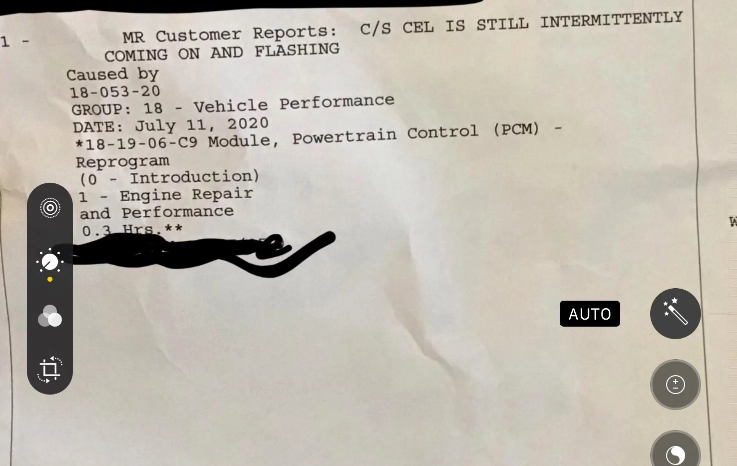

Cburgess33
Christopher
Jul 30, 2019
99
110
2020 Jeep gladiator rubicon and 2018 Rubicon JL
Got mine in the driveway. So far so good. The paperwork is below.
Hopefully this works for u !! I was hoping they shed more light on what needed to be reprogrammed . Does seem weird all JT programmed basically the same but only a subset saw actual problems - This part has me curious... but either way good luck and hope u are out of the woods on this one !
