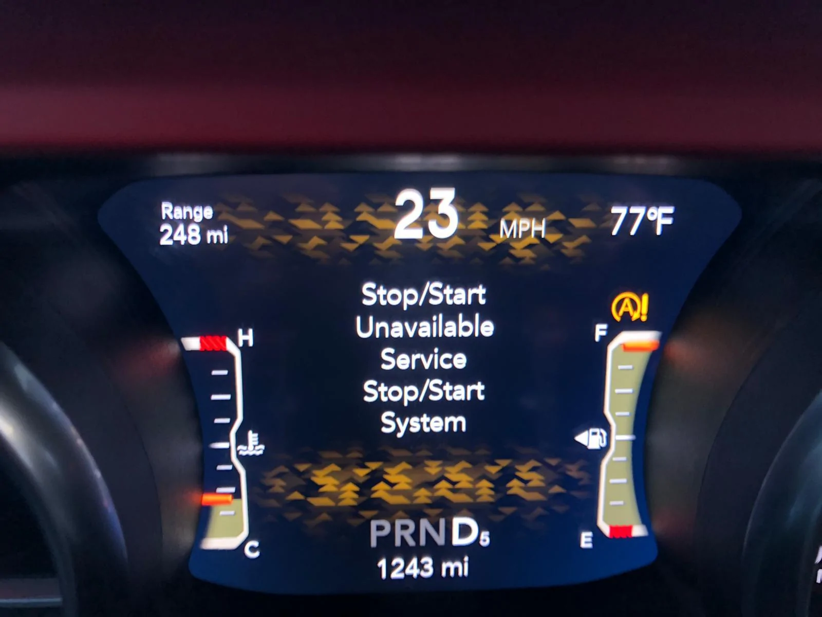

Add me to the list. Bought my 2020 Gladiator Rubicon yesterday. It was a Demo with 5000 miles. On way home was at a stop sign and as I started off it felt like some one ran into me. Next morning on the way to work had to stop for a light. As I started to go there was a violent shake and the A! light came on. It's at the dealer now.
So, took to dealer. They looked it over and the positive lead to the SS battery was loose. They tightened the terminal and cleared codes. 600 miles later all is good.

Bad News ... had software update last Monday. Today at 200 miles ESS and Check engine light. I have only put 36 miles on this truck! I am done!!!!

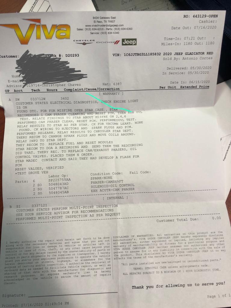

Just got back the gladiator after being in the shop since 6/15/2020 and auto start stop light is on again. This will be the 4th time in the shop and well over 35 days. Love the gladiator but looking into the option of getting the lemon law. Dealer has been hard to work, talked to FCA and they said my dealer was taking a long time answering emails and ordering parts. Visited the dealer and asked what was going on and he admitted To not following quite closely. FCA also game me a different rental because dealer had given me a mini van . Going to try a new dealer.
