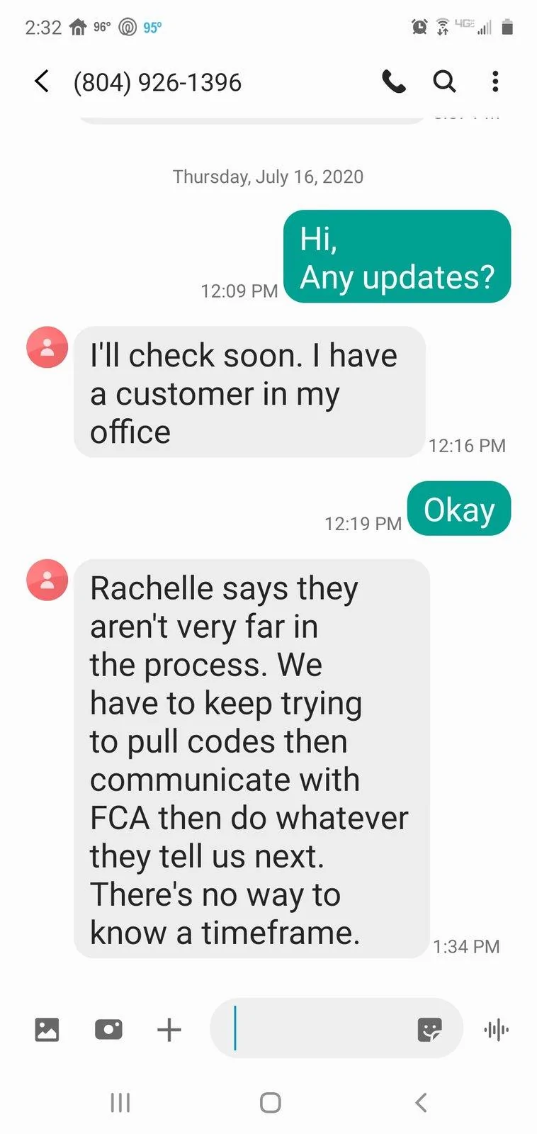

Second time in the shop for my Gladiator. This time it has been 11 days so far. I have attached the response I received when I asked for an update yesterday.
Jeep Gladiator Survey- For those with misfire issues Screenshot_20200717-143222_Messages
