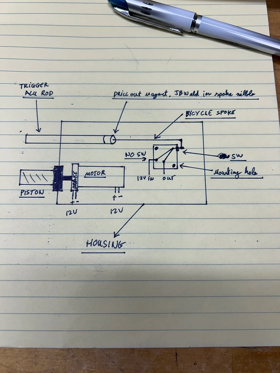

It's quite simple to add a micro switch in the right position. Feel free to contact me once you have it opened. It's mich easier to explain. Has been a few years since i worked on mine, but I'll try to sketch one up shortly.

I used bicycle spoke and nibble for fine adjustments lol, but you can use any other means. Install the spoke nipple with the flared end toward the bottom, then fill it with JB Weld around it. Whatever you do, DO NOT activate the motor without connecting to the swaybar. Apply power to the motor and once disconnected, place the switch in, marks, drill and tap or through bolt and nuts should works too.
Jeep Gladiator swaybar front disconnects........... IMG_0081
