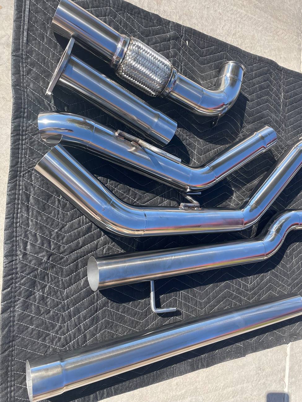

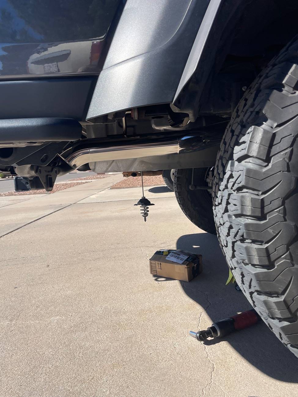

I have the rest. But have to go somewhere for Thanksgiving. So decoded to do part of it to document and the rest after Thanksgiving. Want to be able to report the diff between the two tunes with exhaust.

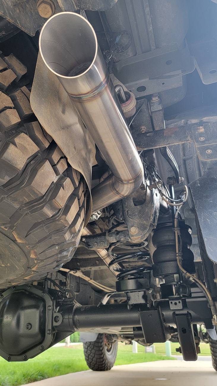

Good luck I had to cut my factory in 2 location due to the inability to get some bolts off and getting it over the axel. Looks like you solved the latter.

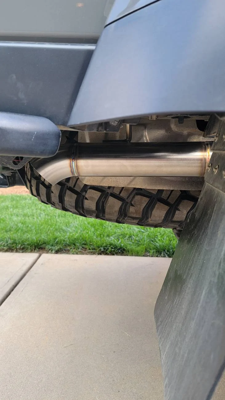

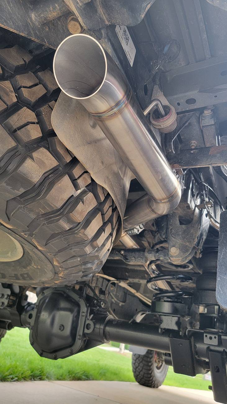

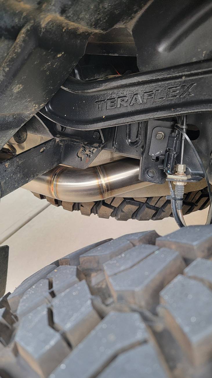

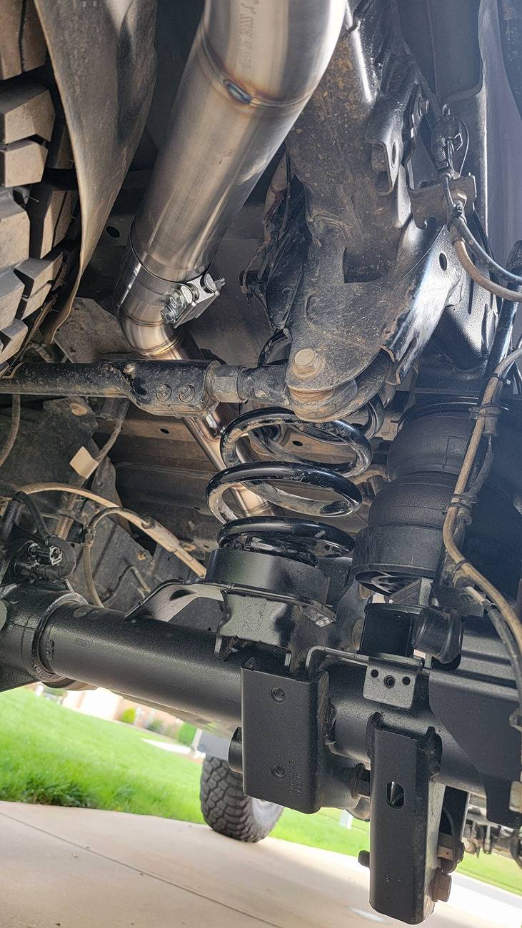

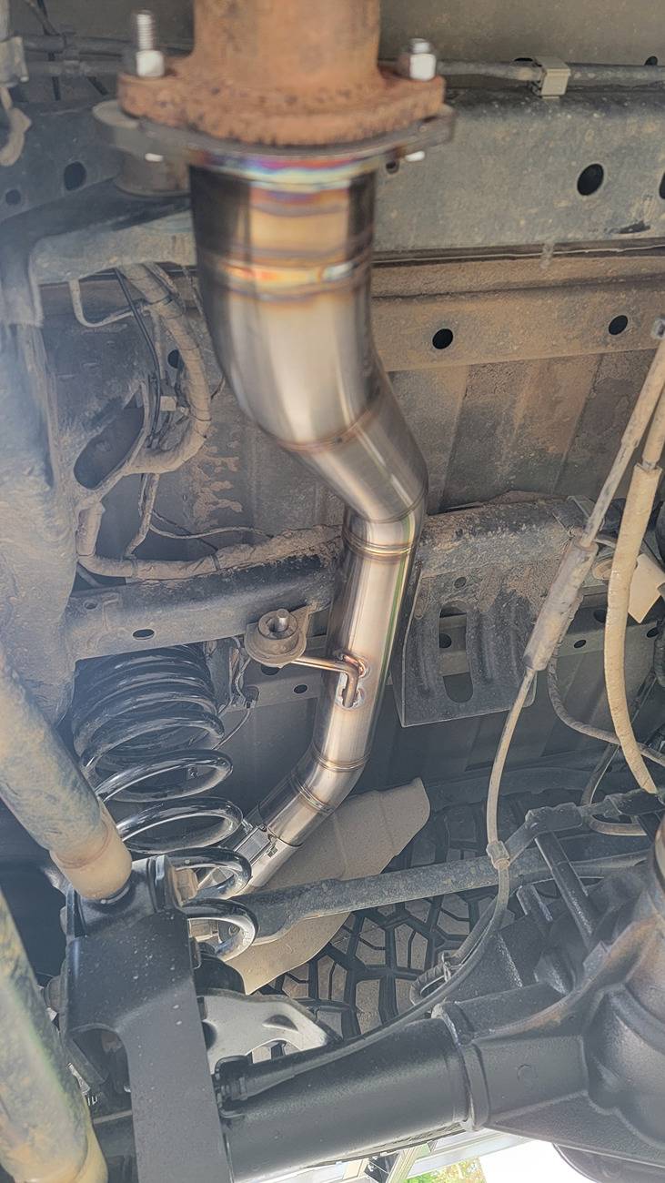

The trick to get the tailpipe out in one piece is to remove the spare tire and pull the aluminum shield off, I also disconnected the track bar and it came right out the back.
Gregj
I’m sure that would work, but I had already cut the expensive part, the tailpipe was the least of my worries….

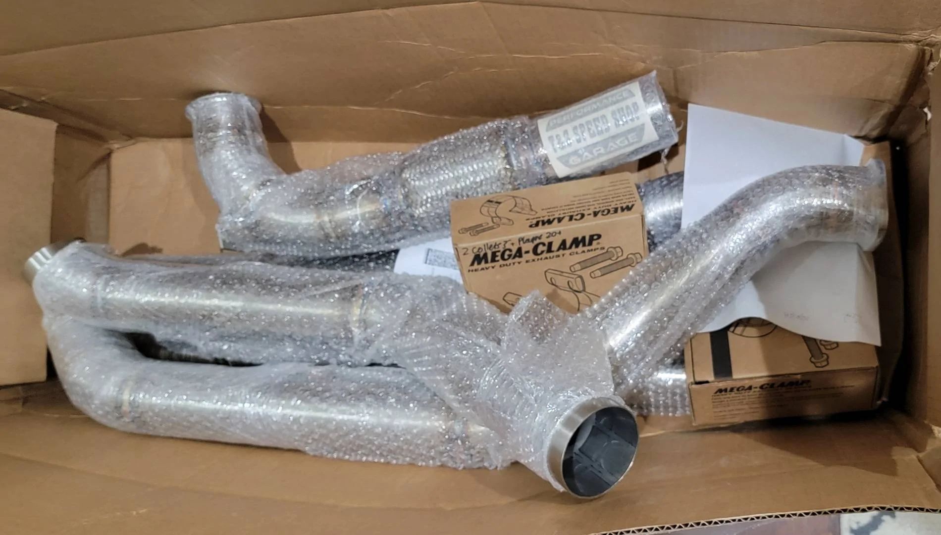

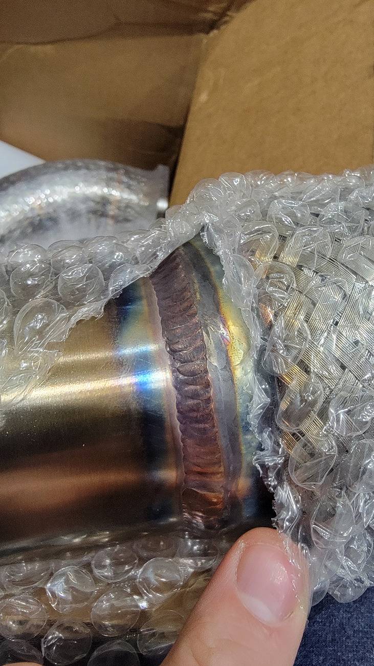

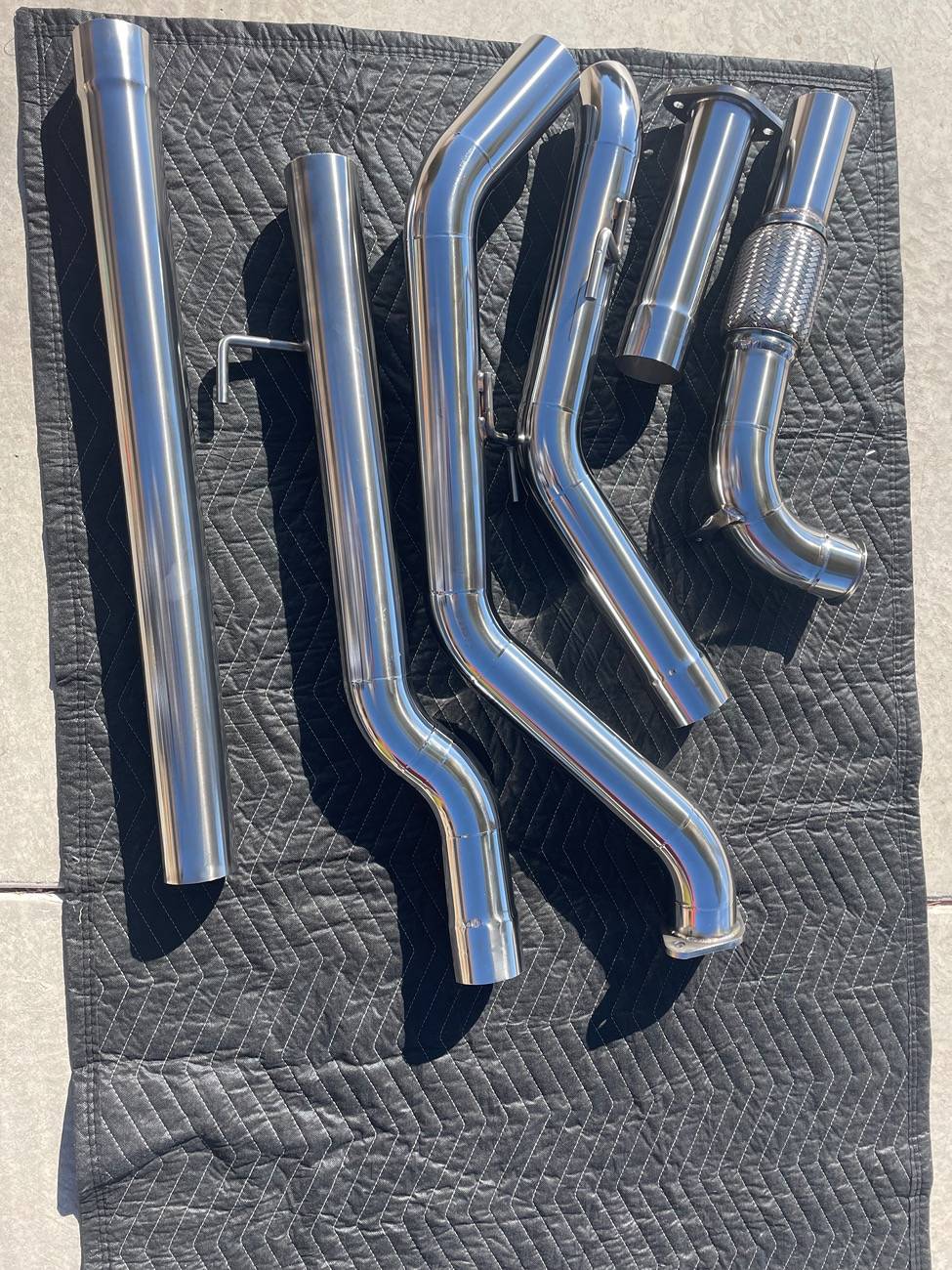

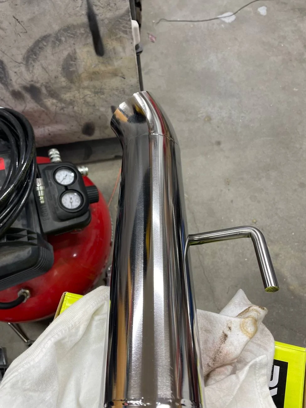

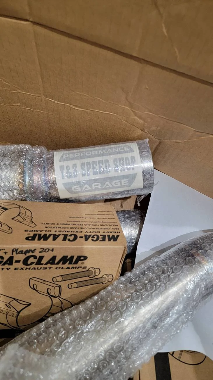

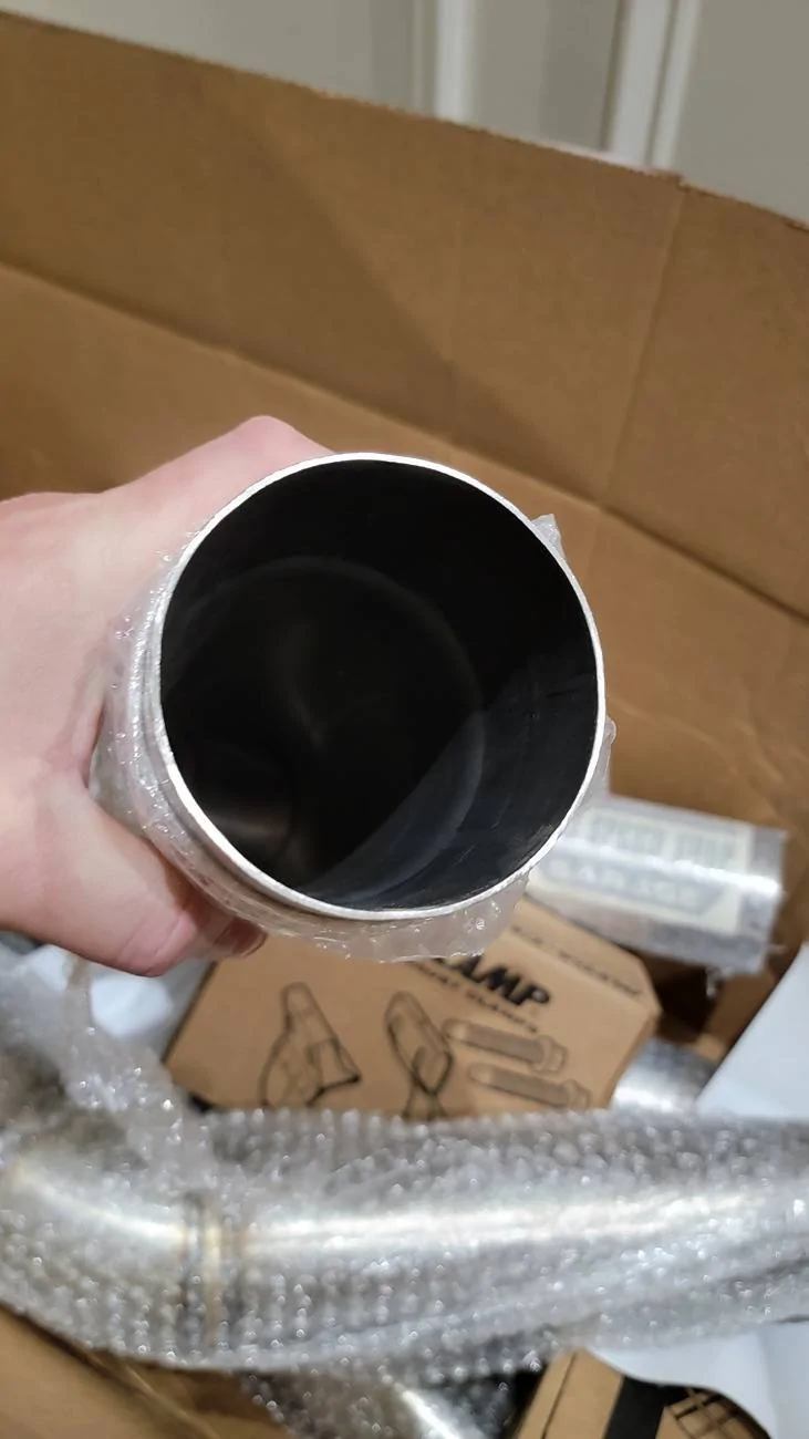

Purchase this about 3 months ago and just came in today got the downpipe and axle back. Shipping in one box. All pipes where bubble wrapped. Very nice welds and looking forwar to putting it and sending off my ecu for the new tune. Excited to see the difference between the GDE Stage 1 tune and the EOC Stage 2 Tune. More excited for the benefits that I will have from getting rid of the things that throttle the engine and throw back crap into the engine. I will be using the Trans Tune I have from GDE with the new tune. We just upgraded to 4:56 gears and with our current tune and banks throttle monster can definitely say all the issues we had previously are gone. It is very drivable even on huge inclines at very slow speed an issue we had before with our 37" tire size and weighing near 9000lbs. We still got 21mpg with the Gearing and are seeing more 8th gear now, better trans shifts as well. Pics of 3xhaust packed up and will update when installed. As well as feedback from tune. I'll do the axle back first then after Thanksgiving will put together the rest of it. We will have a cryptic video of it in the tube's @Gladiatoroverland when we are out wheeling. We won't really talk about what we did but will show how it performs.
