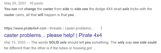

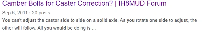

As has been discussed before - you can't change the caster split. To do so would mean literally twisting one end of the axle and not the other.
Think of it as a wood dowel. Take that dowel in both hands, one hand on each end of the dowel. Now tip the right end of the dowel back without moving the left end at all.
It can't be done. You can't change the caster on one side and not the other.
And since few seem to believe me in this - I got some backing from other sources.
