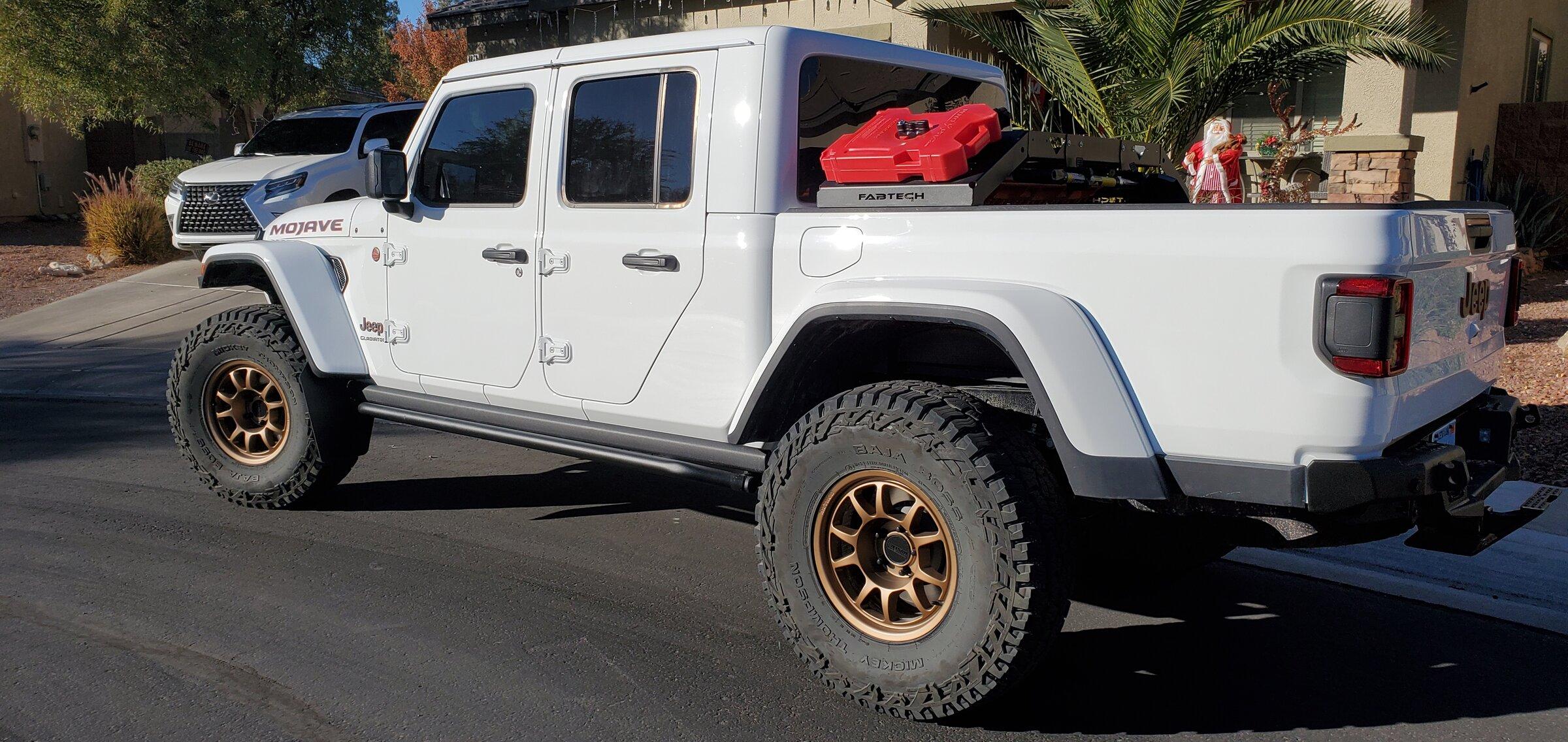

How long does it take for them to add? I haven't checked mine yet
those bronze rims are killer by the way, what are they brand wise?
