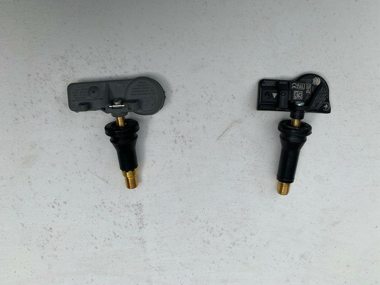

Do you recall what is said on the window sticker ? I haven't taken delivery yet, mine is in the shipping process, my order date was 10/21. Im asking because I need to purchase a set of TPMS sensors for an aftermarket set of wheels and I am not sure what part# I need. I thought the 06/2021 and newer called for part# 68339096AB ... but this shows its for the spare wheel and it does not have the STFA functionality in it.... my dilemma is ... I found a set from a private seller, stating they are take offs and they have the same part# as the spare wheel and they DO have the STFA functionality . So I'm still unclear if the 2022 models have this function and it just needs to be activated and does it matter if I use TPMS sensors with the functionality ??? I've attached a picture, the TPMS on the LEFT has the STFA function built in (notice the difference where the valve cap screws down.
Jeep Gladiator Tire Fill Alert added for a Sept 21' build date TPMS
The TPMS sensor has nothing to do with STFA. The sensor just reports what pressure it feels via RF. The STFA feature is a function of the BCM and instrument cluster. The reason there are different sensors is because before 6/1/21, the TPM module handled the signals from the sensors. After 6/1, the RF Hub is handling the signals from the sensors, and is looking for different IDs than the TPM was. The TPM module is still present, but only for canbus c connectivity. If you have a build after 6/1/21, then you must use the newer sensors regardless, or they won’t be read.
Thank you for the explanation... this makes sense and is why I was getting so confused, the seller of the TPMS made it sound like the difference in the stems on the two sensors I posted made a difference. You can see the difference below where the valve stem screws on.... but if I'm understanding you correctly, your saying this has no effect at all and it all about the type of sensor/frequency that attaches to the stem ??? So with this in mind, I'm guessing if his sensors were pulled from a vehicle that had the STFA function, then he most likely had a build prior to 06/21 ???
No, forget about STFA when referring to TPMS sensors, as there’s no relationship. If you have a build date after 6/1/21 (or it might be 6/7/21), you need sensor part number 68339096AB. If built before 6/7/21, you need sensor part number 68510382AA.
Thats the part# I had and the # he listed (xx96AB).... but in his listing he said
"brand new sensors that come on new Wranglers and Gladiators with the "Tire Fill Assist" option"
This is where all of my confusion came from... thanks for clearing it up !
