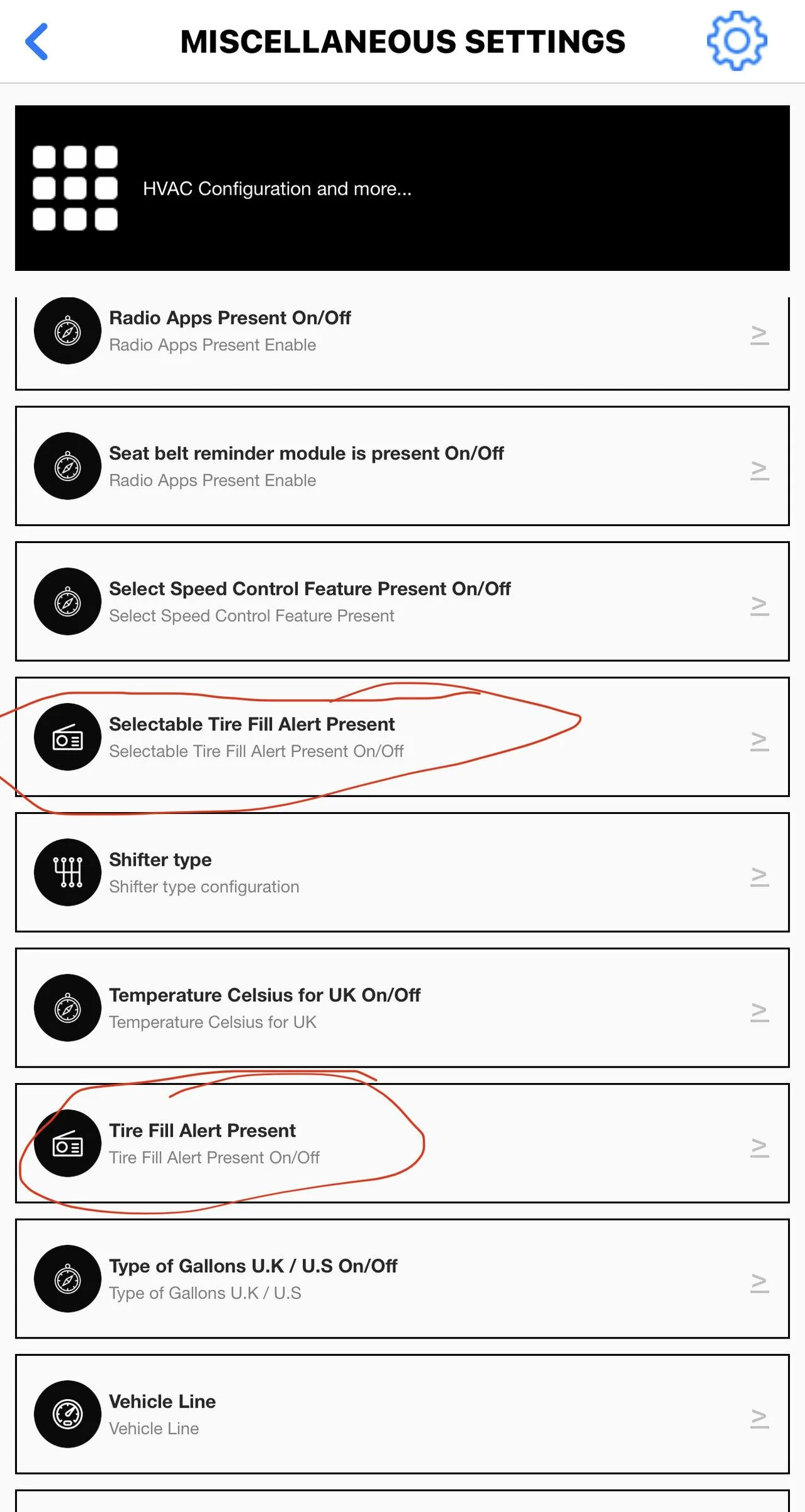

I took a peak at the demo mode of JSCAN, and it appears to be an option (assuming compatible hardware, I’d imagine):
Jeep Gladiator Tire Fill Alert added for a Sept 21' build date CF9E0A04-2D8C-4DB1-A85C-D79B15257839
I tried to enable this on mine with JSCAN... no dice. Not sure if I need to also enable/disable something else to make it work. I've reset ECU's, done the "power off, door open, door close, let sit" routine, still nothing.

There’s two different features that might be getting confused- Tire Fill Alert, and Selectable Tire Fill Assist. Tire file alert will just alert you when you are filling up low tires, and they have reached the required door placard pressure threshold. Selectable tire fill assist lets you configure for lower thresholds on the fronts and rears, and will alert you when deflating down from the normal placard pressures, and you reach those lower thresholds.
In Jscan, try enabling both of these (it appears by the icon next to the settings that they are both radio settings, but the selectable assist should be a vehicle configuration setting):
Jeep Gladiator Tire Fill Alert added for a Sept 21' build date 5C7240BD-24E8-4FD4-A393-A82A677E7F71

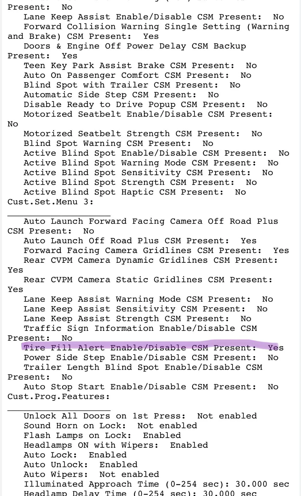

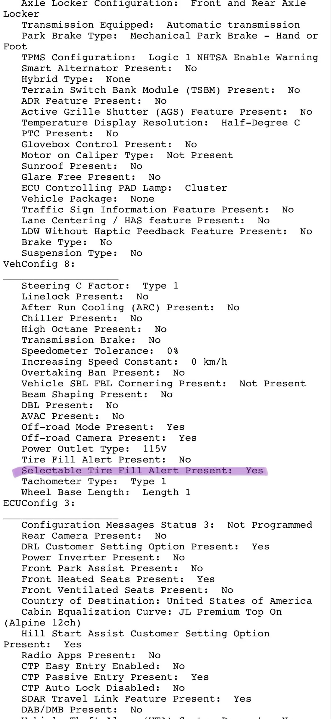

Otherwise, if that doesn’t work, you would need AlfaOBD to enable the feature, as it’s a far more powerful tool than Jscan or tazer. This is what the configuration looks like in the BCM of a 2020 rubicon using AlfaOBD:
Jeep Gladiator Tire Fill Alert added for a Sept 21' build date 507079C8-A4F1-457C-B17E-D9290C9AA386
Jeep Gladiator Tire Fill Alert added for a Sept 21' build date C5E92DF1-22FC-4FA7-80DC-1A6BC4143267
Or, if you’re missing the feature, and still under warranty, they will perform the TSB for free.

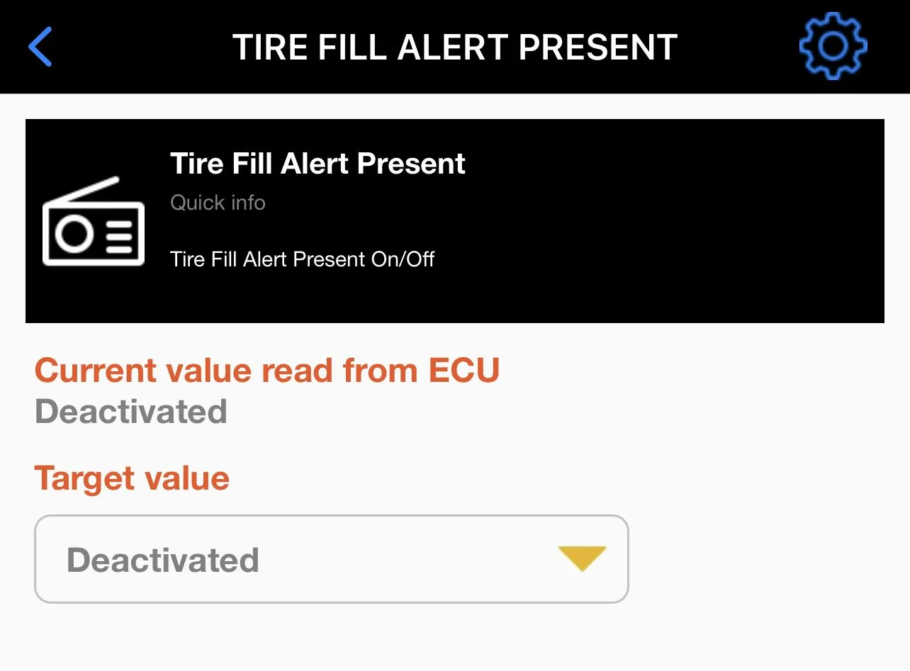

Appreciate it! I enabled both features on JSCAN with no change.
Never heard of alfaOBD, I need to check it out.
I reached out to the dealership and the sales guy seems to think they can enable it for me (I have a 2 day old 2022 JTR). I'll try that route first until they push back since my VIN won't be on the TSB list... but, STFA still appears in the 2022 owners manual so I might have a case

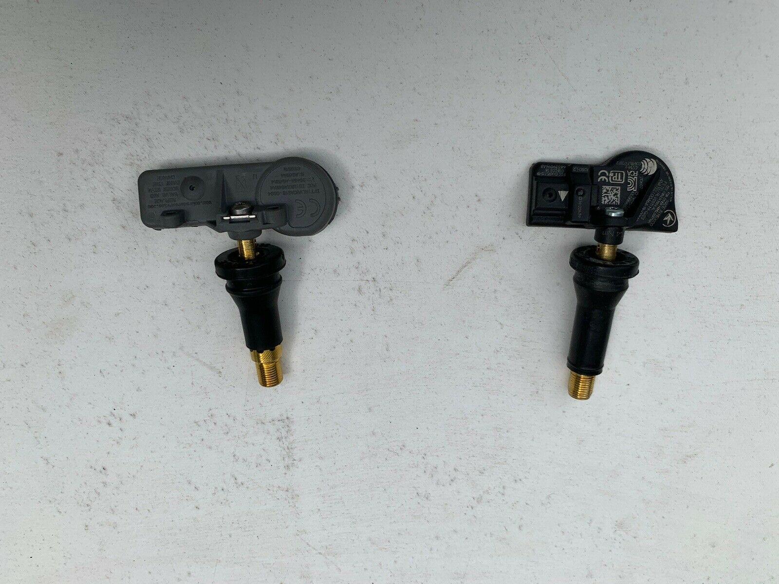

Do you recall what is said on the window sticker ? I haven't taken delivery yet, mine is in the shipping process, my order date was 10/21. Im asking because I need to purchase a set of TPMS sensors for an aftermarket set of wheels and I am not sure what part# I need. I thought the 06/2021 and newer called for part# 68339096AB ... but this shows its for the spare wheel and it does not have the STFA functionality in it.... my dilemma is ... I found a set from a private seller, stating they are take offs and they have the same part# as the spare wheel and they DO have the STFA functionality . So I'm still unclear if the 2022 models have this function and it just needs to be activated and does it matter if I use TPMS sensors with the functionality ??? I've attached a picture, the TPMS on the LEFT has the STFA function built in (notice the difference where the valve cap screws down.
