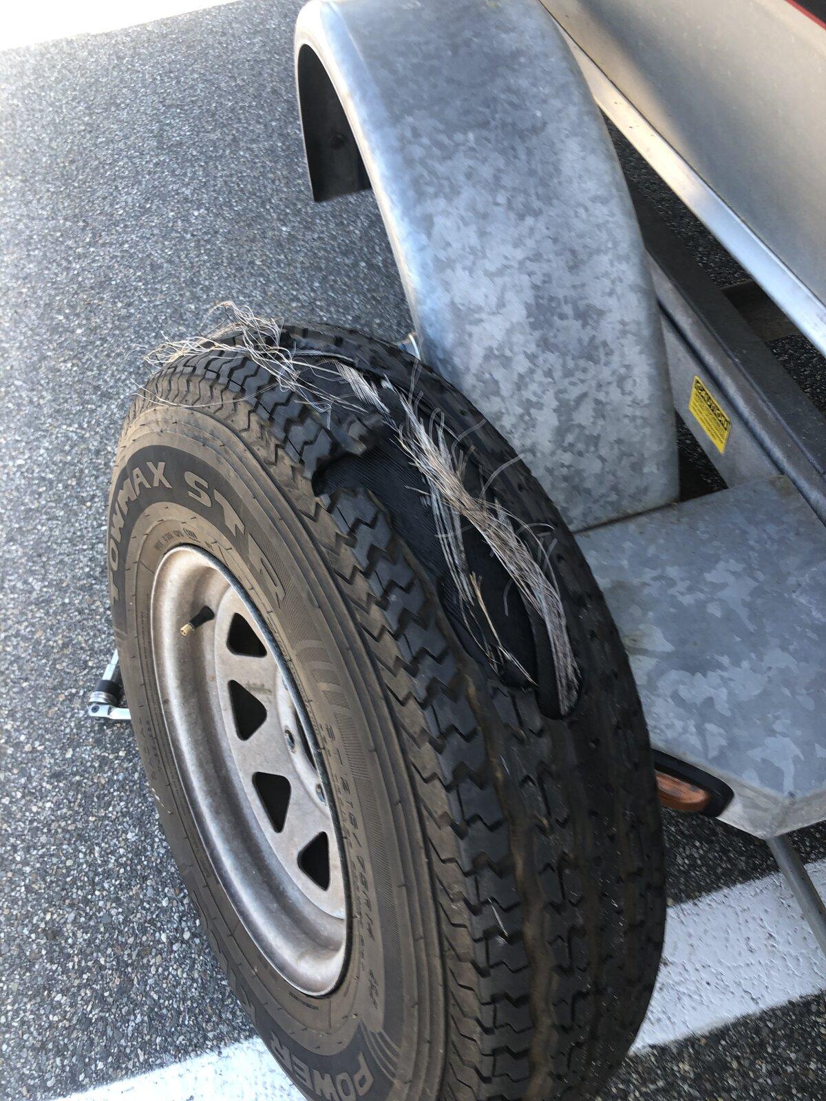

65-70 towing my boats, they are around 3500lbs handles it pretty well, last trip of about 120 miles I got 13.5mpg, had a tire lose it’s tread and had to change it, caught it before it blew, crazy vibration, was able to slow down and make it to the next exit.
I have had a blowout on a trailer tire on a single axle trailer wasn’t too bad just pulled over and changed it, didn’t get out of control or anything.

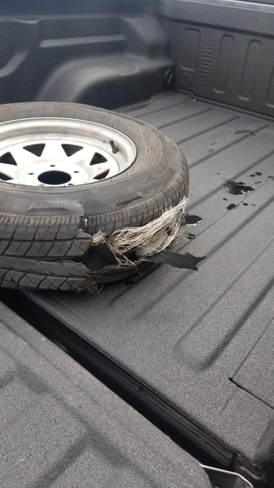

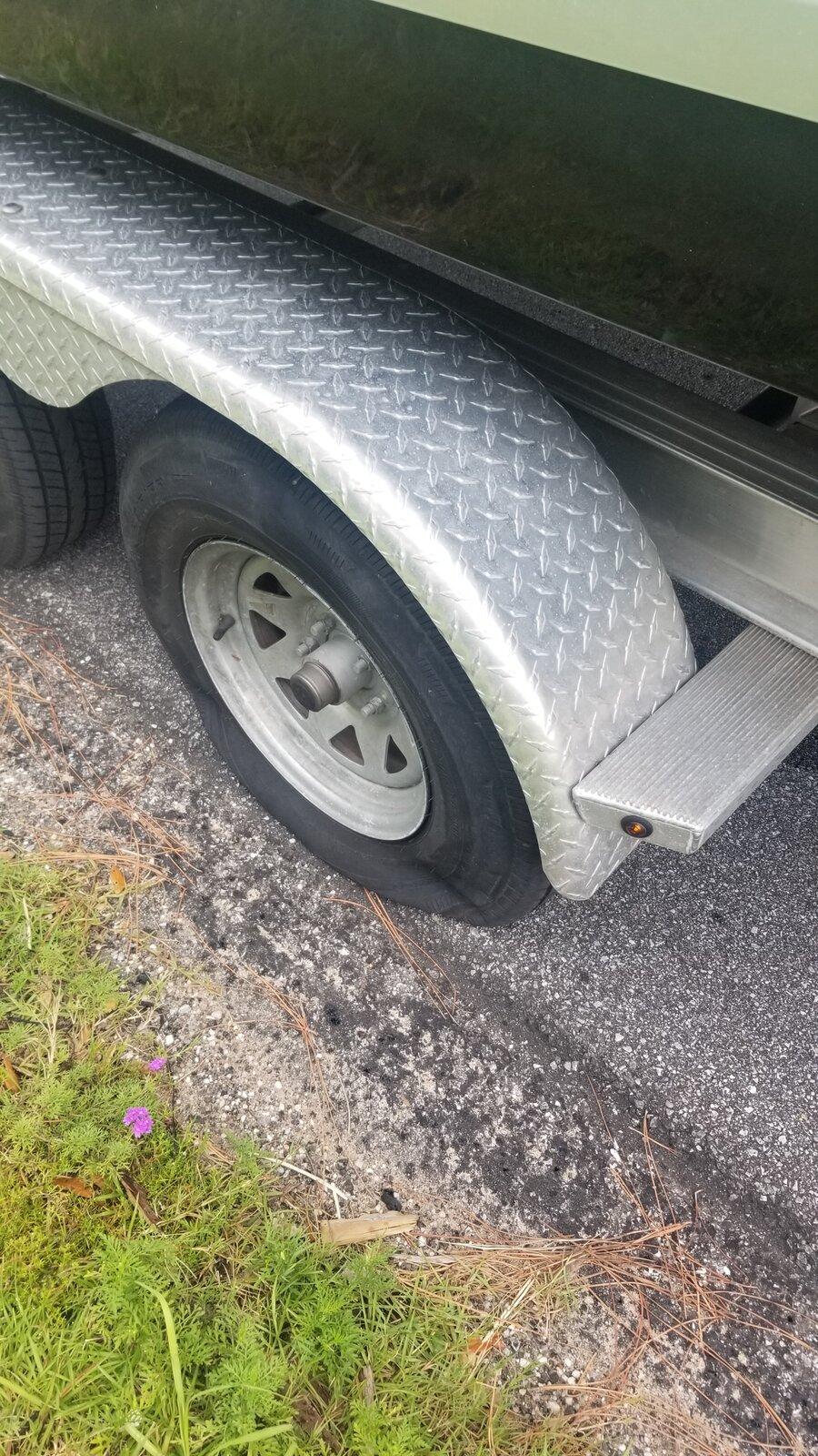

I must have jinxed myself when I replied to your post the other day.
I should have looked at your pic and kept scrolling. This afternoon towing my boat back from Florida the same thing happened to me. Definitely isn't fun changing trailer tires on the side of I-10.
As far as the rest of the trip, the gladiator did fine.

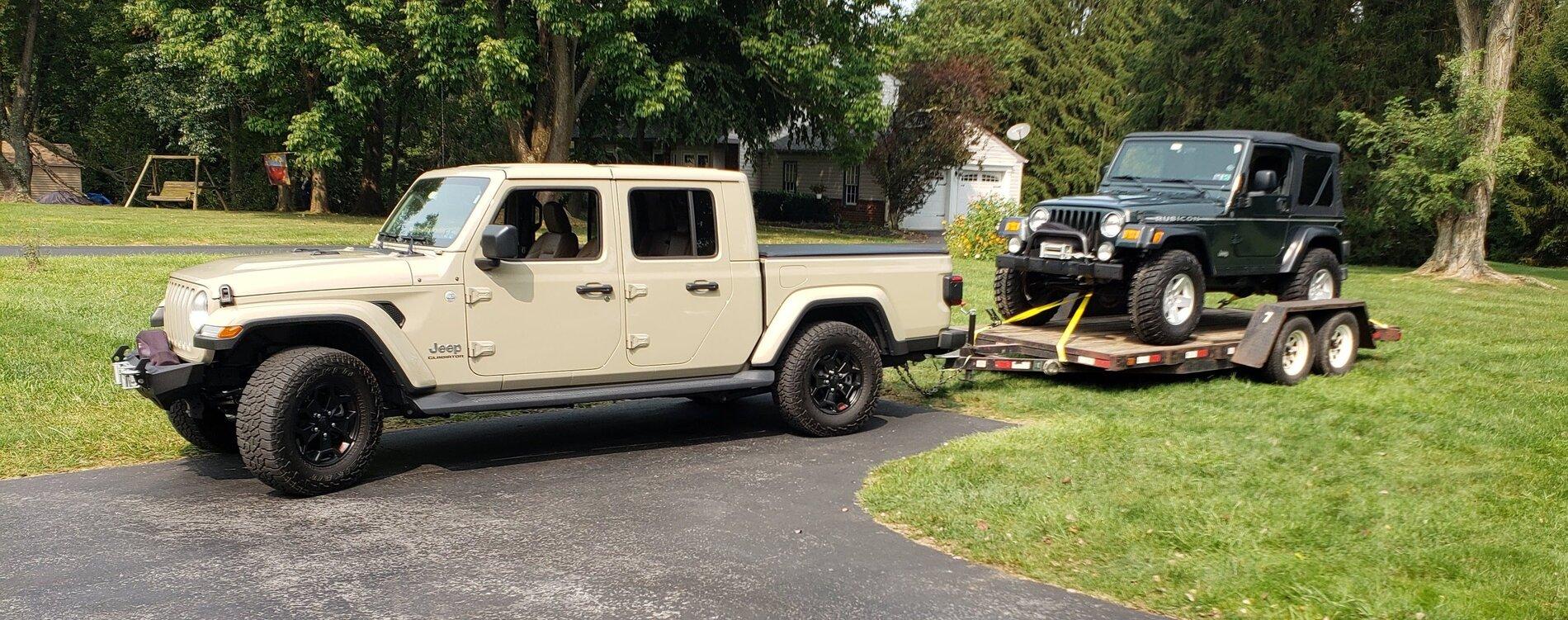

I wouldn't exceed 75 on flat straight highway this setup just for safety sake with my son in the car. Curvy hilly downhills in the Catskills kept it below 50-55.

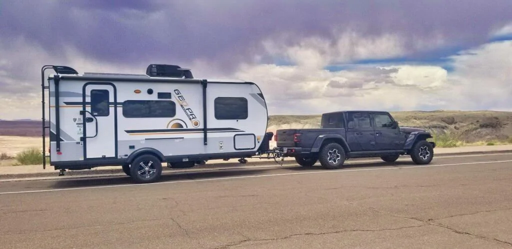

I top out at 65 mph. I'd rather be safe than sorry.
