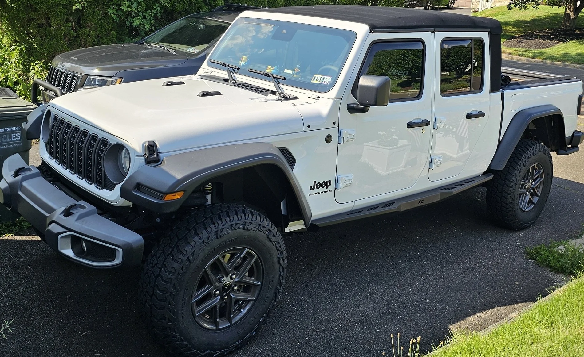

When I was searching for a Gladiator, I was looking at used at first. I'm building an overlanding rig so my first choice was a mojave. The more research I did I realized a sport s with max tow was the way to go. The sport s has higher payload and tow ratings. Though the diesel is great for towing the weight of the engine reduces payload ratings. It was hard for me to find a used one with what I wanted so ended up buying a 2024 leftover for 15% off sticker price. I wanted the 41 color but ended up with white. I added mopar 2 inch lift and skinny 35 inch tires and am very happy with it.
Jeep Gladiator Weighing the options 20250730_160258
