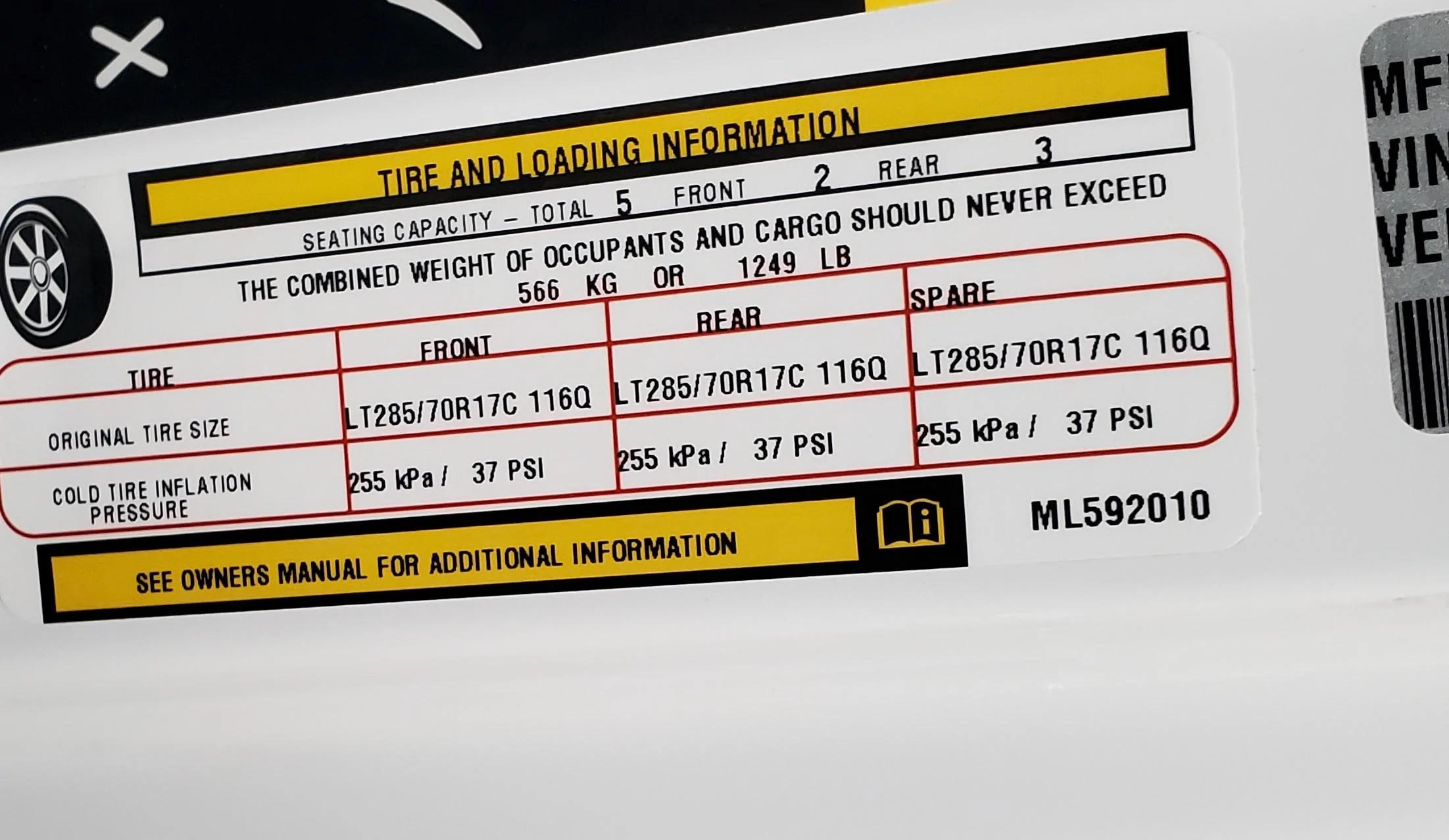

Ok so I am confused, but not starting trouble, I understand you can not increase payload with suspension changes. I understand the stickers on my 2021 gas /auto Mojave, to be Gvwr of 6140lbs. and payload of 1129 lbs. I know payload does not include 150lbs. of my weight but fuel and everything else counts as payload. I understand that “perhaps” changing to lighter tires and rims does not increase your payload, but driving across a scale it does decrease you GVW, so should increase payload as they check it on a scale…ok more to this look at your door GVW rating sticker it lists total weight then list front and rear axle GVWR BUT clearly says WITH these rims, these ties and at this tire pressure. So in conclusion my Mojave going across a scales has a suspension system holding the weight and the axles , tires, rims and part of the driveshaft weights are unsparing weight …not really payload. Wait another big but, when the scale people check your weight with the scale under each tire do they really look at the sticker and flunk you if you have lighter wheels and rims.

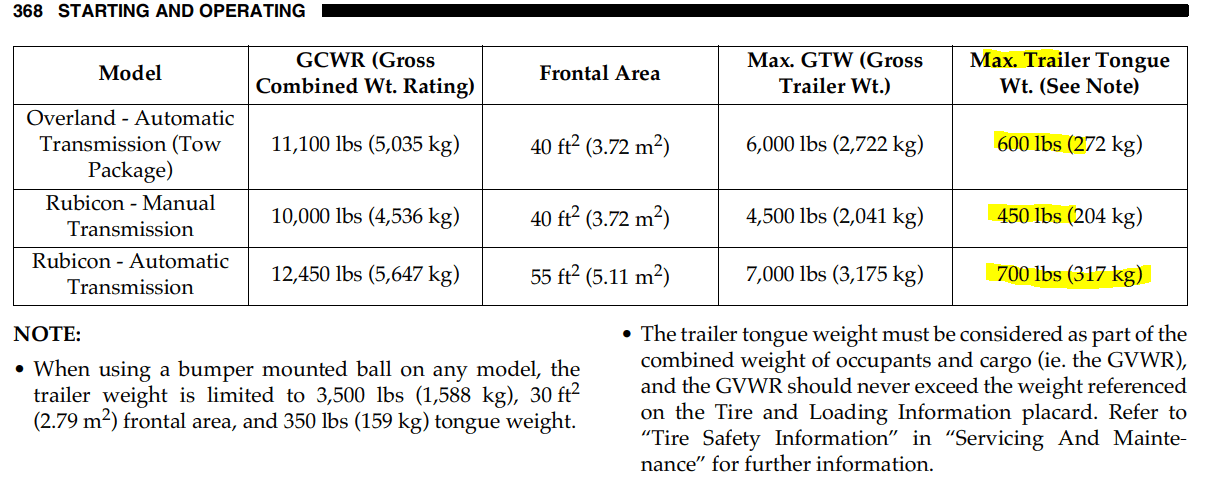

Payload still matters. If you had a 5,000 pound trailer, it is advisable to make sure you have 15-25 percent of the weight as tongue weight. Using 20% as a guide, that would be 1,000 pounds. So - in theory, with my Gladiator, empty (meaning not even me in it) I could not haul that 5,000 pound trailer 'legally'. now if I wanted to risk the 15% rule, then it would be 750 pounds tongue weight. With me in it, that maxes out my GVW. Meaning I could 'legally' tow, with literally nothing else and nobody else in the vehicle. A lot of people don't consider this. And maybe in 'function' it doesn't have a huge impact. but in the event someone ignores this, is carrying 800 pounds of people, water, and gear, PLUS towing a 5,000 pound trailer, and if they are in an accident - the insurance company could very likely place them 100% at fault and liable for any and all costs associated. Some states are actually VERY picky about that. I recently moved away from one of them. So it is something serious to pay attention to.

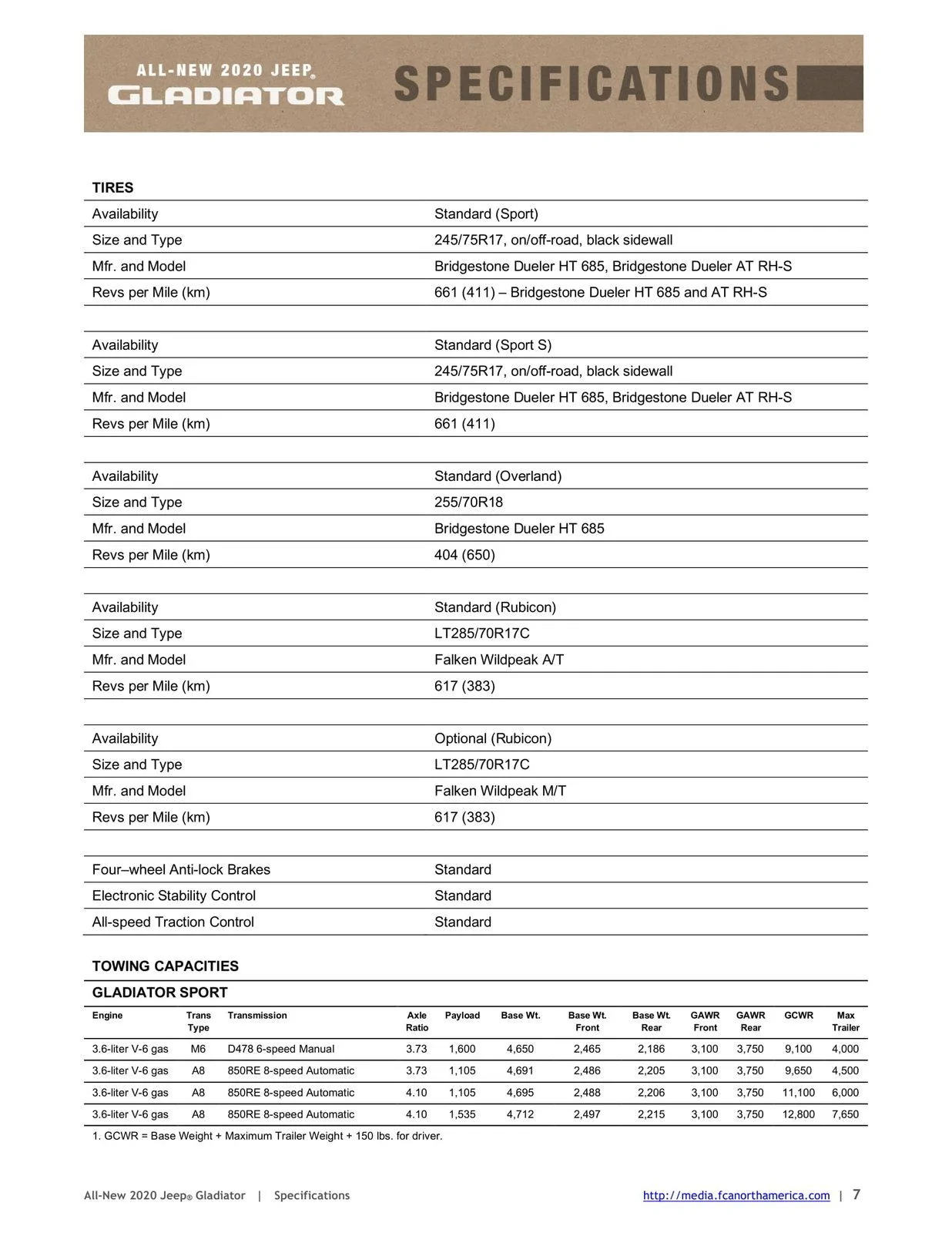

I do have one last question, I have not found in any of my manuals where it says payload is based on 150LB driver, Other makes and models have done that in the past and I think we assume that's the case here but I haven't seen it anywhere. Would be nice if it were true....
JJ
I cited it in one of my early threads. It is in the manual and in one of Jeep's spec sheets. Will try to find it
ETA: found it. But may no lomger be official and Jeep may have removed it?
Ok, I found the 150lb allowance! It's on Jeep's website. Go to the Gladiator, scroll down to where you can look at the different packages, "Make the Gladiator Your Own" section, and choose the Max Tow Package. Where it says "Gross Vehicle Weight Rating( Disclosure17)—6,250 Pounds" you hit the 17 and it pops up saying "Assumes properly equipped vehicle and 150 lb allowance for driver. Additional options, equipment, passengers, and cargo must be subtracted" Will email Jeep on clarifying, because if that's the case then my max payload is (6250+150)-4672 (curb weight given to me by Jeep) = 1728lbs. However, the Tire and Loading Information on the door frame says Max Payload of 1544lbs
I may actually go to a weigh station and weigh my jeep as it is (nothing has been added yet). Because we're talking almost 200lbs of payload difference. Emailing Jeep today
I found another instance of the driver weight allotment. See at the bottom: GCVWR = Base Weight + Gross Trailer Weight + 150lbs for Driver
Whew, I hope that was a typo. No way. 10% as a general rule, up to 15% for some trailers. No more.
I tow a 5,000 load and 10% is the recommended tongue weight from the manufacturer of the trailer. If I recall, 15 is for lighter trailers, 10 for heavier trailers.
That much tongue weight would break things and I don't know of any receiver on a JT that will handle that weight.

Dumb luck for me on payload. Didn't think too much about it because I mostly wanted a manual. But the manual JTR seems to do pretty well with a #1249 payload rating. I swapped the rock sliders out for tubular side steps. Those sliders are heavy steel. I think both tubes weigh less than a single slider. So maybe I gained a little more capacity there, which will make up for potentially adding a bumper/winch (I already have a wench). Post holiday salads should help as well. But nice knowing that even with #450 tongue weight from a trailer there is decent payload capacity remaining.
