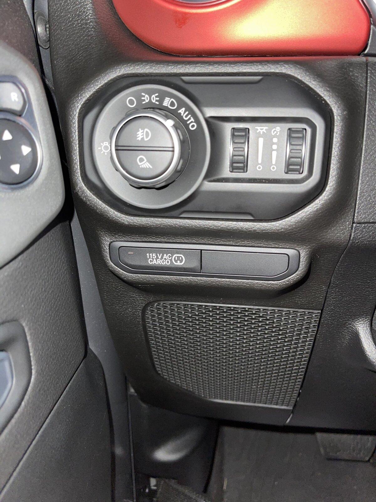

Installed the bed power outlet and switch. The bed outlet install was fake, harness for it is a pain because you have limited access. The button that goes under the headlight switch was a nightmare. Had 3/4 of the dash apart to change it. Wish I had known it had to be ripped that far down I would have upgraded the speakers while Everything was out.

Is there a switch available for the space on the right?
Not that I know of. All I know is, what a pain in the ass install it was. Was gonna do a how to thread but I didn’t get started till 930pm and didn’t get done till 11 so I didn’t take the time to take pics.

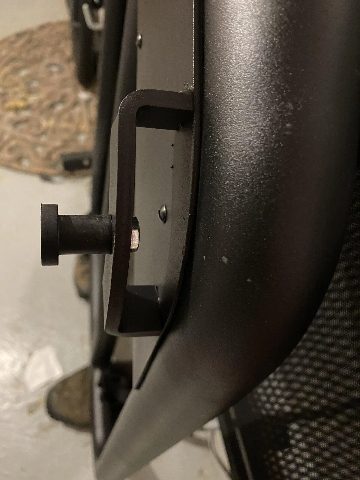

Took the doors off for the first time, mounted holders in the garage and installed new rugged ridge tube doors/covers... just in time for a Colorado mountain rainstorm. Couldn’t drive with the tube doors, tomorrow I guess!
I have those doors. I had trouble with the passenger side door rattling because the rubber bumper wasn't long enough and I could not adjust the rattle out of it.
I went to ACE hardware and spent $1.99 on a threaded rubber insert and a 3/4" long, 1/4x20 screw. Replaced the bumper and voila!
