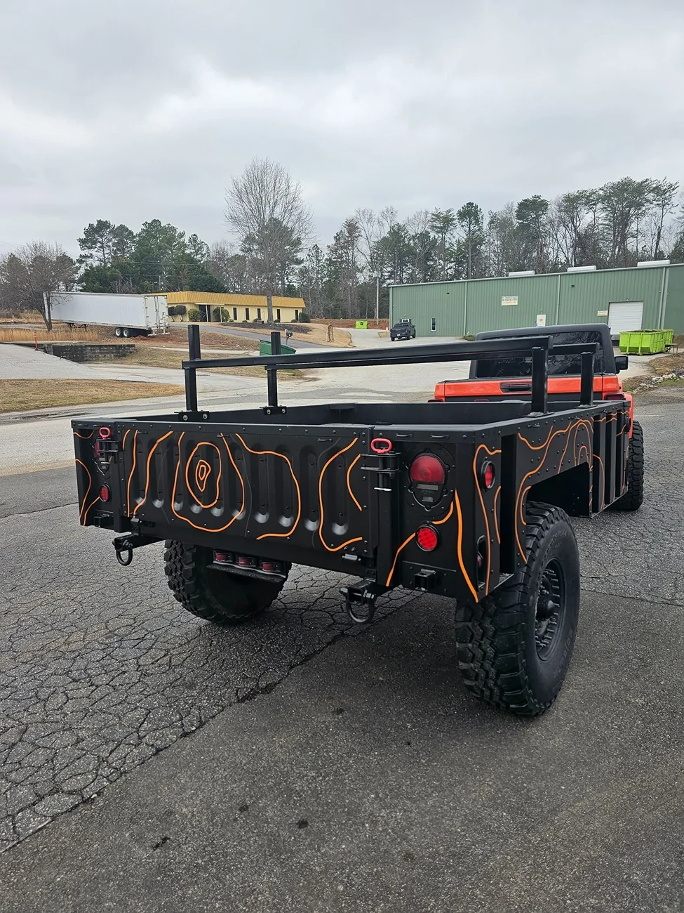

2021 Gladiator Rubicon
Network Engineer

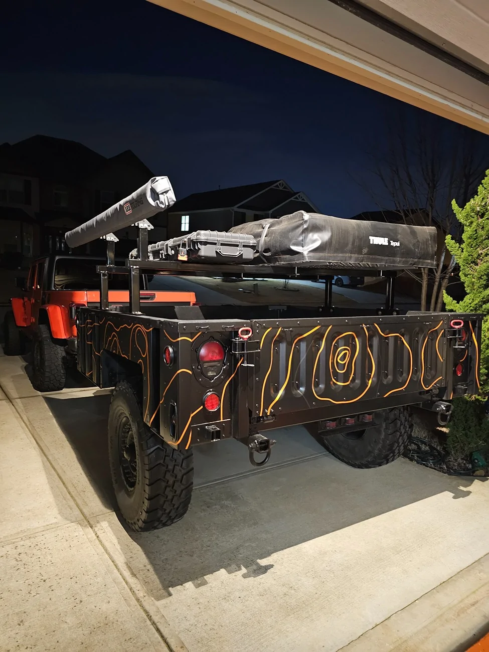

Used it to go pick up my tent rack from powdercoat and then bring the trailer home to start putting it back together for camping next weekend.
Single coolest RTT trailer I’ve seen. Not even close.

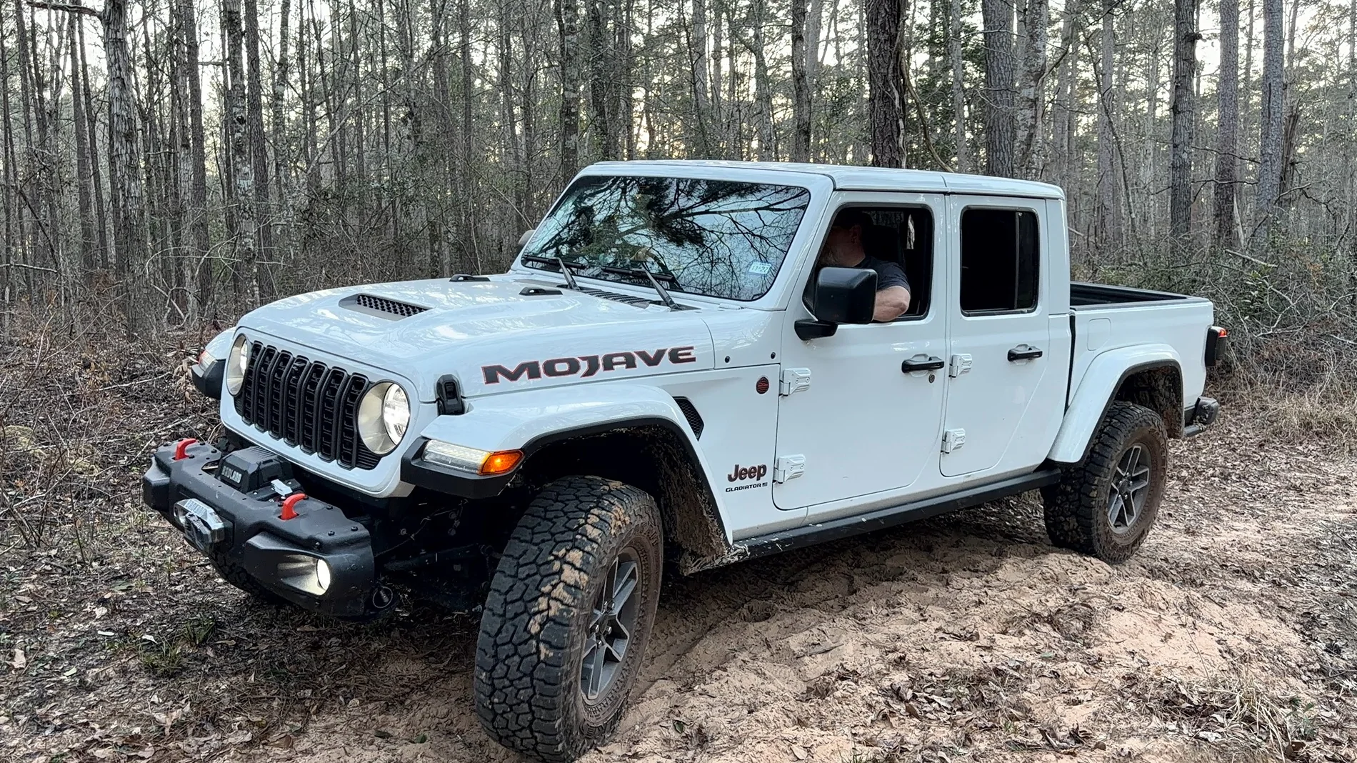

GeekJT
Brian
Nov 10, 2025
232
333
Houston
2025 Jeep Gladiator Mojave X, 2024 Mustang GT 5.0
Investor Relations Marketing & Funding
Did some South East Texas (North of Houston) Forest trail riding and clearing yesterday. Just doin our part to keep the trails clear. :like:
