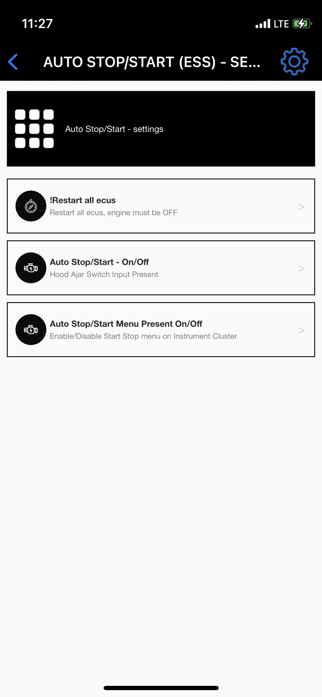

I used my Jscan to turn off the ESS last night but driving to work this morning it still went off. Anyone else experience this?
You can’t disable ESS with JScan (or AlfaOBD).

If you feel strongly enough about it, there's a circuit you can buy or make (pretty cheaply, too) that is a timer you install behind the switch in the dash. Once you start your truck, it sends a signal to the system that the switch/button has been pressed.
But it can't be done with any plain software because the code prevents that.
I'd do the timer and not mess with the switches under the hood. For one thing, that timer is not detectable or seen once you put it in place and it has no impact on anything at all the dealer may do. It's not traceable unless someone pulls your dash apart.

It honestly doesn’t bother me that much but if it was a simple operation through Jscan I was going to try that out. No big deal.
40,496
54,007
Gotcha. Enjoy the truck!

What name does one use to search for information on where to buy or build this circuit you talk of?
