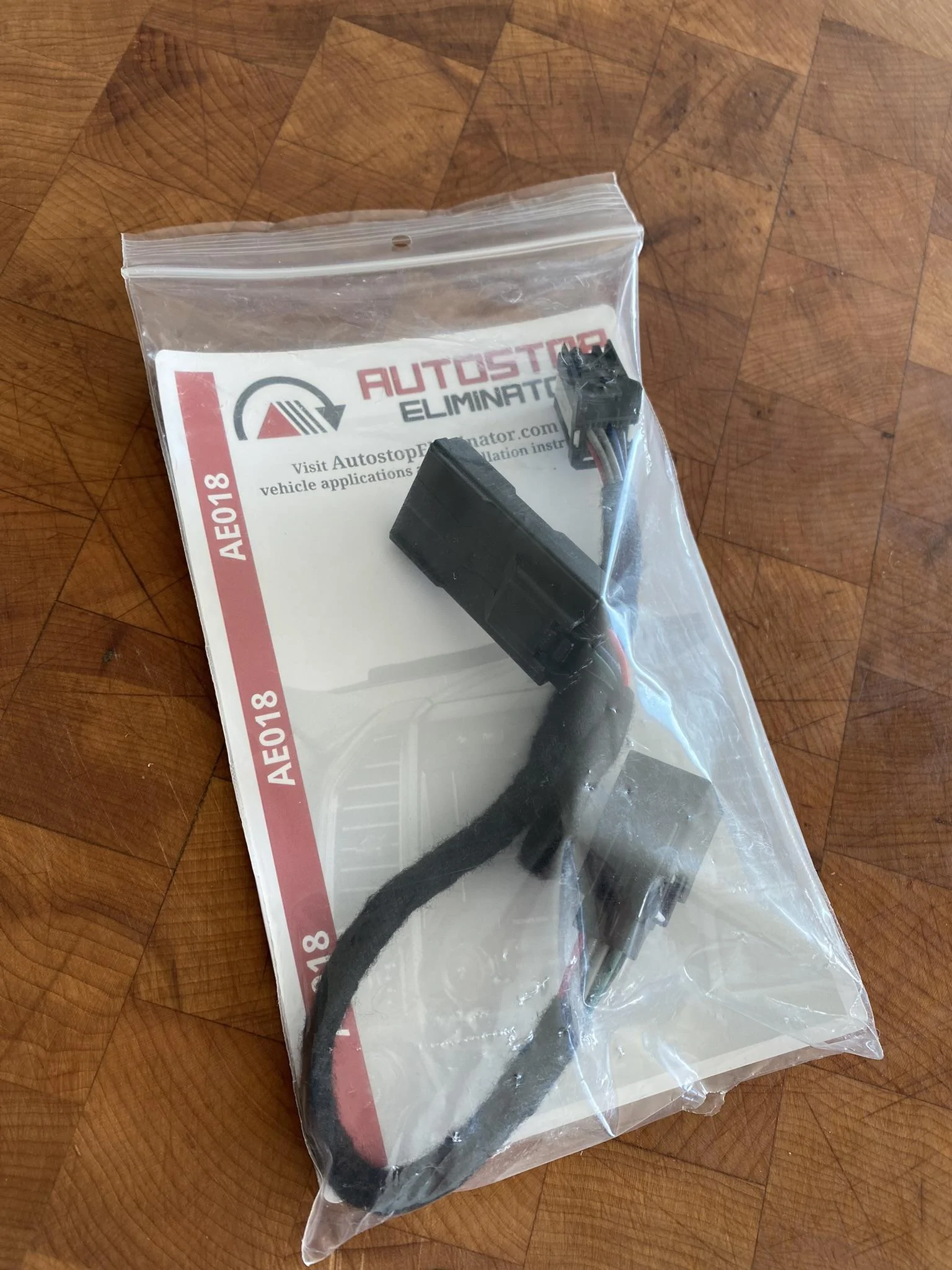

What name does one use to search for information on where to buy or build this circuit you talk of?
I have Start Stop Eliminator for sale. Worked great, but now I have a Tazer and don’t need it. $80 shipped to lower 48…
