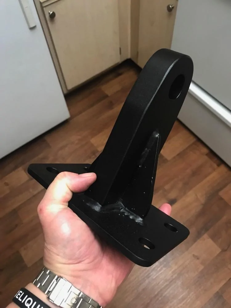

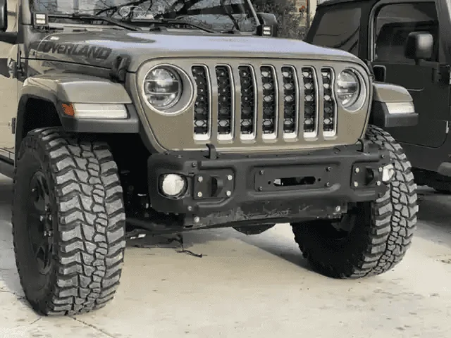

I'll second this one. After installing Poison Spyder bumpers on my two JKUR's and just slapping winches on the top of them, I decided to go the "hidden" winch route on my Gladiator with the stock steel bumper. As if the clearances (and by that I mean the room needed to access bolts, etc.) weren't bad enough, I complicated it with these:
I hate that the stock steel bumper only has the hooks and not the shackle mounts, so I found a company in Canadia that made these. But then that meant I had to grind off the crush cans behind the bumper, cut holes in the plastic fascia for them to come through...AND...they are a lot of steel and heavy and use up that minimal clearance all that much more.
It turned out good but if I were to do it all over again, I would have replaced the stock steel bumper with one that is easier to install a winch onto.

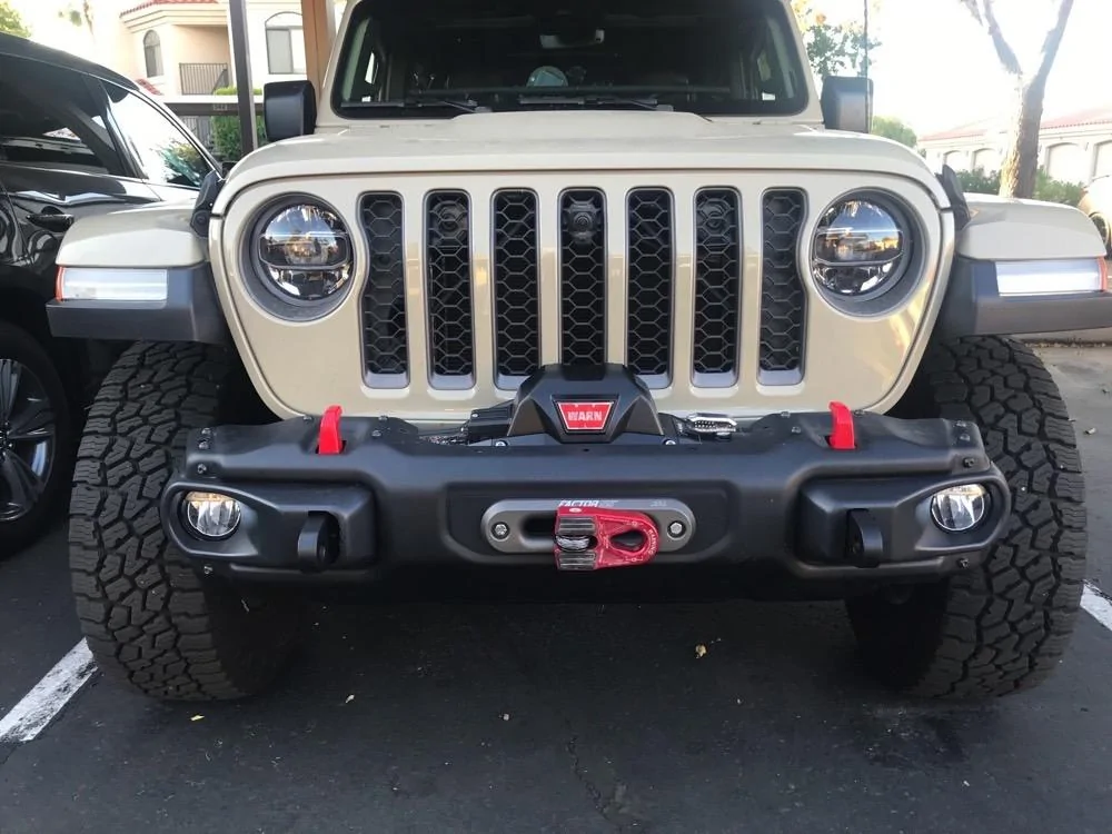

A little easier going this route...
