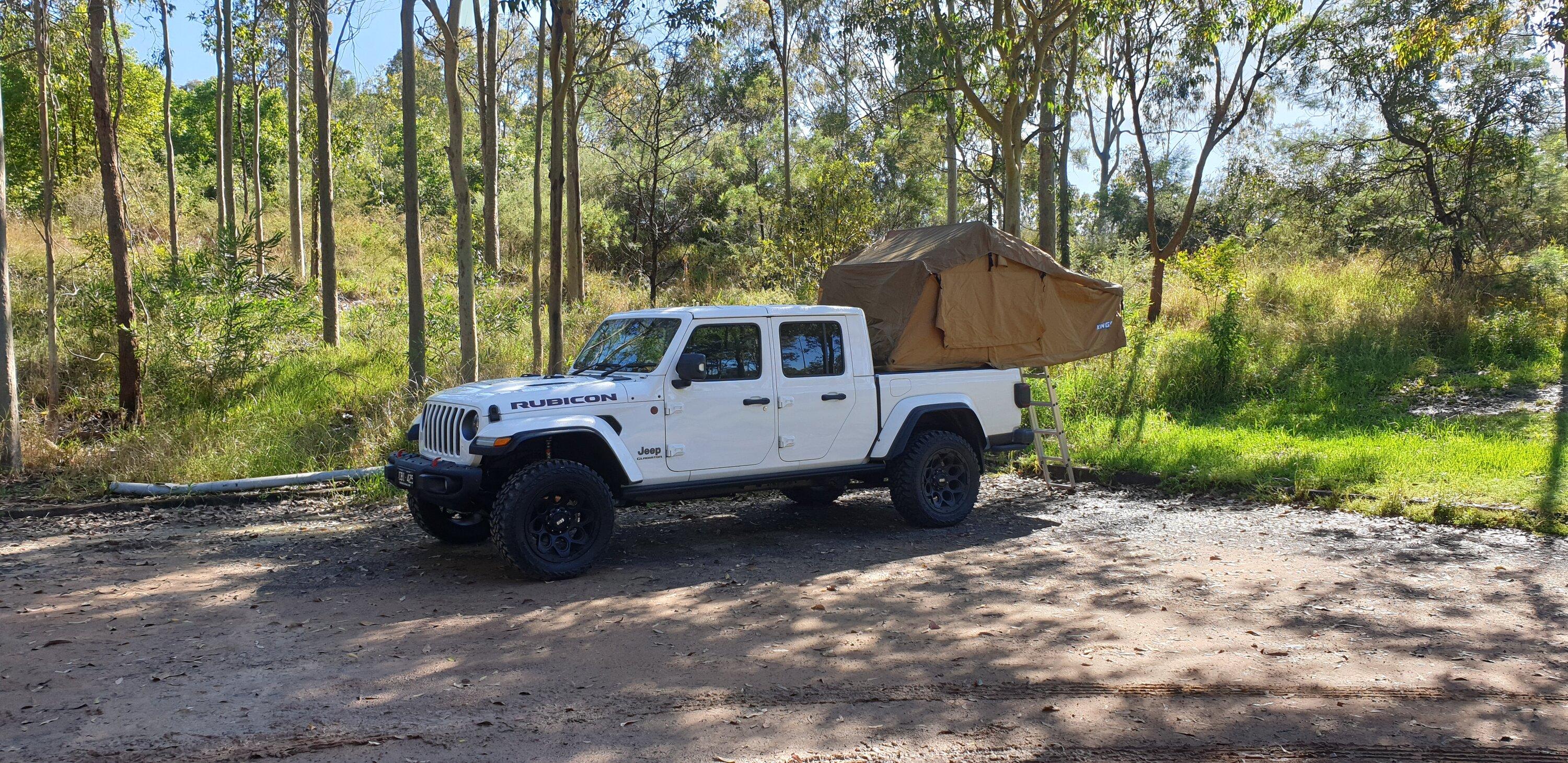

Hi, I'm new to the Jeep owners crew. I have a Gladiator that I purchased off the showroom floor 1 week ago.
I have just completed a 3,000km working trip in the last 6 days and the instant mpg display dissapeared on the last day whilst travelling 900km back home.
I refueled the car a few times and it hasn't come back after stopping and restarting vehicle. I haven't tried resetting anything.
Just a little bit annoyed.
I use Android Auto for navigation throughout the whole trip.
