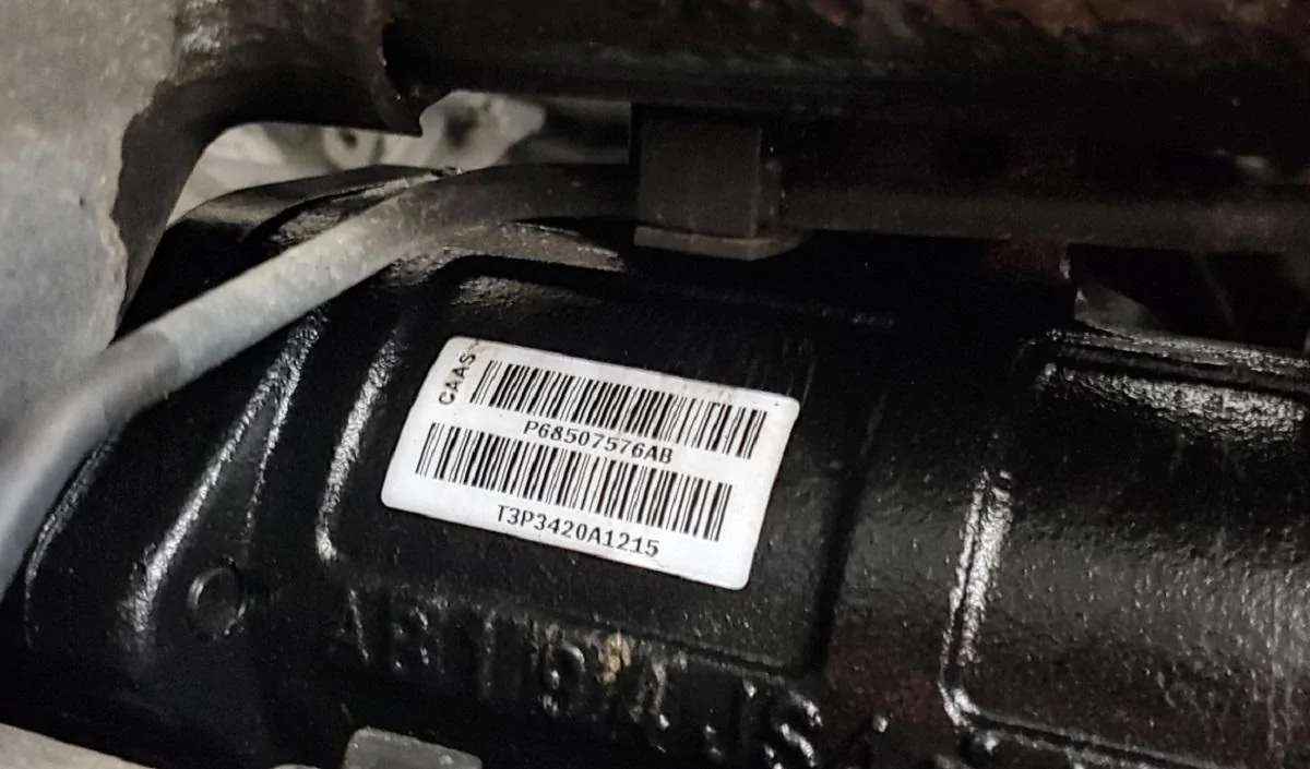

Stupid question here - Its friday, and Ive already begun drinkng - Does anyone know how to check this? I have a 2021 model and was told by the dealership that it was not effected by the steering box shenanigans and have been operating under the assumption that it had the newer version installed.
If any of you have photos of a part number label / location something along those lines so I can check I would appreciate it. Be curious to see what Ive been working with.
My steering is generally pretty good, although I do have a pull to the right - Im pretty used to it, and I have a ton of stupid modifications - lift kit, track bar, steering stabilizer, etc so I just assumed that was my fault.
the steel box is black the aluminum is well, alumunum kinda grey

As mentioned, black is the iron one, silver is the older aluminum.
And yea, 2021s were effected so they lied to you on that one.
40,514
54,043
This is the replacement - the part number may end in AA instead of AB if it's an earlier replacement.
And as said - original 2020 would be aluminum gray/silver, replacement is black.
