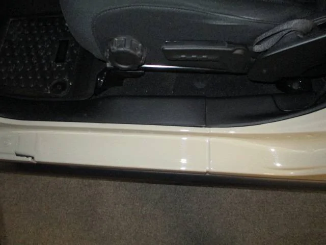

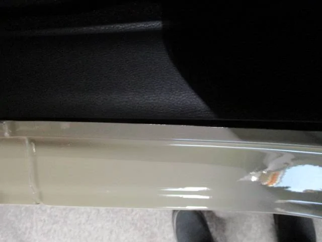

The weather stripping on my front doors, on the bottom front of both the driver and passenger doors, do not have a tight seal.
I just wondered if has anyone else noticed this?

That was my problem. Bought a set of after-market door sill guards and the front leaked when washed or got rained on. I took them off and put clear vinyl sill guard on it, leaking stopped. It is also virtually invisible, you can't see them. Looks good and works.
