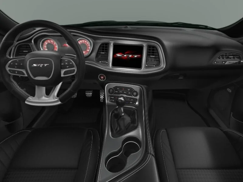

What manual is in the hellcat? We want that one! And the engine too ?
Ha Ha ha. Its an auto Trans in the hellcat.
And . . . its just a beefier version of the AT in the Jeep. The ZF 8HP.
NachoRuby
Chad
Apr 28, 2021
2,992
4,428
Pennsylvania
Challenger Hellcats are available with a manual transmission... They always have been. It's a Tremec TR-6060. But don't just take my word for it. Go build one on dodge.com.
https://www.dodge.com/bmo.challenge...2DR/PAE,X9,ESD,DEC,TW8,WEB,AF,APA,UAS,25R,3EJ
You might be thinking of the charger version, but most versions of v8 challenger, including the hellcat, can be had with three pedals.
