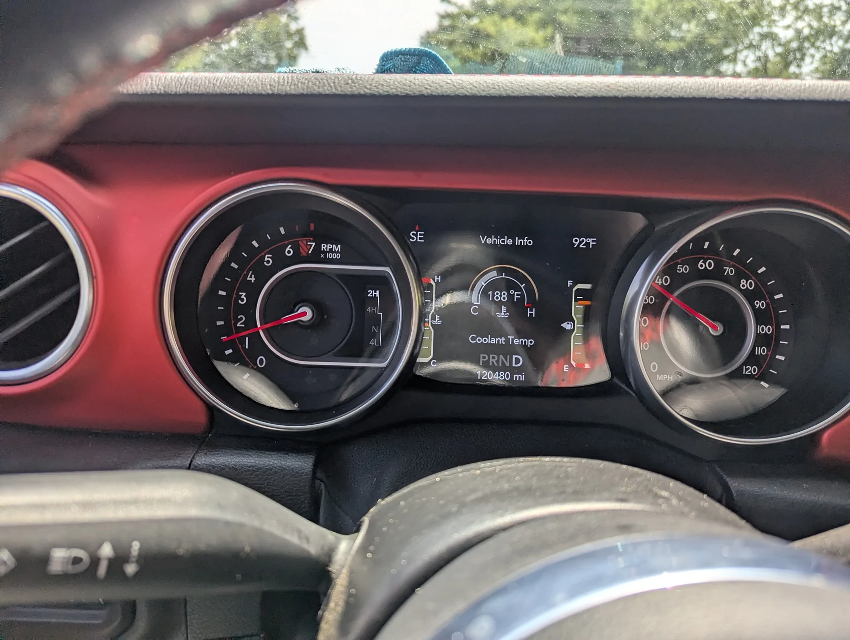

Driving around town in 92 degrees.
Jeep Gladiator Why Such A Hot Thermostat? 92 degrees dash

There is absolutely nothing wrong with going to a 190 thermostat. That isn’t even cold enough for the ECU to throw the p0128 thermostat code. It’s simply allowing the cooling system to start working sooner and at sustained loads IE turbo loading/going up a long hill are still going to bring the coolant temp north of 200.
People are getting their panties in a bunch over this for no reason. Your truck doesn’t have to run at 220 constantly to get all the moisture out of the engine.
Some facts instead of feelings now - Most Ford and GM applications use a 190, 192, or 195 thermostat to this day. Some of the most legendary reliable diesel engines IE the 5.9 Cummins used 190 degree thermostats. The modern 6.7 Cummins uses either a 190 or 195 thermostat. Marine variants use even lower. I owned a few different Ford Ecoboost vehicles with an aftermarket 170 degree thermostat swapped to each, one of which was a 600 horsepower F150 that could do 12 seconds in the quarter mile. No issues at all and cruise temps were still usually 190-195.
It’s for emissions reasons mostly. That’s it. Implying that there is imminent doom because of a 190 thermostat is hilarious.
OP that was a solid choice especially if you’ve already done other things to help out that 3.0 😎

Haven’t verified this on the EcoDiesel, admittedly. But on the gasser that threshold is around 180 degrees, which I have verified on those. Other manufacturers I have worked on seem to have that check engine light for coolant operating temp set around 20-25 degrees below regulated thermostat temperature. So, in that sense, if factory is 205 on the EcoDiesel, OP might be right on the edge. But if he’s already deleted, his tuner can disable that code with one click.

Personally, on my own vehicles, I’ve only ever put a colder thermostat on if tuned/deleted/heavily modified. That’s probably what I would recommend to someone who is not deleted. I’m sure a high tech modern small diesel probably has pretty sensitive thresholds for this. In my area there are almost zero Ecodiesels so I’m not sure I’ll ever be able to confirm.
But in OP’s case I’d say he will be fine with a 190. That’s still pretty warm for a aftermarket thermostat generally speaking.

I find it best not to conflate a thermostat change with "better cooling". It doesn't actually increase your cooling capability, it just delays the temperature rise.
